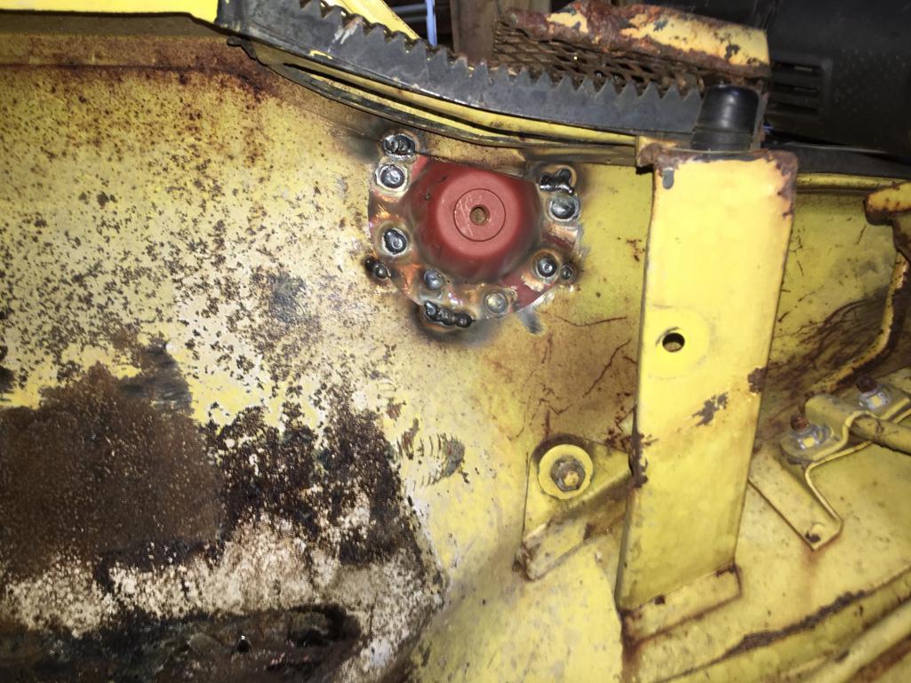

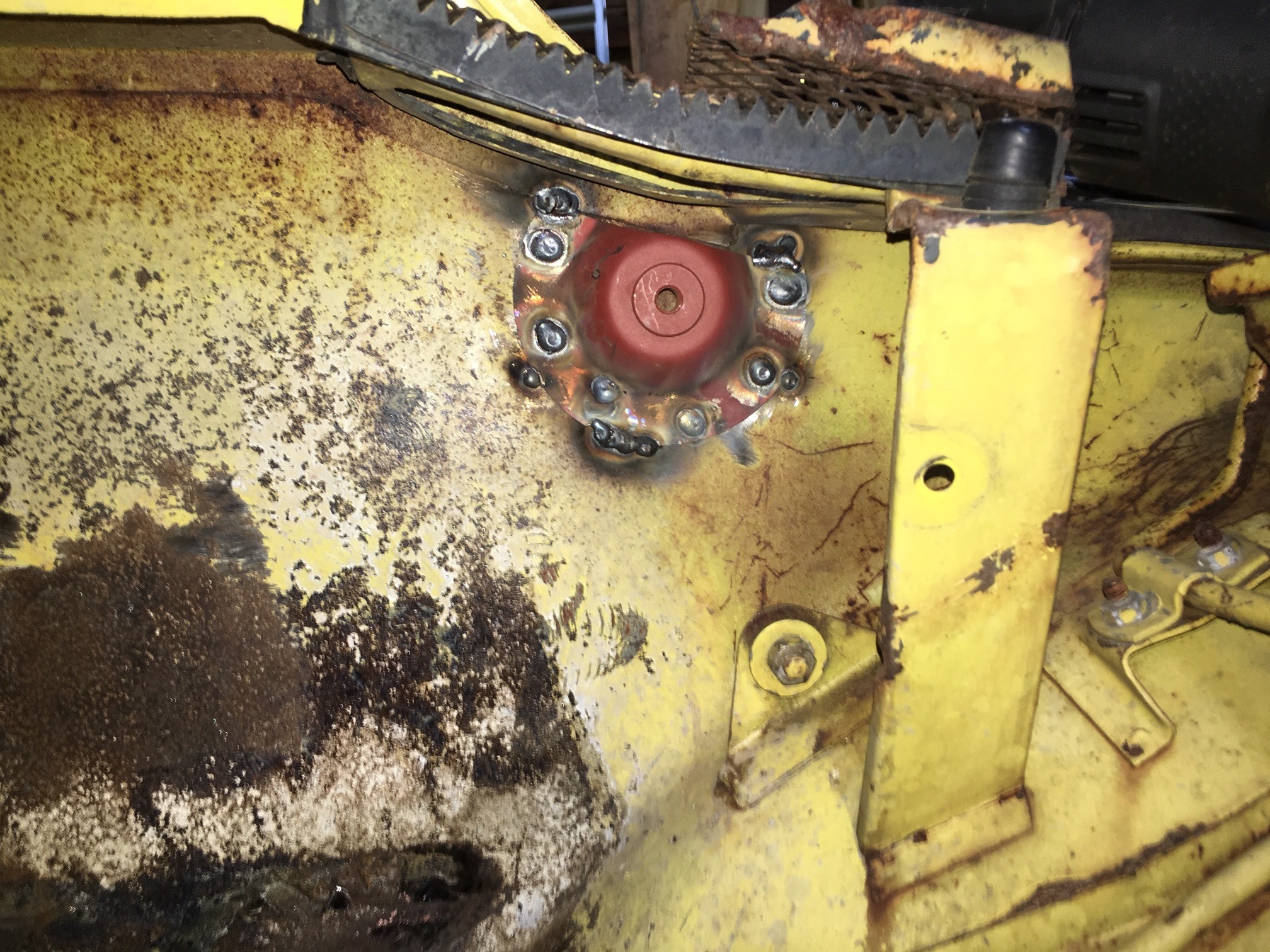

I also welded in the new trunk hinges. (IMG:style_emoticons/default/welder.gif)
