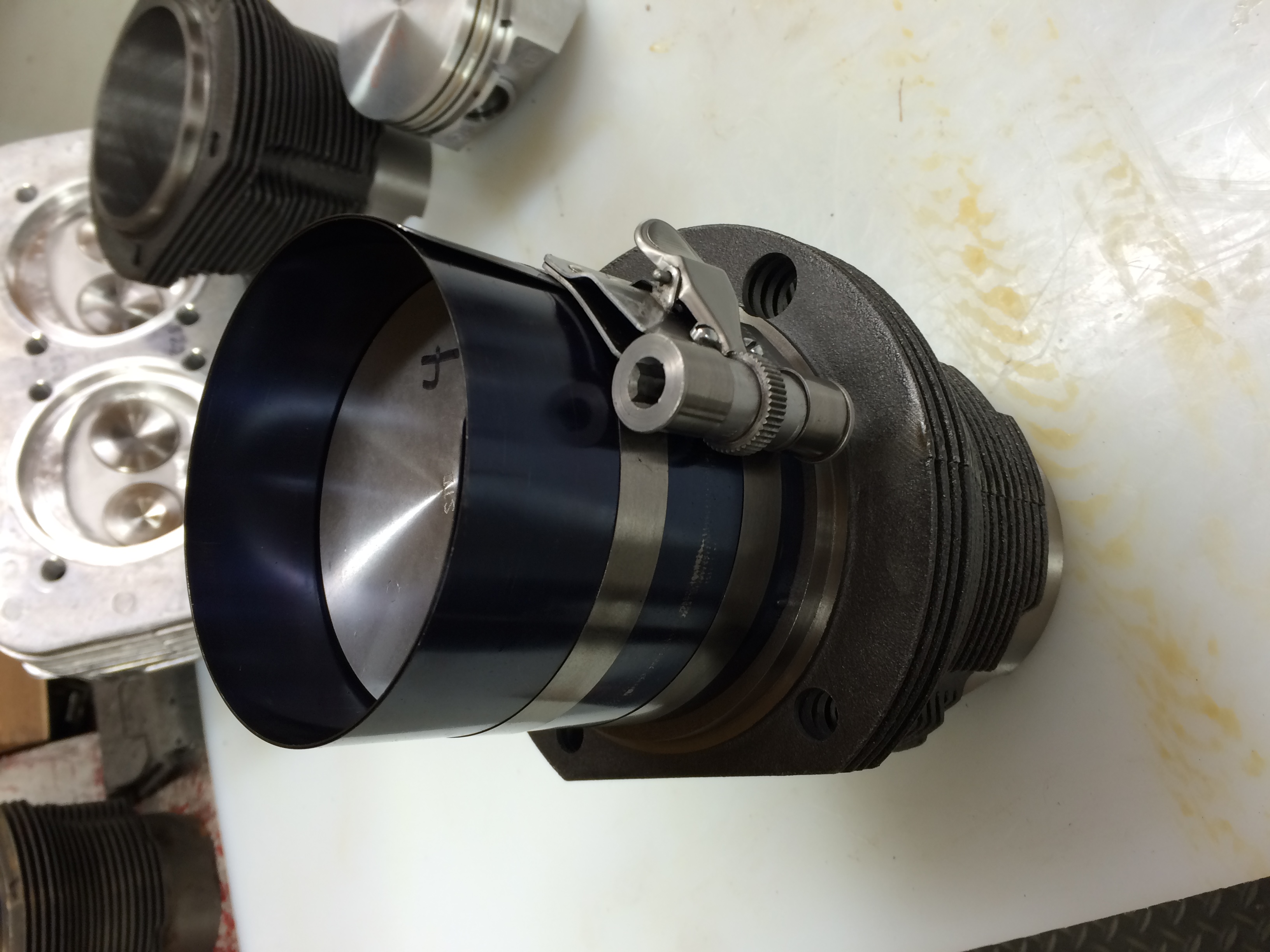

Checking ring end gap ...
I think I mentioned earlier I set top ring at .020, second ring at .015. Piston to cylinder clearance left at .002.

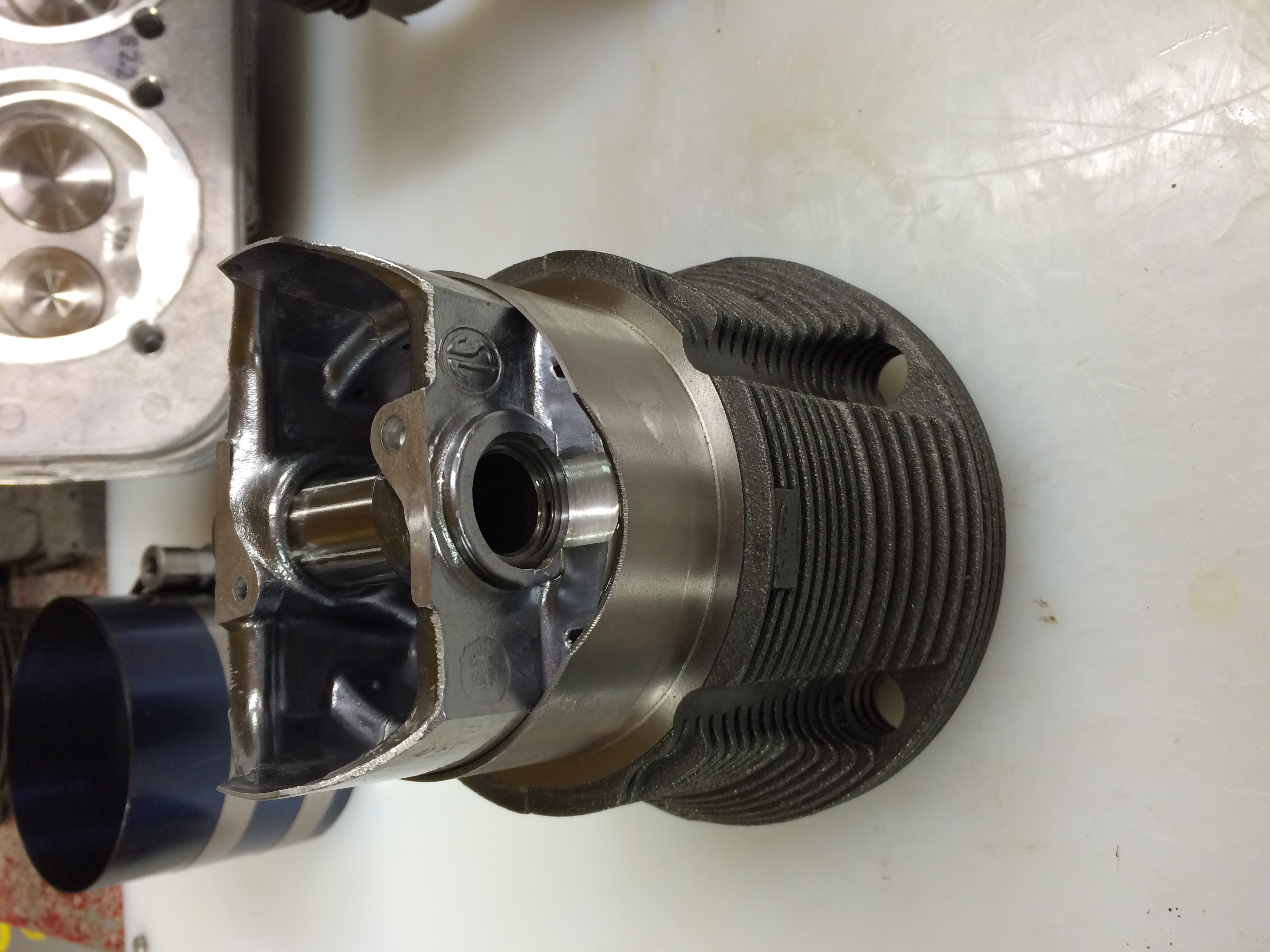

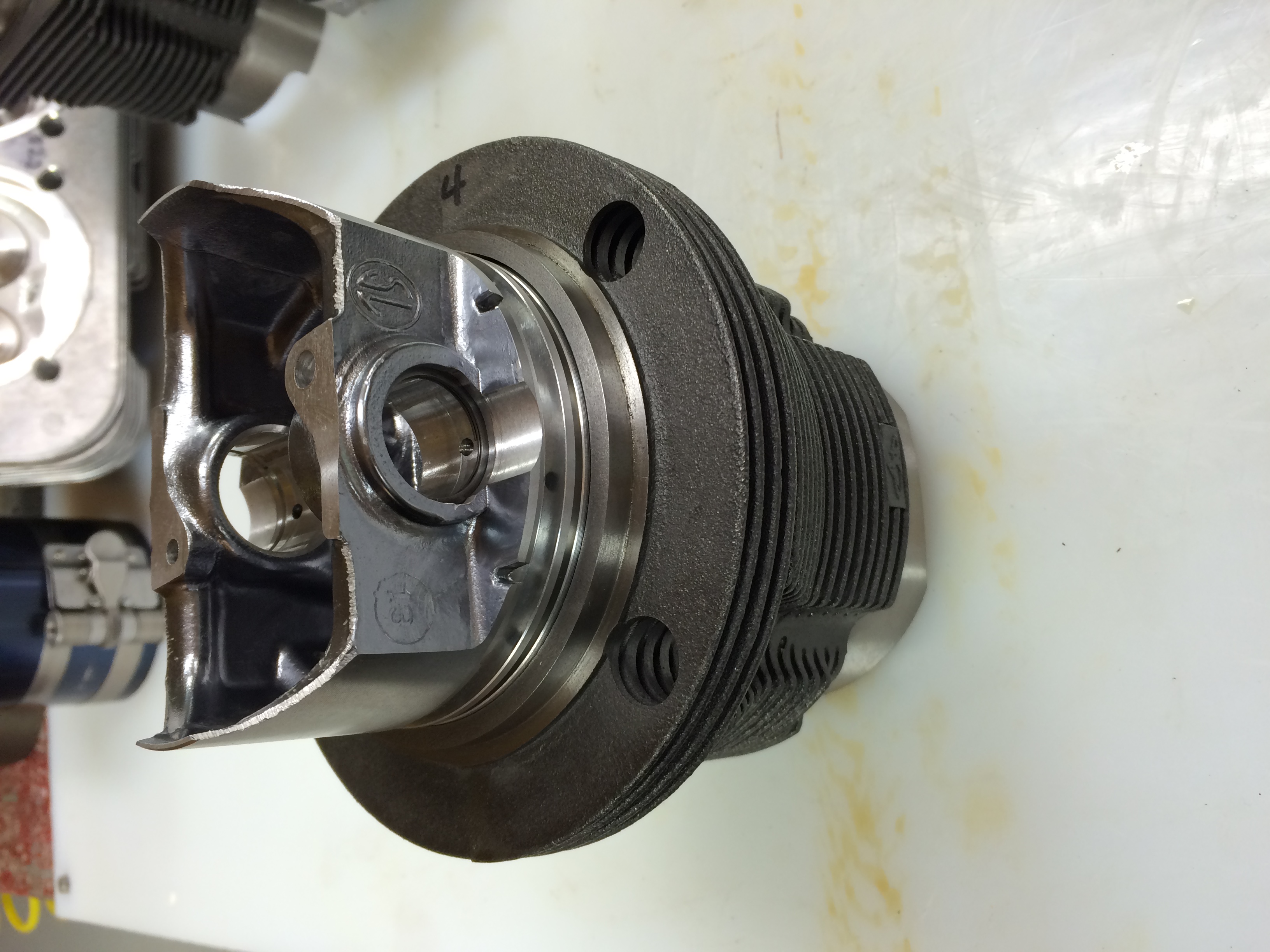

Installing pistons into jugs...
I hate (HATE) these new (to me) spiral-in wrist pin retainers. I hate them I say!
