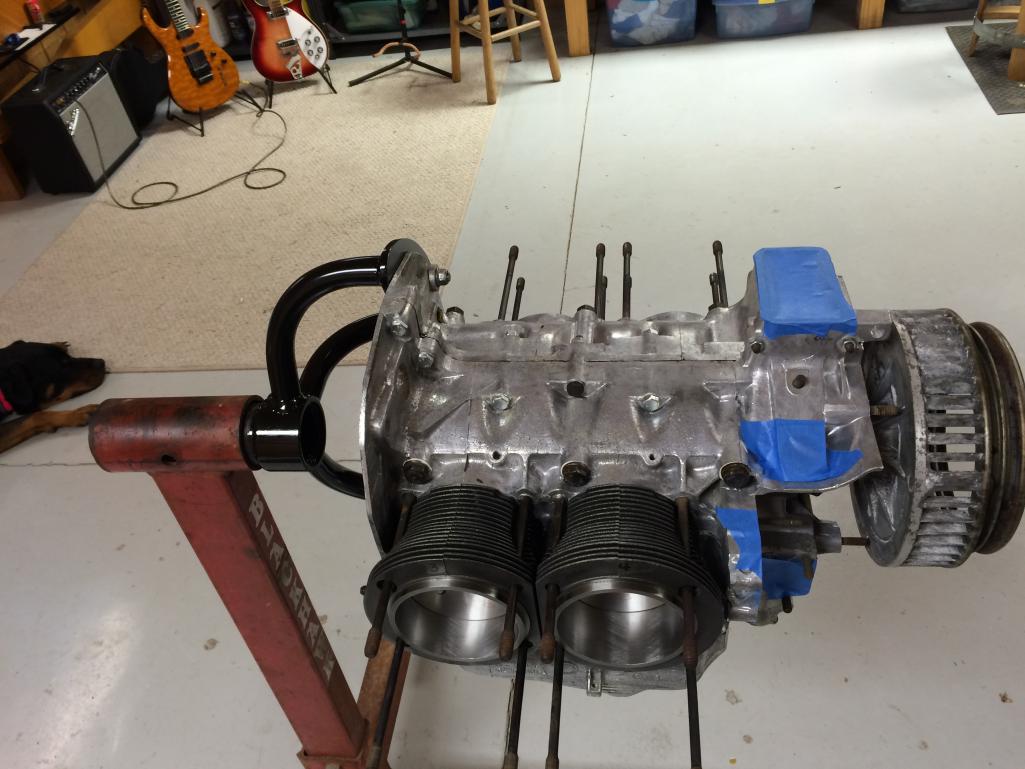

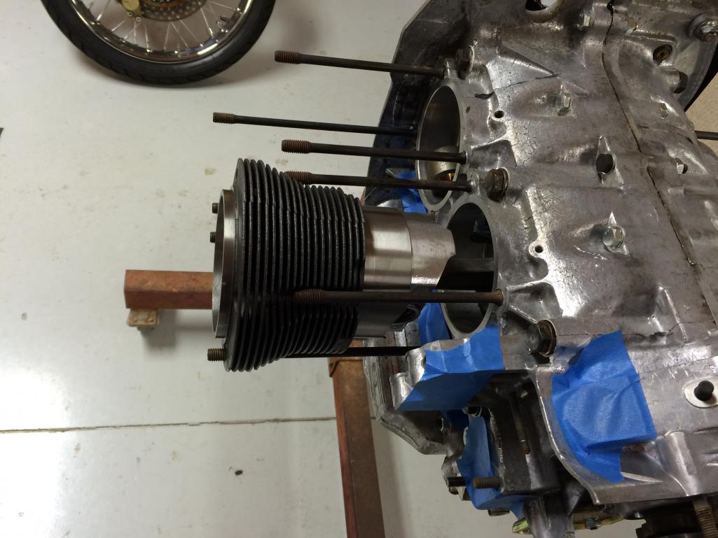

And finally on side goes together (sort of still). I mangled one of the oil scraper rails so need to make an order before I do the other side. For now this is loosely bolted up with spacers and I will return to it when I get back from a week's worth of travel for work.
I still hate the spiral-in wrist pin retainers. No one can change my mind on that.
Have I mentioned that I hate the new spiral-in wrist pin retainers?
