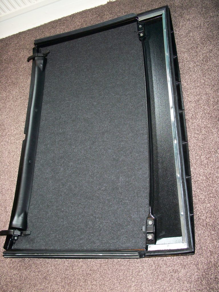

The plan is to fit the windsheild and rear window this weekend. I’d placed them in the back of one of the garages for safe keeping after taking them out the week before going to the paintshop.

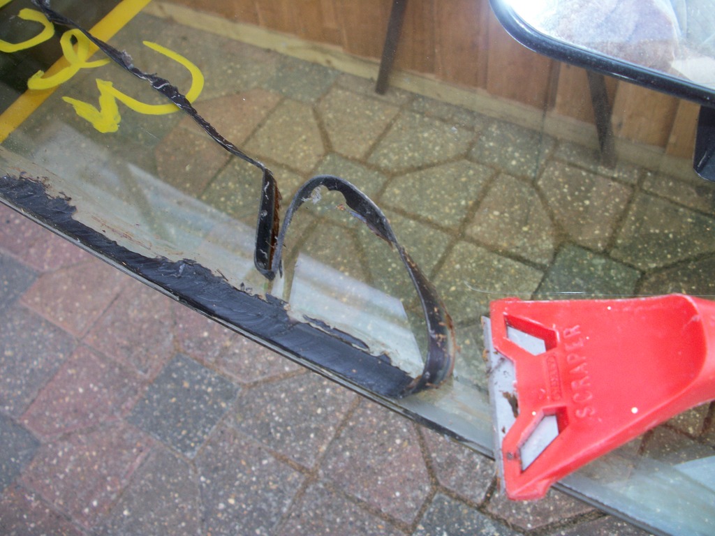

Setting up my trestles with extra foam padding I got out the rear window and with a brand new Stanley blade in my scraper I removed the old window stickers for South California University and Yellowstone Park. There was a good coat of paint on the glass too. Seems the last paint shop didn’t even take care to mask the glass let alone remove it. This all needed scraping off with a perimeter line of water limescale before the glass was scrubbed with Cif and scotchbrite. (A cheap supermarket green scotchbrite that doesn’t scratch). Flipping it over I cleaned both sides before starting on the windsheild
The glass is a replacement, having been fitted some time ago it was stuck in with tons of silicone! There was plenty left on the glass after slicing it out the car which needed cleaning off.
(IMG:http://www.914world.com/bbs2/uploads_offsite/i265.photobucket.com-18255-1464670538.1.jpg)
Again as with the rear window there was plenty of dirt, limescale (from years of car washing) and general grunge on the glass, so it got a total Stanley blade scrape and scotchbrite Cif.
(IMG:http://www.914world.com/bbs2/uploads_offsite/i265.photobucket.com-18255-1464670539.2.jpg)
After a few hours I’d got it cleaned up ready for the weekends installation. I’m not happy about the rear view mirror mount, so may need to take a look at prying it off the glass. The PO has glued it back on but scuffed up the base with 40 grit to key it and it looks awful from the outside looking in. Partially black with random sandpaper silver scratches to bare metal showing. I tentatively tried to get it off the glass tonight but its rock solid. As I was running out of daylight again, rather than rush it, I can take a look tomorrow.

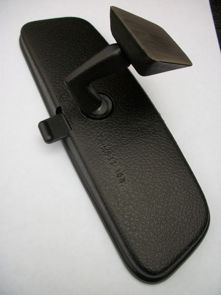

This morning before work I had a go at getting the mirror of the windscreen. The PO had stuck in on with what looked like araldite epoxy glue and had made quite a mess around the base. It was on rock solid so I had to get serious with it to remove it.
Setting up a layer of left over underlay from some laminate flooring from my old house (that I’d kept as it comes in useful for kneeling on while working) I carefully angled the screen, like in the car, so a good proportion of the glass edge rested evenly across the underlay pads.
The next bit isn’t for the faint hearted.
I got a new Stanley blade (loose) and rested it across the corner of the foot of the mirror. Next I used a toffee hammer sliding along the glass, ensuring it pressed on the inside of the screen as it moved (as you used to do when you nailed in window panes in old houses before using window putty) so that it struck the top of the Stanley blade and slowly drifted it between Mirror foot and glass until it was released.
The Mirror eventually came free, and wiping sweat from my brow I put everything away and left for work.

After playing with the belts, I got the trestles back out and marked the mirror position on the outside of the screen with masking tape. Flipped the screen over and set about carefully scraping the old glue off the screen with my Stanley scraper. A final Cif & green scotchbrite and you’d never know it’d been there.

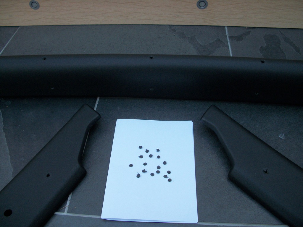

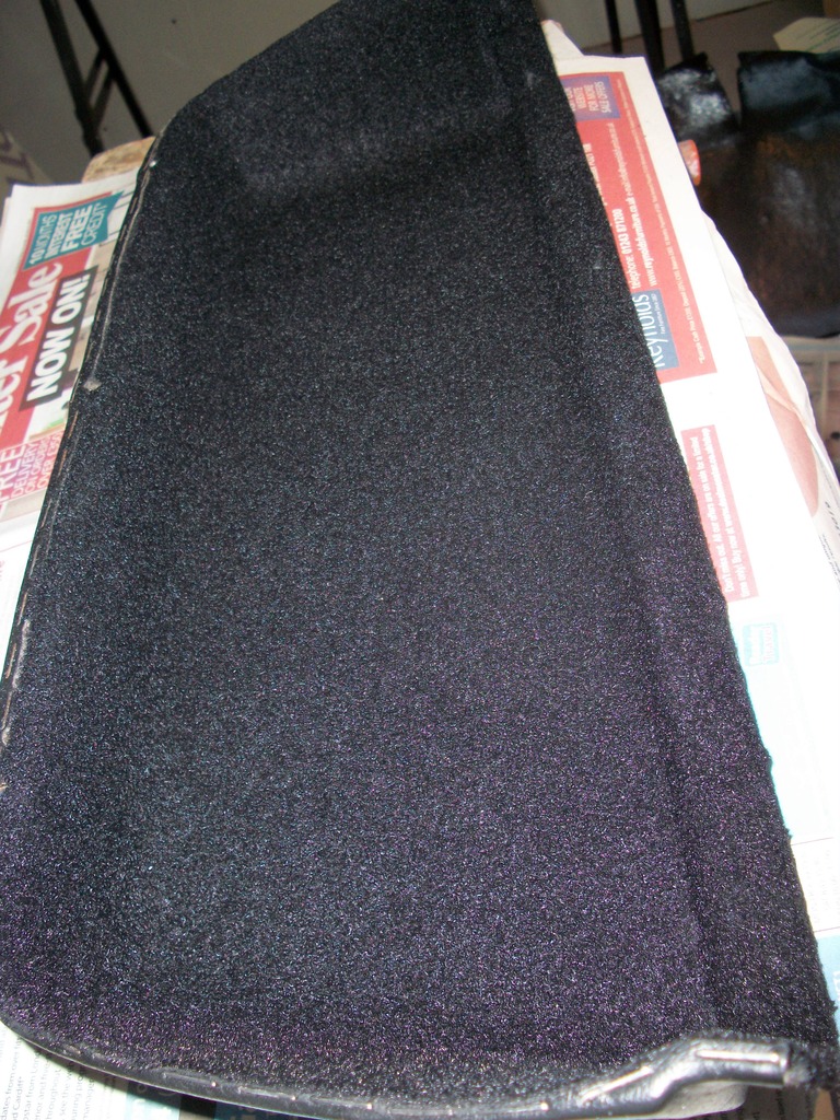

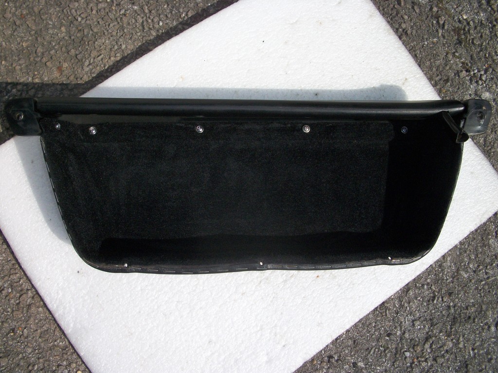

Today I called in at Porsche Centre and collected the screw caps and key blanks. I went to a franchise key cutters at lunch to get the blanks cut. They refused as I’d not bought the blanks from them! I went to a local independent locksmith and while he was cutting the keys he was obviously curious about the car they were for and we had a good chat. When he found out the franchise key cutters refused to cut the original Porsche blanks he laughed and said have them on me and refused to take any money!
This evening after work & food shop I measured up the blanks and turned down a simple tube cut tool and tested it in some spare vinyl for the cap fit before very carefully sitting down and cutting out the holes in the newly trimmed parts.
They’ve come out really good in comparison to the nasty split parts full of filler that I handed to the trimmers.

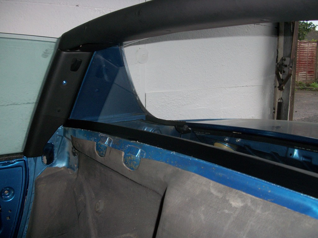

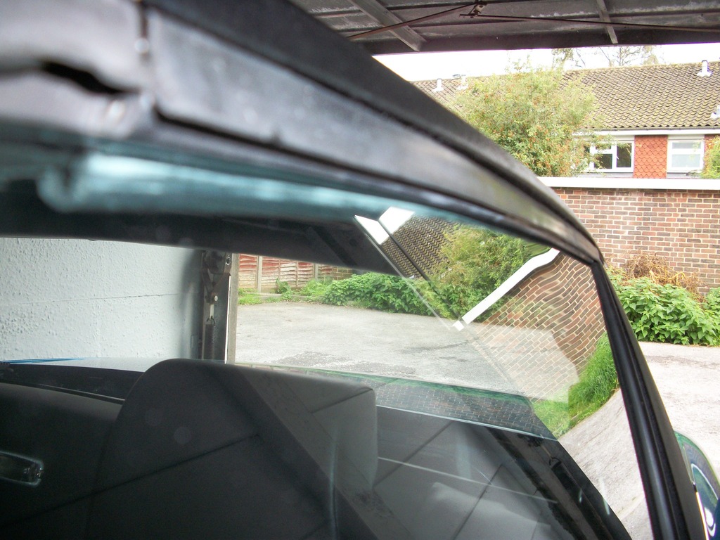

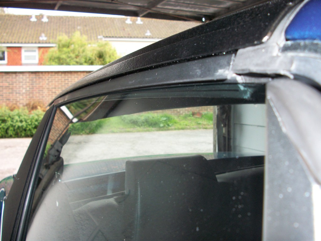

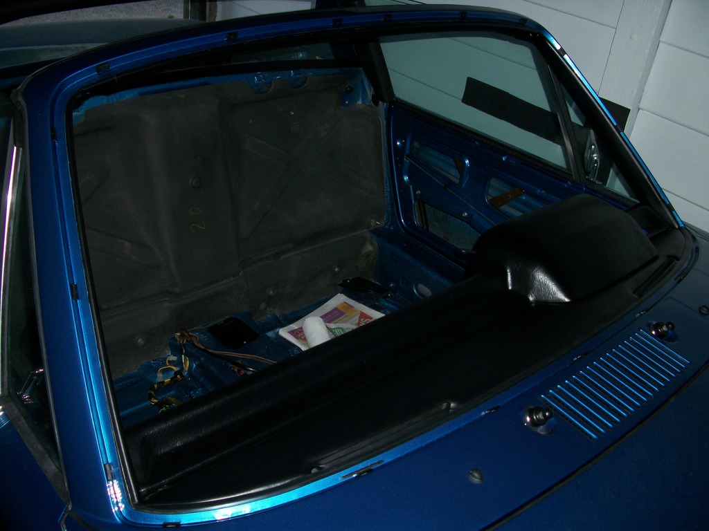

I got up early this morning and cleaned up around the rear window. I sorted out the small packing pieces form a bag of parts I’d previously made up and stuck them in place with a blob of caulking. I set up my padded trestles and gave the rear window a final clean up and degrease. Using the new 3m Butyl I carefully set a strip around the window aperture with the join spliced in at top centre.
Very carefully I lifted the glass into place and gently pressed it home, looking from the inside outwards to check an even stick and compression of the butyl.
Next I gently rested a piece of 4 x 2 against it while I went back to the house to sort out the roll bar trim. (Not that it was going to fall out, more for peace of mind)

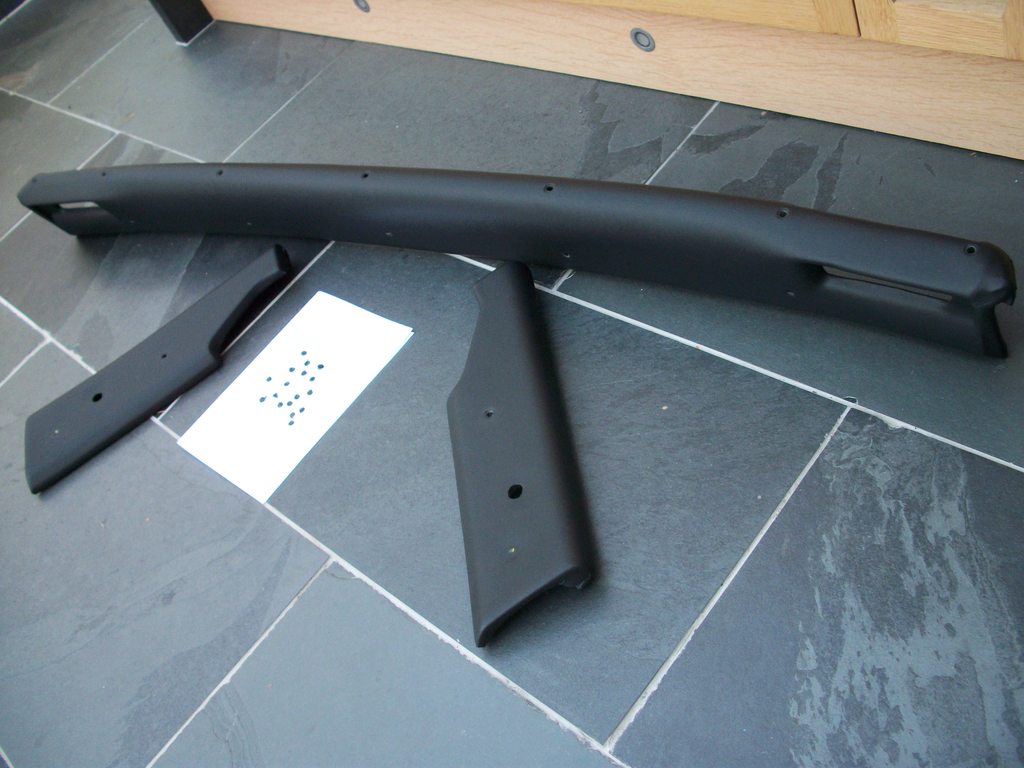

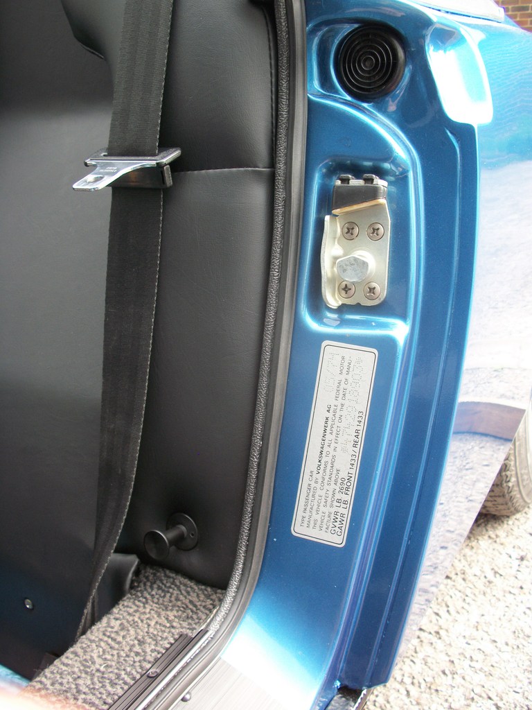

I fitted the two plastic surrounds for the rear roof latches back into the trim and unpacked the latches bolts and washers.
The latches were fitted to the roll bar and nipped up then the recovered padded trim fitted over them. What a puzzle that was for a while trying to get it back on around the roof catches, but with a little patience it went on. I’d pre fitted the horizontal screws so that the points showed through as they were a real sod to get out the trim before recovering and don’t easily go straight back in without dropping into the deep hole in the foam of the trim and then you cant get them to line up with the inner metal frame. Pre-fitting them was the easy way to do it.
After a little manipulation the trim was pushed into place and the horizontal screws tightened up. The vertical screws go through a much thinner piece of foam in the trim and with a torch looking up its much easier to align the holes in the car body and with a magnetic screwdriver just put the screws straight in.
The new blanking caps got fitted next, much more supple than the old rock hard ones and the trim was complete.

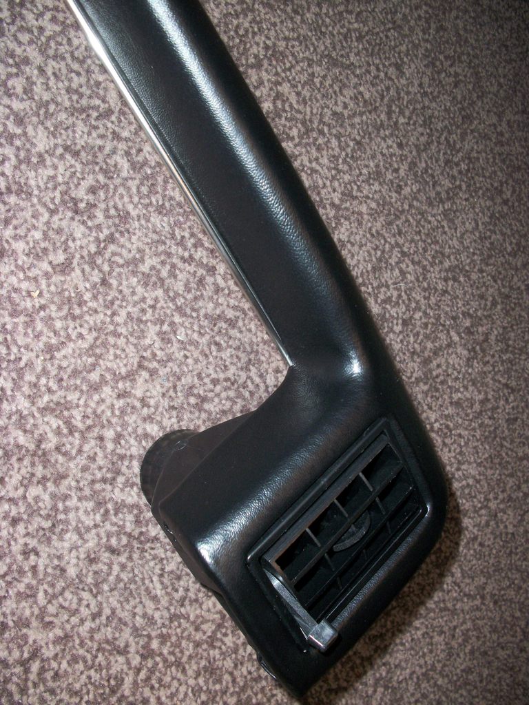

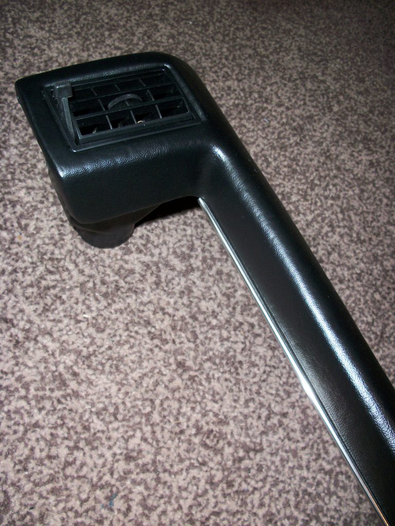

I then fitted the two re-trimmed windscreen pillar trims. I’d asked the trimmers to leave a flap of vinyl on the top so I could feed it around the metal channel under the rubber. With the ends of the lower roof seal pulled out and the tiny screws and cup washers out, all that was needed was a tweak the fit was good.
Due to the dash cap being fitted and the trims being recovered they were a little tight at the bottom. A little soft soap (PH neutral) was put on the metal pillar, rear of the trim and end of the dash cap. The Pillar trims slipped in a treat. As with the roll bar trim the screws were pre fitted so the tips just poked through and with a little manipulation all holes lined up and the trims secured. The tiny upper screws and cup washers refitted along with the lower roof seal, with vinyl flap tucked under. Again all new screw caps were fitted to finish off.

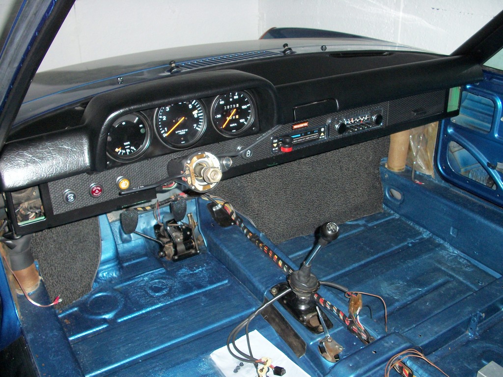

Today I sorted out a few long term electrical Gremlins. With most of the dash built up the majority of the loom was reconnected (apart from the centre console) so I decided to put the battery back on and test everything.
I started with the wipers. When I came to dismantle the dash I found the plug was already pulled off the wiper stalks and tucked up behind the dash? While the stalks were out I’d cleaned and tested all the contacts and cleaned the pins and spades in the plug. The wiper mechanism was unseized and cleaned and greased, all wires reconnected, battery on, ignition on, wipers on. NOTHING!
Here we go…..
So now was the time to find out what on earth was going on. I started at the fuse No8 and had power, so I gave the holder another clean and checked the fuse fit just in case. Still power but no wipers?
So I bit the bullet and took out the blower box again to check the wires on the wiper motor. I really wanted to do this before I put the blower box in, but I’d bench tested the wiper motor and it was ok, so never expected a loom issue (plus the dash was still out so I couldn’t test it in situ until today). Anyway, tested the wires and I was getting an intermittent low voltage on the red/white feed. It seemed to be ok with the cable pulled off the wiper motor but loose voltage when the wire was reconnected?
I went around in circles for a while and in checking the wiring diagram the same feed runs the fresh air blower. I’d bench tested the new motor, bench tested the rebuilt speed control and the slide fan controls in the dash and it all worked. Guess what, with the blower box out of position but loom plugged in it didn’t work either!
Looking at the wiring diagram the wipers share a power feed with the fresh air blower relay.
I dropped the fuse box and pulled out the fresh air blower relay and found a melted and burnt pin on the relay and in the holder. This must have happened to the PO when the blower fan broke up. There was some burning on the heater slide contacts I’d repaired earlier so it looks like the whole thing happened at the same time which would have probably smoked and smelt bad.
So now I kinda understand the PO unplugging the wiper plug now as I would imagine the melted relay would possibly smoke when the wipers were turned on (since the old fresh air blower motor had gone open circuit)
All was revealed. I set about repairing the relay holder and temporarily stuck my fuel pump relay in place (as it is brand new)
Put everything back together in the fuse box and battery on. Hey presto I had wipers!
Great I thought, moving the fresh air blower slide to try my new fan….Nothing!
With the air box still out I pulled the plug, switched on the fan and measured the voltages. 12V, plug back on, no fan? Eh?
After a bit of head scratching I decided to pry open the plug and take a look inside. There it was, a splayed open tube connector on the +12V (ironically all the –ve were fine). Cleaned up and back together, plug back on and eureka the fan worked.
I then spent a good hour wrestling the blower box back into position and compressing the top rubber seal. The lesson here is; check the wipers before fitting the blower box!
Next I tried all other switches. First to fail was the indicators, two blinks then nothing. Here we go again. Well to cut a long story short it was loose & dirty spade connectors on the relay base. Not wanting to be caught out again I removed all other relays and cleaned up their pins, female connectors and tightened everything up.
Trying everything else all was good except a gauge illumination bulb in the left gauge. Quickly popping out the gauge yet again I changed the bulb. All in all that’s 12 faulty dash bulbs the car had.

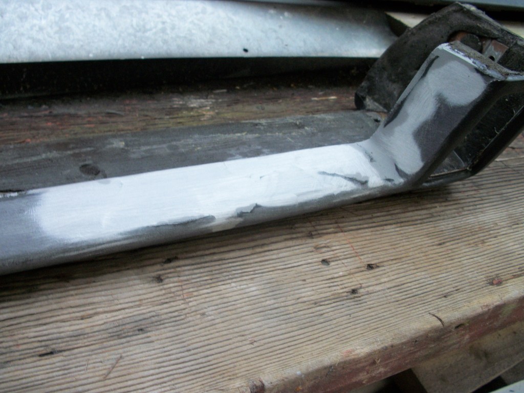

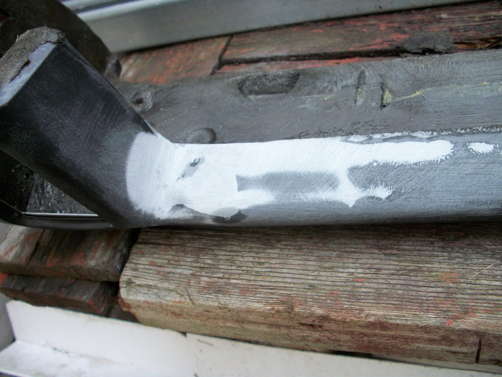

The weather was dry today so I got chance to rub down the flexible filler in the knee roll repair and start to reshape the damaged area. I applied another thin layer of filler and left for work.
This evening before getting too dusty with filler I decided to fit the rear window to deck lid seal as the window was well and truly stuck in and silicone cured. I wasn’t happy with the 914rubber seal so I’d bought a new genuine one. This went on a treat and sealed nicely along the glass just above the silicone and butyl.

While the paint dried on the expansion tank ring I sanded down this mornings filler on the knee roll.
A third layer was required to sort out a few air/pin holes and shaping so I mixed up a new batch and applied it carefully before leaving it to dry overnight. Hopefully this will be the last sand and finish before I can give it to the trimmers again.

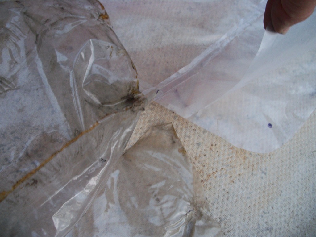

We had some really heavy rain & thunder through the day, but as if by magic at 5pm the rain had stopped and by the time I got home it was dry again in time for more sanding and filling.

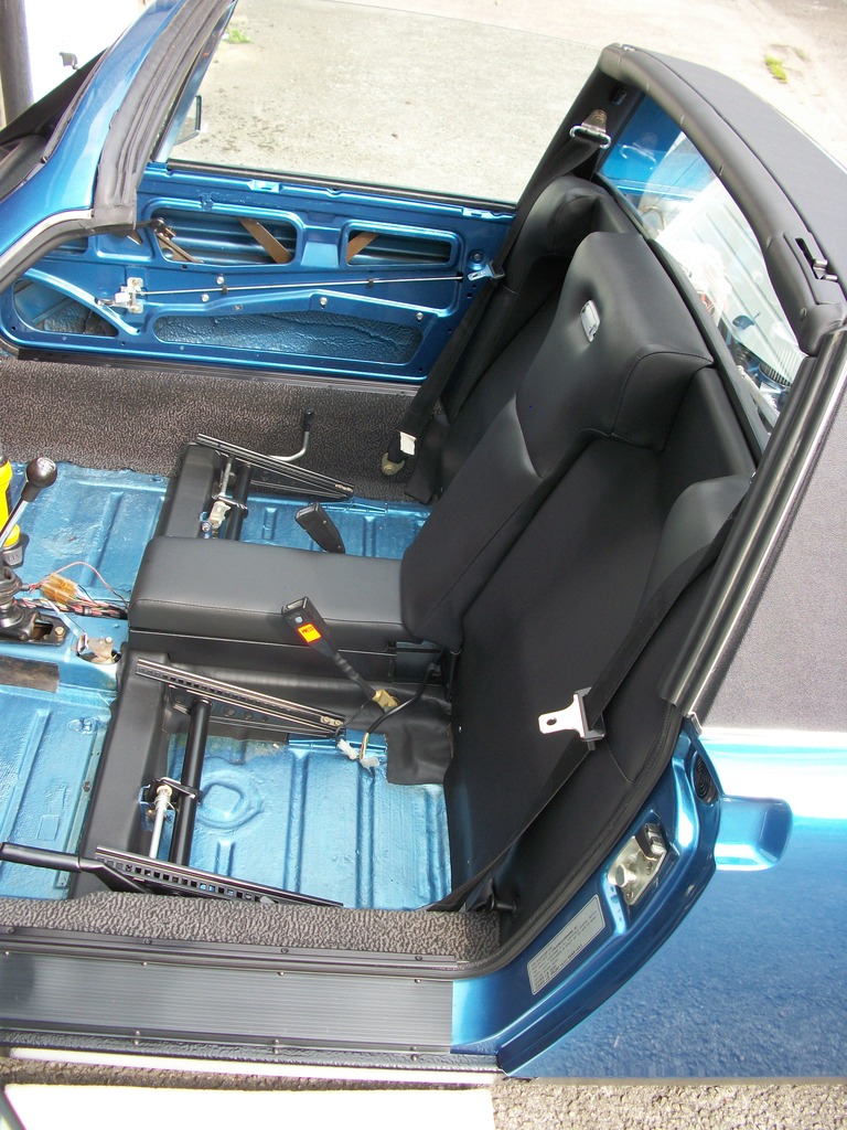

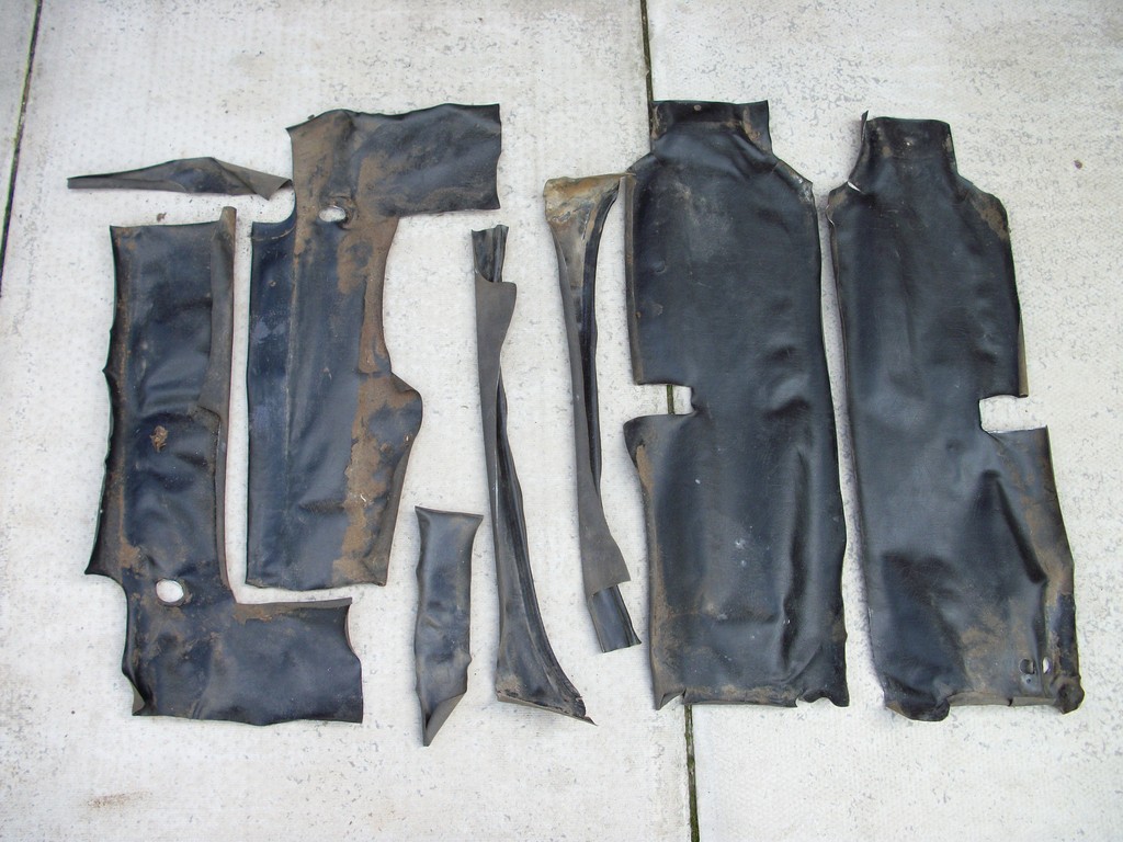

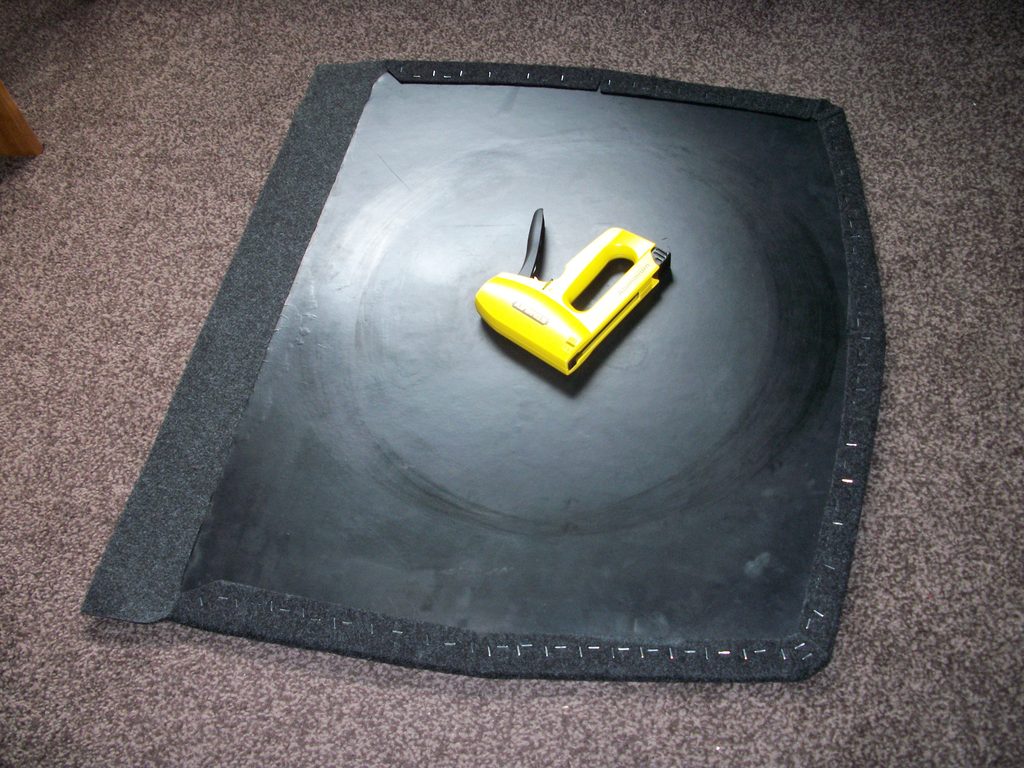

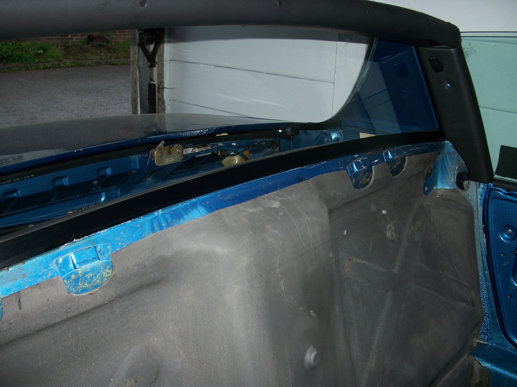

The accident at the trimmers had caused me a whole load of trouble chasing my tail across the knee roll to repair the torn off surface until I could make good.
After a lot of perseverance I finally sorted it out.

The plan is to drop it off at the trimmers again in the morning so that they can try again to recover it.

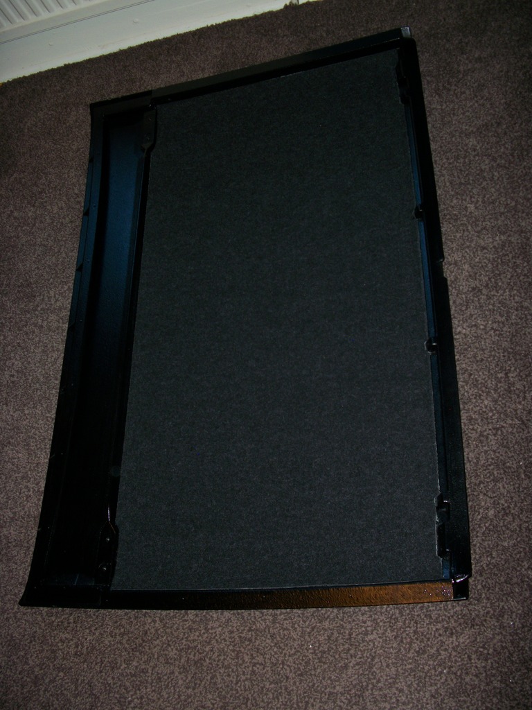

This morning before breakfast I gave the dash knee roll a final sand and inspection before loading it up to take to the trimmers.
I dropped it off a lunch time and called in at the post office to collect a sign for packet. Two new round relays I’d ordered to replace the fuel pump one I’d put into the blower and a spare.
Hopefully the knee roll will be re covered in new vinyl by the end of next week so I can finally get the dash all back together. It’s starting to look good with the refurbished gauges and column back in.

The rear window was cleaned a 3rd time and I carefully applied the vinyl with a rubber scraper following the curvature exactly without any trapped air bubbles. It looked superb!
Next I carefully fitted the two pillar trims. They were a little tight due to re covering of the top roll bar trim and the fact both side trims were recovered too. After a little effort the screw holes lined up perfectly and the trims were fixed in place. The coat hooks were next and I had noticed that the rubber cover that goes over metal bracket has two lugs on the base that “clip” over the metal bracket. When I stripped the car down one rubber cover was missing, but I fortunately found it under the seat. The reason was now clear. The metal bracket had been overtightened in the past which had compressed the foam in the pillar trim. This meant that the two lugs on the bracket sat into the trim foam and the rubber cover couldn’t clip over them and just falls off. I made a small black rubber packing piece to hold the bracket off the crushed trim about 2mm. This raised the bracket back to the normal height and the cover went on with a dull click and was locked firm in place. Finally I fitted two new blanking plugs over the screws.

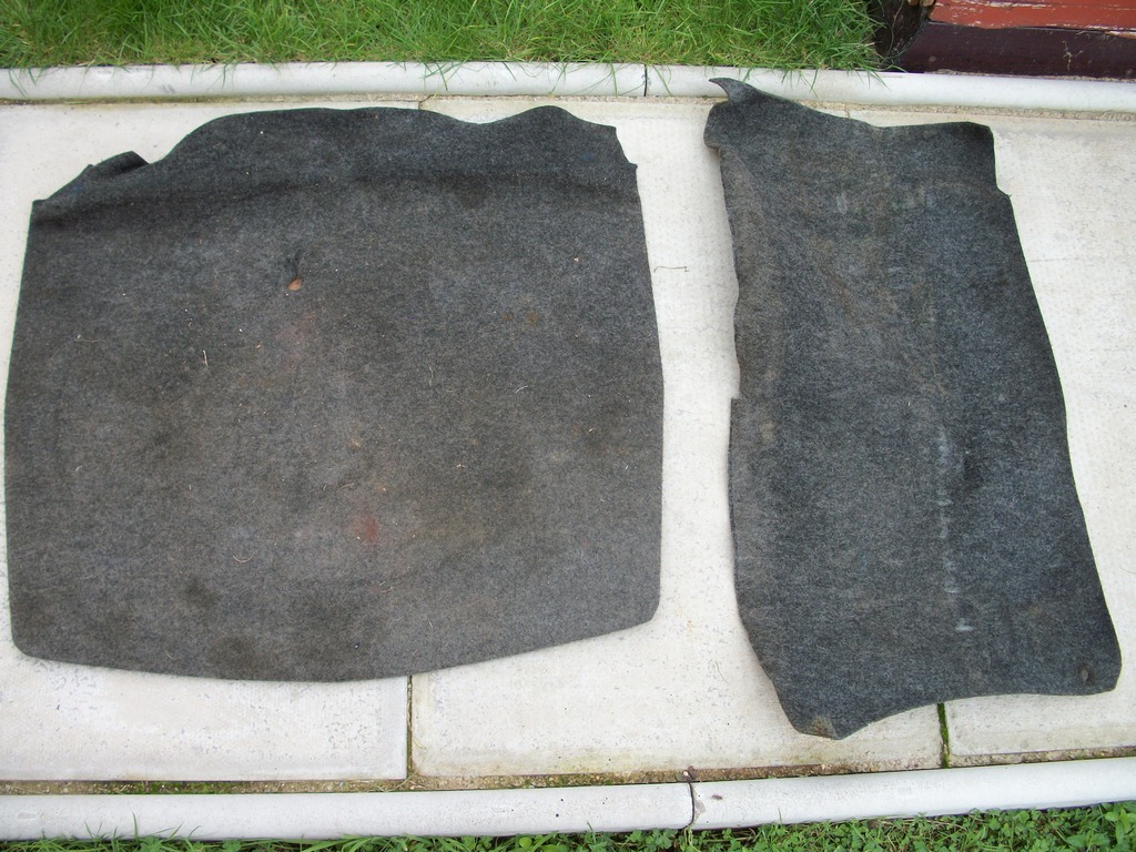

Day 221
This morning I got out of storage all the old bits of vinyl that I took off the car when taking out the interior. They had been well and truly sun baked to a crisp, scratched, punctured and torn in places so the only solution was to remake them with fresh supple vinyl.
(IMG:http://www.914world.com/bbs2/uploads_offsite/i265.photobucket.com-18255-1464670541.11.jpg)

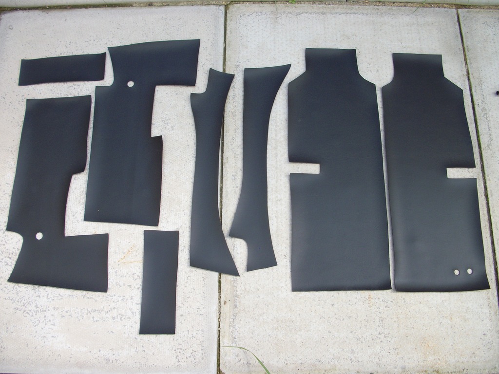

Using the old bits as a pattern I drew around them with chalk onto my roll of black vinyl. This wasn’t as easy as you’d expect as they were blistered curled up and generally hard to lay flat.
After drawing around them I added another ¼” as they had definitely shrunk.
Cutting them out neatly I had a fresh set to go in the car.
(IMG:http://www.914world.com/bbs2/uploads_offsite/i265.photobucket.com-18255-1464670541.12.jpg)
I spent the rest of this afternoon carefully gluing them in place with high temp/high grip impact adhesive working them into all the corners and around the curvatures. This took far longer than anticipated.
The first easy ones to go on were the two rectangles. These go just below the corners of the rear window to cover the metal panel where the seat belts exit.
Next the two “hockey sticks” that go along the rear of the door opening. Care was taken here to glue and cut them to roll over the spotweld flange that the door seal fits on, making sure they go from pillar trim to a good 5” along the top of the box sill.
The two sections that go over the crossmember were next. These get quite fiddly behind the hand break and around the switch. Also a little stretching was require near the centre tunnel to stretch it over the contours.
Once in it was the remaining centre tunnel sections that caused me the most difficulty. Getting them right into the corners at the rear of the tunnel and around the raised seat mounting was tricky. More so on the passenger side where I had to remove the seat relay and hold back the loom a little while I worked the vinyl into place.
After a quick trim with a Stanley knife all looked neat and tidy.
With a few hours of the day still left over I decided to fit the seatbelts and the handbrake switch.
Previously cleaned up and with new bolts and washers the seatbelts went in a treat.

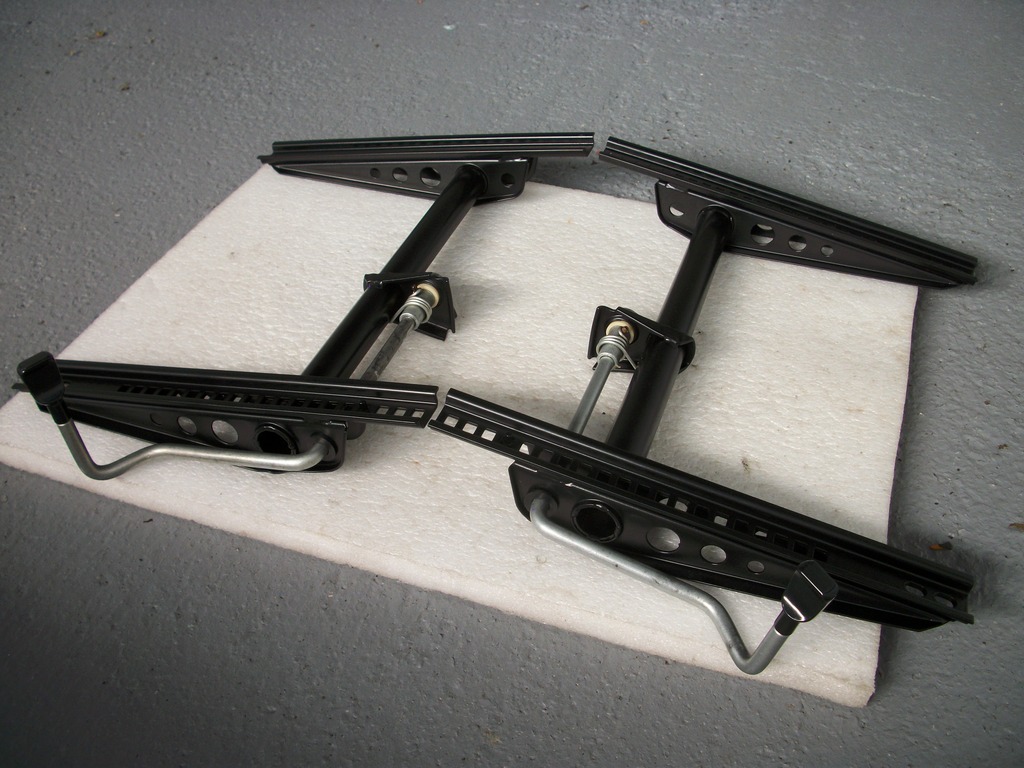

Next I unpacked my previously fully refurbished seat runners that I’d done while the car was at the paintshop.
(IMG:http://www.914world.com/bbs2/uploads_offsite/i265.photobucket.com-18255-1464670541.13.jpg)
Theses were carefully fitted with the toothed bracket and after a little adjustment of the small M6 bolts (at the hinged bracket on the floor) the mechanism operated smoothly and the latch located fully to allow the seat runners to raise and lower.
The previously refurbished seat belt clips were the next to go on with nice new shiny bolts & washers and the new “Press” decals.
Slowly gaining space back in my house and shed I took the re trimmed and rebuilt armrest out of storage and test fitted it.
(IMG:http://www.914world.com/bbs2/uploads_offsite/i265.photobucket.com-18255-1464670542.14.jpg)
I took these photo’s, then realized I’d put the seat belt catches in back to front! I quickly swapped them over.

This morning I started on the pedal assembly cover plate. The fibre board was looking a little tired and worn. I unbolted the clutch pedal stop, sanded down the board and gave it a fresh coat of satin black paint.
During lunchtime I shopped around for Morris parts for my son’s car and continued with the 914 this evening.
I first cleaned up the removed pedal stop, nuts & washers and gave them a coat of waxoil. Rummaging around in my shed I found a bag of parts that I’d not gotten around to cleaning up so got stuck in with them. This contained the heater “on” light block from the centre console, the heater lever escutcheon and a selection of fixings for the console, dash knee roll and pedal cover plate.

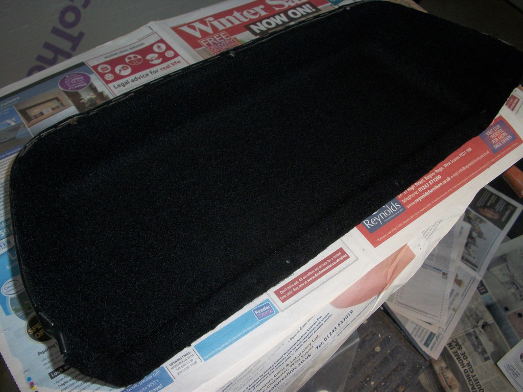

This evening I removed the gear knob, leather gaiter and fitted the centre tunnel carpet first. Then re assembled the pedal board with its bump & travel stops.
The board was carefully fed over the pedals and laid to rest in position. I then fitted my two new genuine Porsche pedal rubbers for the clutch & brake.

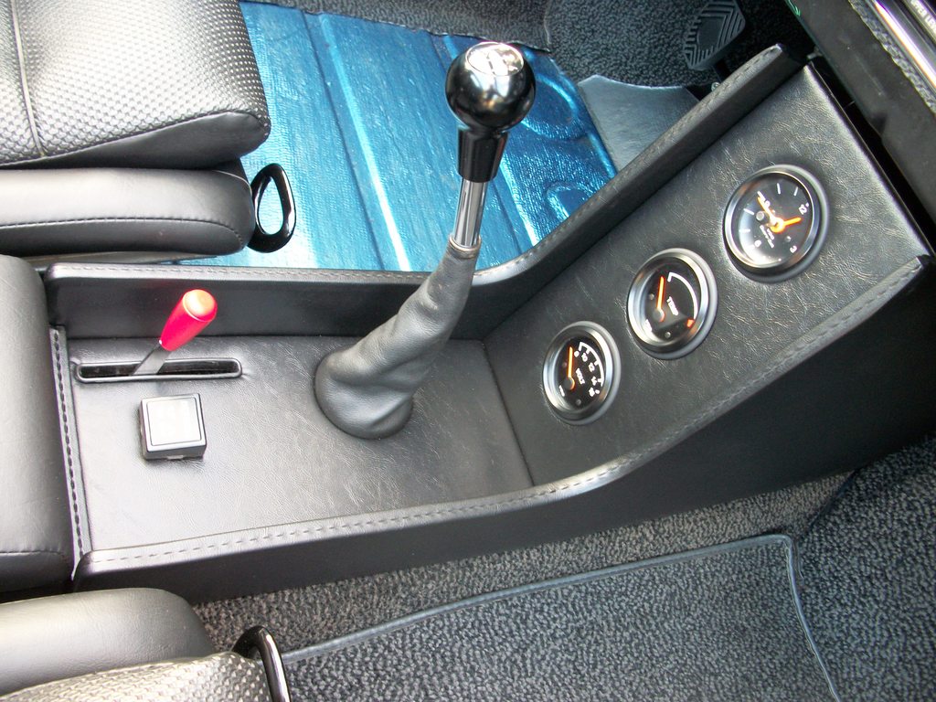

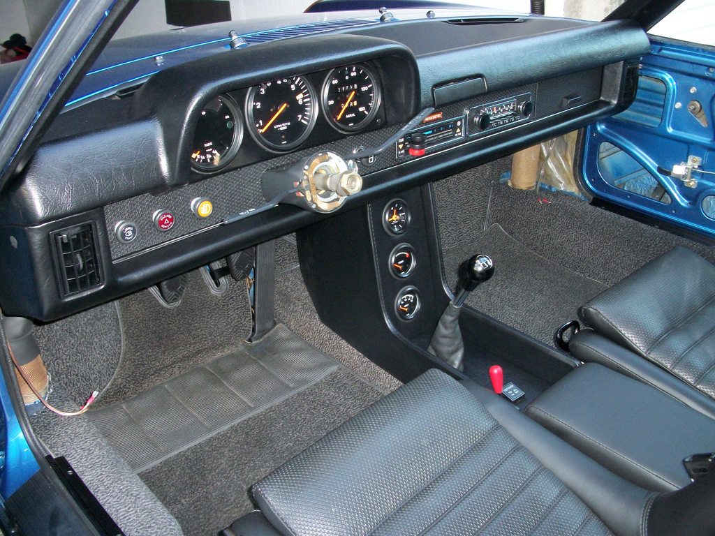

Next after having a trial fit and good look at clearance; I decided to fit the centre console before the knee roll is re trimmed as I reckon it’ll fit with the console in place.
Unpacking all the cleaned up fixings and bracket I screwed the console in place.
The newly refurbished 3 gauges were fitted to the panel and carefully holding it clear of the gear lever (with knob missing, it was just asking to scratch something) I fitted all the cables to the gauges and took off the very last of my paper wire i.d. labels.
With the panel propped upright I started assembly of the base insert panel.
The leather gear gaiter was nice and supple now and a nice black lustre was returned after 24 hours soaking in hide food. This was buffed lightly and fitted back into the base panel.
Next the heater lever escutcheon was given a blast of my heat gun and left to cool. The two long sides had, in the Desert Heat, bowed inwards to narrow the slot and restrict the lever movement. This looked awful, so with a small timber insert in the slot to hold it back open, heat was applied and left to cool back into shape. Being extra careful of course not to melt it and only heat from the underside so any risk of visible damage was removed.
The escutcheon was then clipped into place and the panel carefully held over the gear lever while I fitted the Heater illuminated block and wired it up. I’d cleaned up the block yesterday and sure enough the bulb was blown so this evening I fitted a new bulb and tested it. Heater block on the panel was finally clipped down and the vertical gauge panel fitted and clipped last.
The heater lever knob had faded to a milky pink on one side so I’d already purchased another (in the 914rubber bulk order). I was expecting it to not screw on, but no problems here, screwed on easily and was a nice even rich red colour.
Finally I nipped back indoors as it started to get dark and retrieved the passenger foot mat before fitting it in place and making sure the floor posts sat fully through the rubber eyelets to locate it correctly.

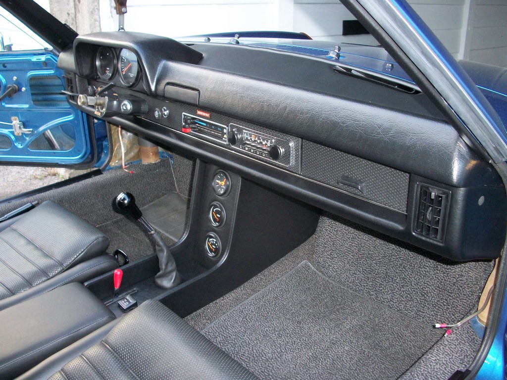

It’s starting to look quite nice in the cabin now. I was going to take another picture but the camera ran out of charge. I’ll take some over the weekend (if I manage to get that knee roll back)

I called in at the trimmers in my lunch break and unfortunately they’d had another accident trying to cover the old vinyl.
Unfortunately they’d made another tear in the old surface and pulled out some of the original foam and new filler trying to remove the new vinyl that they had glued on.
I know it wasn’t intended, but I was really annoyed that this was the second time they’d damaged the part trying to cover it.
I had no option but to bring it home again for the third repair.
Suffice to say, this evening after food shop, I ended up cleaning and starting to fill the new damaged area.
I managed to get a first fill and sand and a second fill (to dry over night) on the knee roll before it got dark. Fortunately it was a nice sunny evening so sanding filler down outside was possible.
Not quite what I had planned for this evening and into tomorrow, but I have no option but to fix the damage.

This morning I awoke just after dawn and started work on a few more 914 parts. The filler was dry on the knee roll but before I got all dusty I thought I’d sort out the rear view mirror which had been bugging me.
Being a California Desert car the plastic of the mirror right against the screen had been well and truly baked to a crisp. The UV had started to degrade the surface which had gone white and started to crumble. The mirror glass itself was in fair condition so rather than try and buy a new assembly I thought I’d give it a go with refinishing it. The mirror glass was carefully masked and padded. The fixing foot was painstakingly draw filed with chalk to get all the PO random scratches out of it while keeping the surface perfectly flat. Finally I sanded it with various grades of wet and dry in a straight line to give it a perfect brushed finish. Next I gave it a good 3M red Scotchbrite to take off the UV damaged surface layer and key it ready for a coat of satin plastic paint. With such a hot day today I managed to give it several light coats over the day in between other jobs. The result was a brand new looking mirror ready to go on the new screen.
With the first coat of paint drying nicely (taken inside my conservatory to stop flies & dust) I started to sand and refinish the knee roll.
After a couple of hours the knee roll was all repaired again ready to take to the trimmers on Monday.

As soon as I got back I started on the 914 seats. The runners that fit to the underside of the seats needed cleaning up. I brass wire brushed them clean and stripped the paint off the adjustment hoop handles down to bare metal as it was all flaking and looking awful. The handles were rubbed down and painted with a durable gloss black and coated the runners with waxoil before being put alongside the rear view mirror to dry.
Next I started on my newly upholstered seats. Only the original basket weave was left, all other vinyl has been replaced with new. Unfortunately as good as the trimmers are at seats, they won’t spend time cleaning stuff, so the basket weave was still pretty dirty. I used a foaming trim/carpet cleaner and a toothbrush and spent about an hour on each seat cleaning into the weave pattern to get them somewhere like presentable before running out of light.

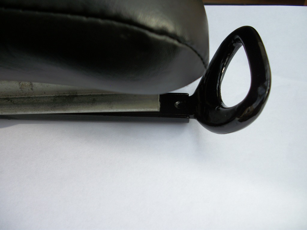

I tried the recently refurbished seat runners (the ones that fit to the underside of the seats) onto the runners in the car. Hmmm, bit tight on the new powder coat so I spent the next hour fettling them until they slid with ease.
Just then about 9am the heavens opened and I had to quickly push the car back inside the garage.
I took the runners back into the house and fitted them to the bottom of the seats.
The pull handles and shiny metal runners looked good back in place.

Still raining outside I decided to get my freshly restored and painted Targa top down from the loft. I gave it a wipe with a damp cloth as it was a little dusty before measuring it up for the new Perlon headliner. This is roughly 45” x 24” I carefully unrolled my new Perlon and marked a piece out to the size above, making sure all sides were true and 90 degrees to each other, then cut it out. Dry run fit and all was good.
Masking off the inside of the roof to leave only the area where it needed glue I then used a high temp, high strength spray glue from Woolies. Same on the reverse of the Perlon, waited 10 minutes until touch dry, then carefully fitted it.
(IMG:http://www.914world.com/bbs2/uploads_offsite/i265.photobucket.com-18255-1464670543.20.jpg)
I used an old fashioned beech wood wallpaper roller to go over every square mm to ensure it was well and truly stuck down. All that was then required was a tiny trim around the two rear catch mountings and the small webs along the front that are hidden under the padded trim. Looks very nice now. The old headliner was sand logged (see way back in this thread) and despite numerous vacuuming and brushing, it still dropped grains of sand and fibres of Perlon so with my new interior that simply wouldn’t do!

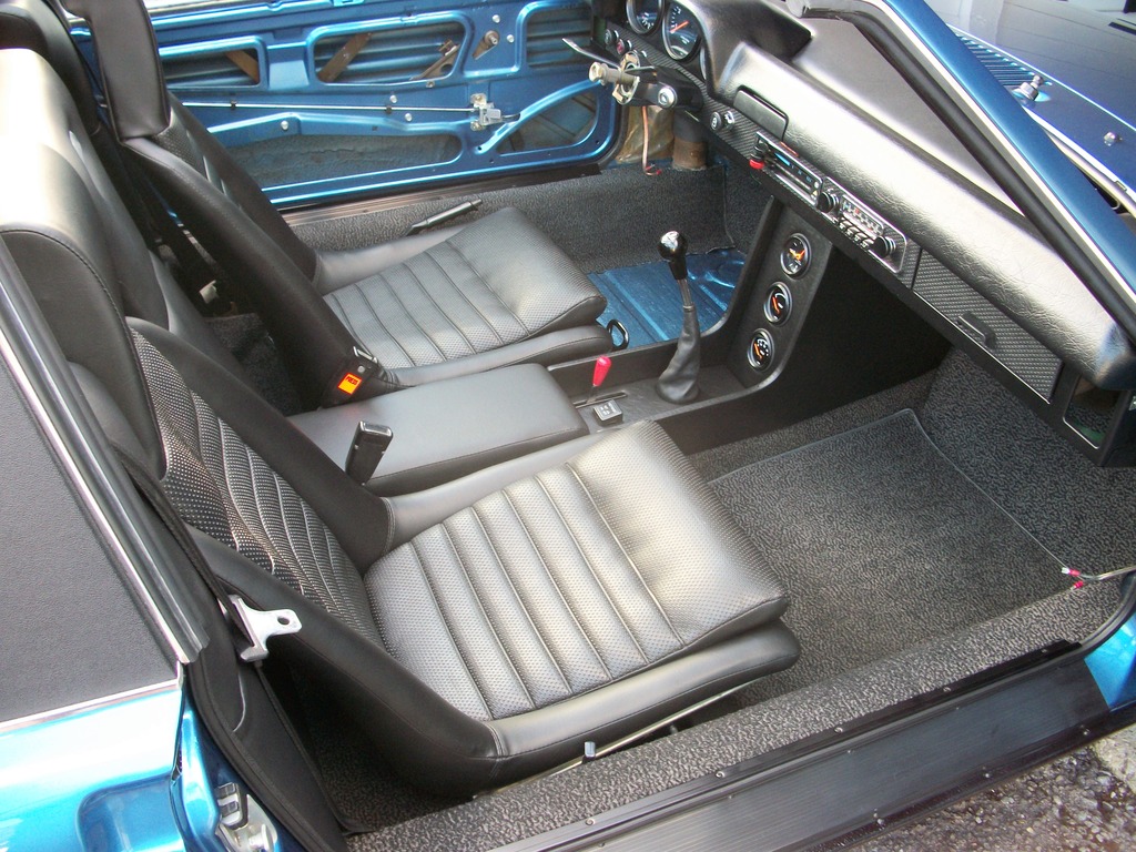

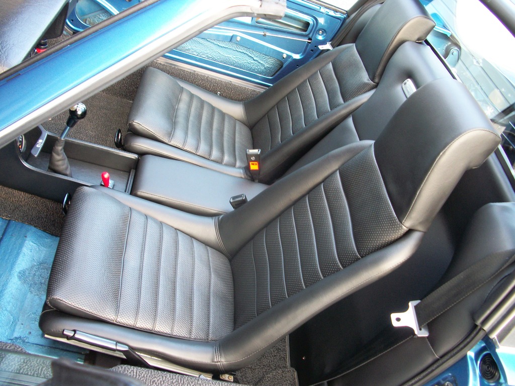

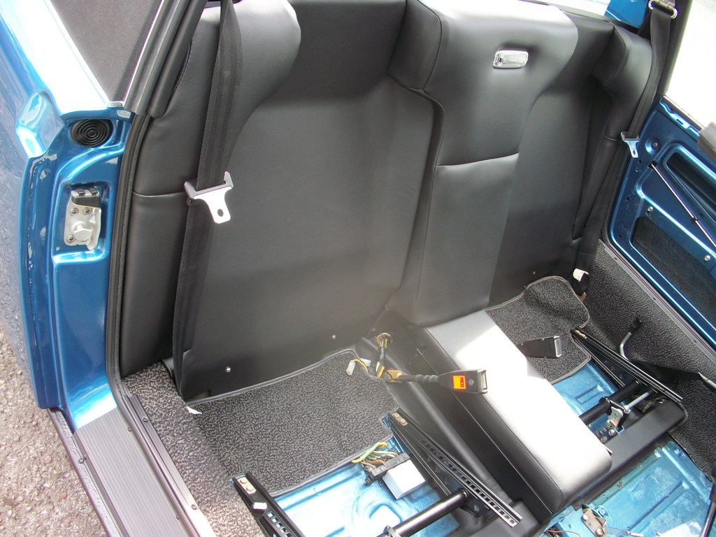

Car pushed out the garage once again I fitted the seats.
With camera in hand and the sun out I took a few more pictures starting with the re-assembled restored centre console, gauges, heater controls and gear knob.
(IMG:http://www.914world.com/bbs2/uploads_offsite/i265.photobucket.com-18255-1464670543.21.jpg)
Then of course the seats, which after that second scrub up looked like new again. New vinyl and soap & water, no nasty “wet look” greasy plastic cleaners in sight!
(IMG:http://www.914world.com/bbs2/uploads_offsite/i265.photobucket.com-18255-1464670544.22.jpg)
(IMG:http://www.914world.com/bbs2/uploads_offsite/i265.photobucket.com-18255-1464670544.23.jpg)
Just need to get that dash knee roll re trimmed, get some new speaker covers and I can complete the dash.

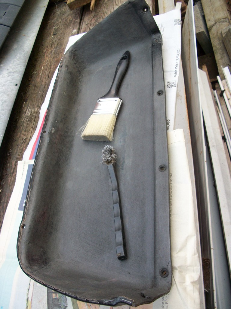

Since it was still dry this evening I got the two door cards out of storage and started to clean them. Much like the seats, the dreaded basket weave material was holding no end of dirt, sand and grime. I spent a good hour on each panel with a foaming cleaner and toothbrush. Some of the staples along the bottom behind the panel have come away and the basket weave is loose. Once cleaned and dried out I plan on re-gluing and stapling it all back in place. Fortunately the only small tear is around a bolt that holds the armrest on so should be covered.
As it started to get dark I brought the panels inside to dry out. I expect they’ll need another going over tomorrow when I can see any dirt left over once dry.

In the end I took the roof over to the car and fitted it (minus the window top channels) to see for sure how they went.
The roof was a real tight fit onto the car with all the new seals and took some pushing and pulling to install it for the first time. I think I’m going to have to leave it on the car a good while for everything to settle in.
With that cleared up I took the roof back to the house to fit the runners and new 914rubber window top seals.
Channels fitted a treat but sliding the Tee of the window rubber into the runner was another matter. I tried all sorts. Talcum powder, soft soap, washing up liquid, Vaseline (not all at the same time) and after getting about 6” of rubber in the channel it was rock solid.
I spent the next TWO hours wrestling the seals. In the end I had to forget trying to slide the seal, but instead I had to squash it down its length so that the T curled in on itself enough to locate it into the channel. By the end I’d had enough and having got just one side in, I’ll leave the other side until tomorrow when I’ve had time to relax and regain my patience.
Day 232
Anyway this evening I got the last seal in. The seals were a good 2” too long (well one was the other was an inch too long). Even before fitting one was longer than the other. Once in – and considering I put them in by squeeze not slide – I needed to cut them to length at the windscreen end. I did this with a brand new Stanley blade and squared off the ends that had arrived wonky.
I was then ready to trial fit on the car again.
(IMG:http://www.914world.com/bbs2/uploads_offsite/i265.photobucket.com-18255-1464670544.24.jpg)
All fine in the end.
The square cut off end by the windscreen met the frame rubber perfectly and the 45degree end over the roll bar sat neatly on the vertical seal giving a tiny resistance as the rear latches were closed.
With the door windows wound up there’s a bit of adjustment to be made to the regulators to level the glass off against the roof seal. This was something I couldn’t do until the roof was finished which is why I’ve held off with fitting the door cards until now. Something for next week.

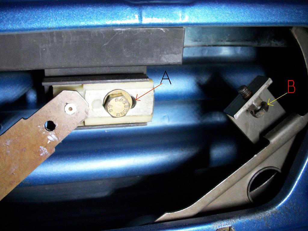

Earlier I’d fitted the targa roof and noticed the window glass wasn’t level/parallel to the roof. The glass was up into the rubber end cap at the top of the quarterlight front runner, but with the roof now on, it was about ¼” (6mm) low at the rear leaving a clear gap into the car?
I’d looked at multiple images on-line of the glass to roof alignment, some hard to make out, but generally they seemed to vary wildly. I’d also looked at other 914’s and had come to the conclusion that the panel and glass fit wasn’t that great originally, but certainly better than I had at the moment.
With the door panels off I thought I’d have a play around to see what could be done to make the car watertight
Before I’d fitted the roof, the glass was adjusted so it sat evenly on the vertical seals and the angles adjusted at the bolt adjusters on the base of the runners in the bottom of the door. I’d also adjusted the limit stop (B) so that the glass stopped when it reached the runner end cap at the top of the quarterlights, yet still the glass was low at the rear in comparison to the horizontal roof line. The glass needed to rotate ever so slightly in the door to raise the rear.
This had me flummoxed for a while because the short horizontal mechanism channel runner at the rear of the door held on with M6 hex bolts was as high as it could go, yet the glass was still low……….
After a bit of head scratching and trying different things, the penny dropped.
The mechanism is a sort of pincer, and if the distances between the two tops of the pincer are shorter/closer then the net result is the reach is higher. Since the rear part of the pincer is a roller in a runner (short horizontal mechanism channel in para above) and that was already adjusted as high as it could go, it couldn’t be that. However the front pincer top is a M8 bolt in a slotted block (A) which you can adjust.
Simply moving the M8 bolt to the rear (the block forward) allows the glass to lift further and change its angle/rotation within the door.
(IMG:http://www.914world.com/bbs2/uploads_offsite/i265.photobucket.com-18255-1464670544.25.jpg)
With the M8 bolt (A) slid to the rear, the end stop (B) needs to be adjusted again and another ¼” (6mm) can be gained at the rear of the glass before it hits the front quarterlight runner end cap.
RESULT…
Level glass on both sides that goes up to sit neatly on the Targa roof seals with no gaps for water or hopefully wind noise.
(IMG:http://www.914world.com/bbs2/uploads_offsite/i265.photobucket.com-18255-1464670545.26.jpg)
(IMG:http://www.914world.com/bbs2/uploads_offsite/i265.photobucket.com-18255-1464670545.27.jpg)
With everything adjusted I checked the windows wind up freely, doors open and close easy and then nipped up all the adjustment bolts to complete the job.

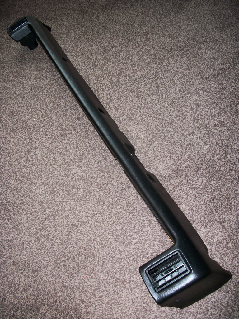

Today I have continued to work on the knee roll. A little more fettling and gluing was required. I picked up some high strength doublesided tape at lunchtime from the Motor Factors and fitted the stainless trims to the rear of the roll, making sure to carefully measure the “gap” position where the steering column plugs go.
I got the two vents out of storage and fitted those into the knee roll so that I could check the 4 clips on each open properly to lock it in place.
The hardest part of re-trimming the knee roll was getting the vinyl to stretch and glue down the bolt hole recesses. In the end I had to apply gentle heat and draw them down with a long nut and bolt and the old penny washers. Leaving the glue to dry overnight I hope to finally get it back in the car tomorrow and complete the dash.
Finally this evening I gave the basket weave on the door panels another scrub; they seem to dry after a few days each time with grey muck at the bottom of some of the pattern which is quite frustrating, but I’m getting there.
Day 236
Today I finally finished fettling the re-trimmed knee roll. I’m quite pleased with how it came out in the end after all the grief it caused. The plan (like the roll bar trim) was to try and make it look as original as possible and as if it hadn’t been re covered at all. Considering all the splits and chunks missing from it and the 3 filler repairs, it didn't turn out too bad in the end with a good grain match to boot.
(IMG:http://www.914world.com/bbs2/uploads_offsite/i265.photobucket.com-18255-1464670545.28.jpg)
(IMG:http://www.914world.com/bbs2/uploads_offsite/i265.photobucket.com-18255-1464670545.29.jpg)
(IMG:http://www.914world.com/bbs2/uploads_offsite/i265.photobucket.com-18255-1464670546.30.jpg)
After work today and with nice new shiny bolts I managed to fit it back into the car today.
(IMG:http://www.914world.com/bbs2/uploads_offsite/i265.photobucket.com-18255-1464670546.31.jpg)
(IMG:http://www.914world.com/bbs2/uploads_offsite/i265.photobucket.com-18255-1464670546.32.jpg)
I hope this inspires others to have a go at fixing up their interior parts when they think all is lost through age and damage. Most things can be repaired & restored in some way.
Just need to get the steering wheel back from the trimmers now.

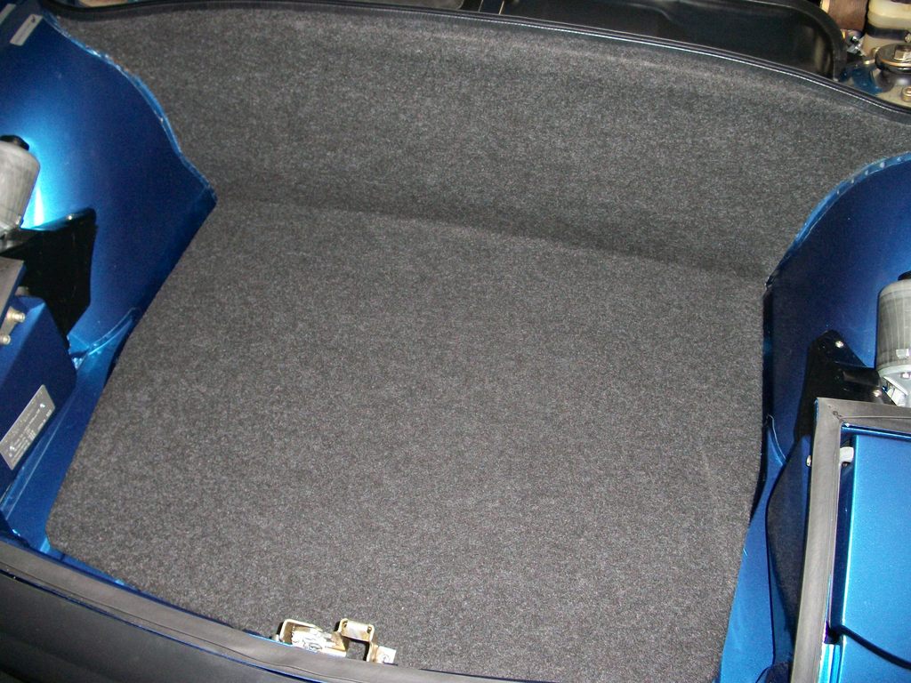

Anyway, late morning I started on the old front trunk carpet. The old Perlon was very dirty and torn so had to go.
(IMG:http://www.914world.com/bbs2/uploads_offsite/i265.photobucket.com-18255-1464670546.33.jpg)
The hardboard spare wheel cover has the Perlon stapled on, so I carefully picked all the staples out and cleaned up the board. The edges are painted black but several areas had worn and started to crumble. These were re painted with matt black paint; applying it heavily so it soaked right into the board on the edge, this sealed as well as coloured it. The underside face that sits against the wheel wasn’t too bad just a few chips which I touched in with a modellers brush. While that dried I got out the remains of the Perlon sheet I’d bought for the headliner and marked carefully around the old carpet with chalk.
(IMG:http://www.914world.com/bbs2/uploads_offsite/i265.photobucket.com-18255-1464670547.34.jpg)
These were carefully cut out with my shears and the hole for the washer tube punched out. I had a little delay looking for my Staple gun and in the end I remembered I’d lent it out but couldn’t get hold of the guy so had to nip and buy a new one from the hardware store. By the time I got back the black edge paint had dried so I carefully stapled the Perlon on; stapling alternate 90 degrees with the gun so that the staples had the best mechanical advantage to not pull out.
(IMG:http://www.914world.com/bbs2/uploads_offsite/i265.photobucket.com-18255-1464670547.35.jpg)
The front bulkhead and whole boot was then carefully masked off and high temp, high grip spray glue applied to it and the rear of the carpet. While the glue touch dried I took off all the masking tape and paper so that there was no chance of the Perlon getting stuck to the masking paper and tape while being lifted into place.
Once the bulkhead carpet was in place I fitted the new rubber seal across the top. This was a genuine Porsche seal and fitted perfectly to complete the trunk.
(IMG:http://www.914world.com/bbs2/uploads_offsite/i265.photobucket.com-18255-1464670547.36.jpg)

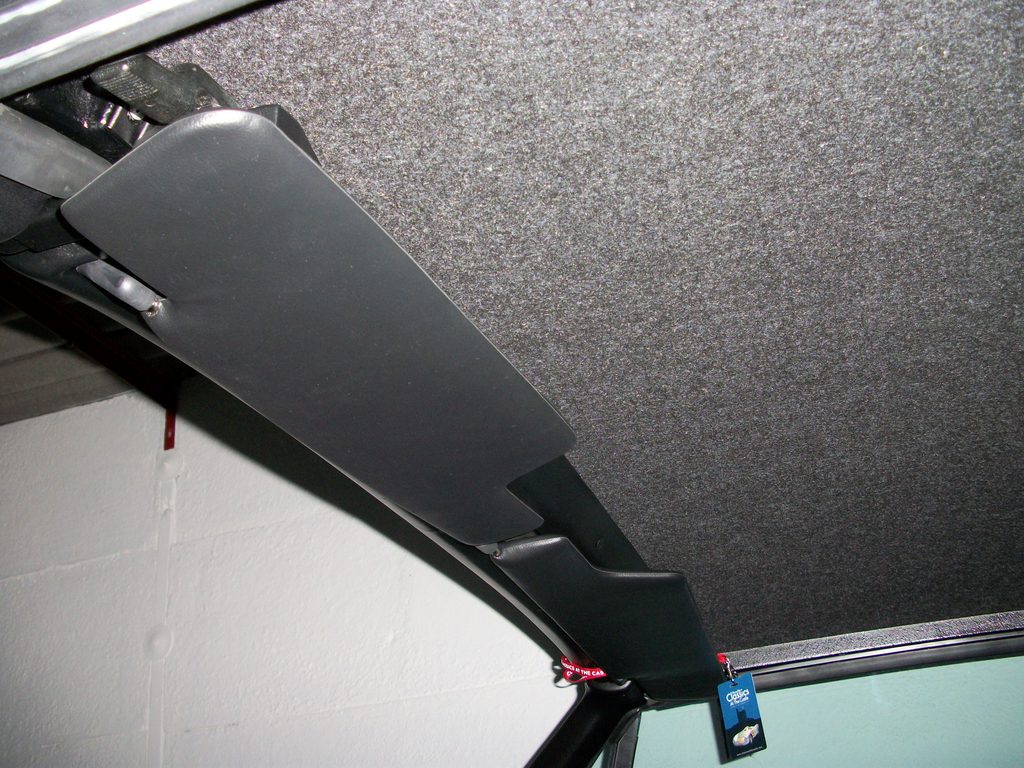

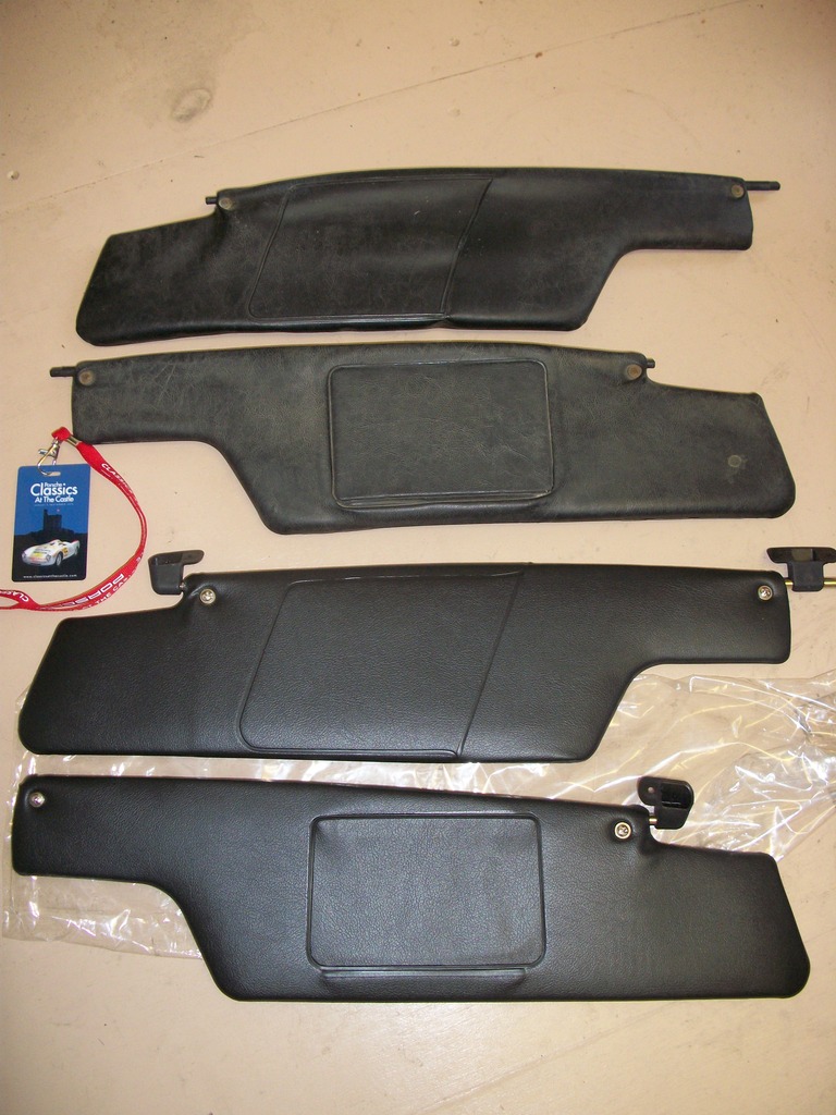

Arriving home I started by getting my new sunvisors out of storage. The originals were in a shocking state all lumpy and mis-shaped so couldn’t go back in the car. The brand new ones were found on German Ebay and purchased a couple of months ago.
(IMG:http://www.914world.com/bbs2/uploads_offsite/i265.photobucket.com-18255-1464670548.37.jpg)
To show its realtime (to the UK guy’s) I’ve included my entry pass from Castle meet in the pictures!
The old screws were cleaned with a brass bristle wire brush before a brasso polish of the heads ready to fit.
They came in a single box so the passenger side visor needed sliding onto the centre rod. This was a bit of a fiddle as the vinyl was heat welded all around so the hole needed very carefully cutting in it to allow the rod to fit. The rest of the installation was fine once the distances were set for the brackets to match the windscreen frame screw holes.
(IMG:http://www.914world.com/bbs2/uploads_offsite/i265.photobucket.com-18255-1464670548.38.jpg)
They look pretty good in place. As it got dark I finished off and took a picture using the flash, they look slightly grey with the flash but in reality they are black honestly.

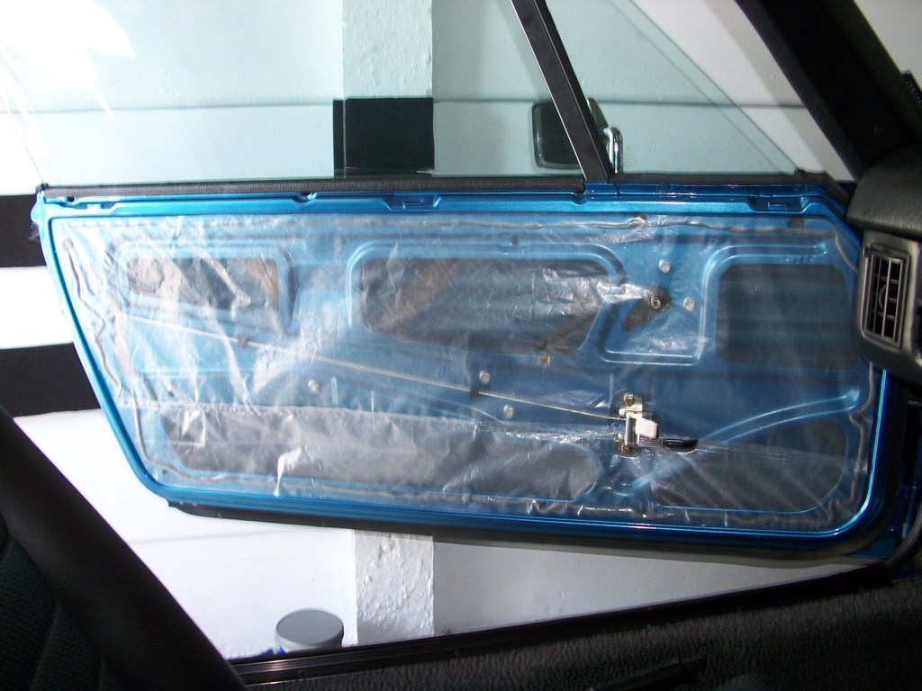

This morning I gave the door cards another clean and got the door damp proof membranes (or what was left of them out of storage)
One was reasonably intact but the other was shredded and half missing. The only option was to make new ones.
At lunch today I hunted down some new plastic sheet to make the door membranes. One little tip I’ll share from having been down this route many times is that VW & Porsche membranes have a “flap” that is heat welded onto the membrane which allows the water/moisture to run into the door and not out between the bottom of the door card and door. The membrane is a particular type of plastic and my top tip is to use the plastic off a new mattress (that has the ends heat welded). At lunchtime I called in at the local Bed Store and asked the manager for some mattress plastic. When they deliver beds they usually take it away for the customers so to them it’s just waste back at the store and they’re glad to give it you!
This evening using the best remaining membrane I marked out two replacements and cut them out.
(IMG:http://www.914world.com/bbs2/uploads_offsite/i265.photobucket.com-18255-1464670548.39.jpg)
The holes for the window winder spindle were punched out and two strips about 8” wide cut from the spare plastic to make the flaps.
The trickiest bit next is to heat weld them onto the full size membrane. From the look of the originals this was done by passing it through two heated metal wheels. Now I could have made a jig/tool to fit on the end of my soldering iron, but having done this before the quickest and easiest way is to use the soldering iron bare.
Heating it up fully I used some scraps of new plastic to trial the pressure and speed of drawing the soldering iron over the plastic. Not too slow to melt clean through and not to fast to just melt one sheet and have no joint. A small allowance to slow as you draw is required as the iron cools with prolonged contact.
With a metal sheet laid flat on my bench and some trial scraps I perfected the plastic weld before moving onto the new door membrane.
The flaps were neatly welded on giving about a 40mm overhang along the bottom as per the original.
(IMG:http://www.914world.com/bbs2/uploads_offsite/i265.photobucket.com-18255-1464670548.40.jpg)
Finally I trimmed off the ends to finish the new membranes. (old is vertical to left, new are horizontal to right)
(IMG:http://www.914world.com/bbs2/uploads_offsite/i265.photobucket.com-18255-1464670549.41.jpg)
It’s also worth pointing out that the welded on flap sits against the door card and the full sheet sits into the door bottom so that any water doesn’t get trapped in the horizontal weld and run to the sides and wet the door card.

This evening after work I started on the interior door furniture. I’d put the parts into storage straight from stripping down and they are in a bit of a state.
I began by taking apart the drivers door pocket, lid, and frame. I took everything apart and gave it a good scrub with Cif and hot water. The pocket/cubby has a flock finish on the inside on top of the pressed cardboard base. This was absolutely shot, scratched and worn mostly off and covered with years of grime, sticky stuff and sand. The only solution was to strip off the remaining flock with a detail wire brush.
(IMG:http://www.914world.com/bbs2/uploads_offsite/i265.photobucket.com-18255-1464670549.42.jpg)
While the card base was slightly damp from washing I clamped the lower edge in the vice between 2 bits of timber to “press” it back into shape before leaving it to dry.
The top hinged armrest lid and frame were next to get a Cif scrub, followed by the passenger side armrest.
With everything left to dry I cleaned up all the screws, bolts and cup washers that hold it all together with a brass wire brush before running out of light.
Having a rummage in one of my sheds I found an old flocking kit that I’d got left over from another cars restoration, so tomorrow I’ll re do the inside of the drivers door cubby and hopefully get everything sorted for a door interior rebuild at the weekend.
Day 241
This morning I coated the inside of the cubby with the flock paint/adhesive and then sprayed on the static charged nylon fibres which stand upright in the adhesive to create a new flock coating.
(IMG:http://www.914world.com/bbs2/uploads_offsite/i265.photobucket.com-18255-1464670549.43.jpg)
With the camera flash you can see the flock fibres more clearly.
(IMG:http://www.914world.com/bbs2/uploads_offsite/i265.photobucket.com-18255-1464670549.44.jpg)
The process takes a good few hours to dry, which was ideal as I then left for work.

Good timing, it was a replacement Right hand door pull/armrest with a perfect plastic cover surround for the top mounting bolt. My original has the cover completely missing so you see the metal tab and bolt. Unfortunately you can’t buy just the oval plastic cover as it comes as part of the armrest! I’d tracked one down on US ebay which claimed to be in perfect condition and also managed to get a good price on a multiple purchase of an excellent RH speaker grille too. (Thanks Ron if you read this)
As always I had a hefty customs charge of £40 to pay which really does annoy me, but hey, no one likes the taxman.

This morning the flock had dried completely so I re-assembled the door cubby before leaving for work.
(IMG:http://www.914world.com/bbs2/uploads_offsite/i265.photobucket.com-18255-1464670550.45.jpg)

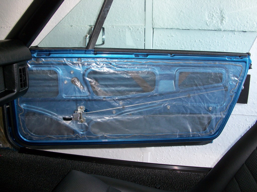

To take my mind off it, I retired to the garage and fitted the door damp membranes I’d made earlier before running out of daylight.
Carefully checking everything inside the door was tight, I used caulking rolled into a thin strip to attach the plastic. In this way they can be removed numerous times and resealed if I ever need to get back inside the doors. The caulking is like a very sticky Blu-tack so is great for this purpose.
(IMG:http://www.914world.com/bbs2/uploads_offsite/i265.photobucket.com-18255-1464670550.46.jpg)
(IMG:http://www.914world.com/bbs2/uploads_offsite/i265.photobucket.com-18255-1464670550.47.jpg)
Perfect fit with the doubled up heat welded flaps tucked neatly inside the door so any water runs into the door and not soaked up by the door card.

90% of the interior is restored and back in, and the car is starting to look real pretty.
Again it’s been a rollercoaster of highs and lows. Things didn’t go to plan, my friend breaking the windshield, the trimmers continually having trouble with the knee roll and issues with parts. On the flip side with a little perseverance as a whole the car looks fantastic and much better than hoped for.
With just a handful of months left now in this 12 month build challenge I feel that the light at the end of the tunnel is near and I cant wait to finally get to drive it!
