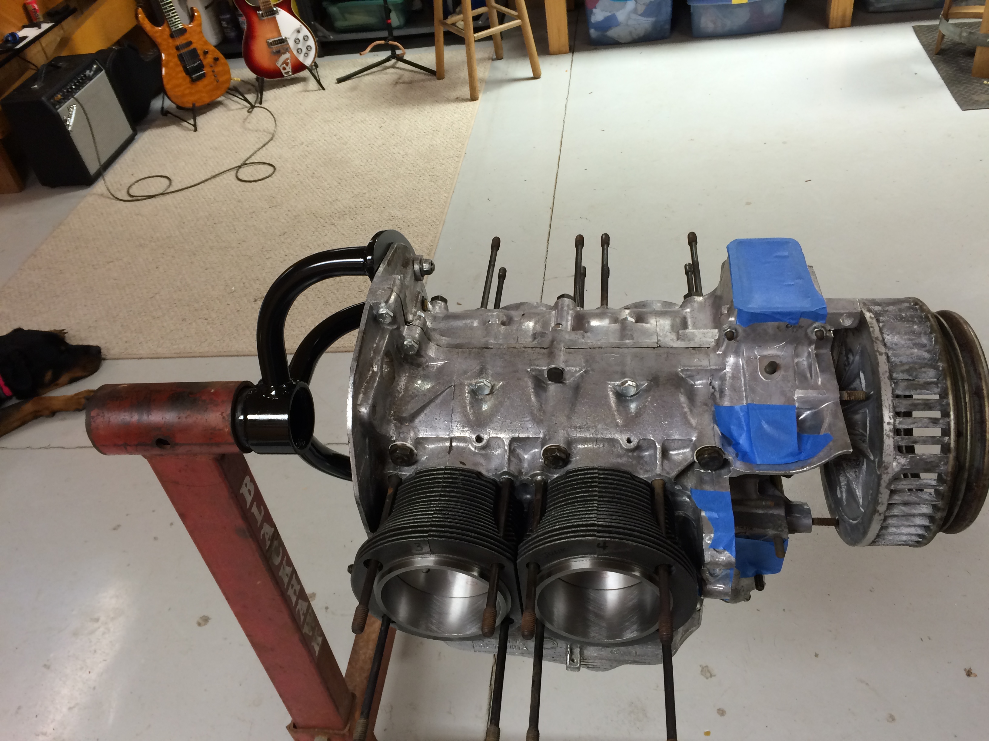

And finally on side goes together (sort of still). I mangled one of the oil scraper rails so need to make an order before I do the other side. For now this is loosely bolted up with spacers and I will return to it when I get back from a week's worth of travel for work.
I still hate the spiral-in wrist pin retainers. No one can change my mind on that.
Have I mentioned that I hate the new spiral-in wrist pin retainers?

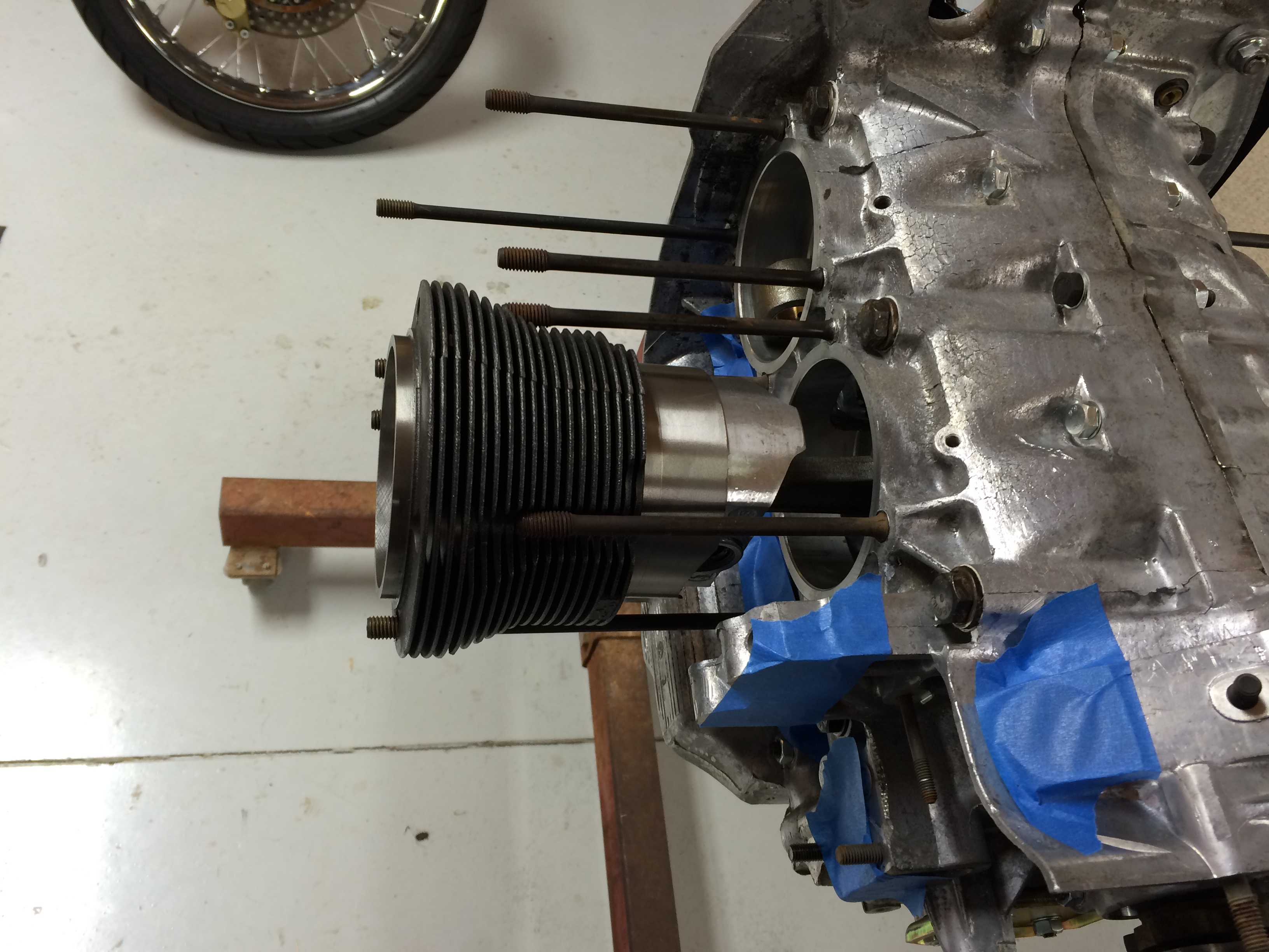

sdoolin   More progress. Have spent the better part of a wee...   Apr 28 2016, 06:42 AM
sdoolin   Never drop a brand new cylinder (or any other cyli...   Apr 30 2016, 10:41 AM
wndsrfr   Never drop a brand new cylinder (or any other cyl...   Apr 30 2016, 07:25 PM
sdoolin   Never drop a brand new cylinder (or any other cy...   May 1 2016, 07:38 AM

stugray   Nice setup for trimming. I wish I had a machine sh...   May 1 2016, 10:43 AM
sdoolin   Stugray - I agree about trimming the jugs. I asked...   May 2 2016, 06:27 AM
sdoolin   Thanks wndsrfr. Let me know what the shipping was....   May 4 2016, 10:11 AM
wndsrfr   Thanks wndsrfr. Let me know what the shipping was...   May 5 2016, 10:20 AM

sdoolin   Finally made a little more progress. My dropped cy...   May 30 2016, 06:49 PM
sdoolin   And finally on side goes together (sort of still)....   May 30 2016, 06:58 PM
