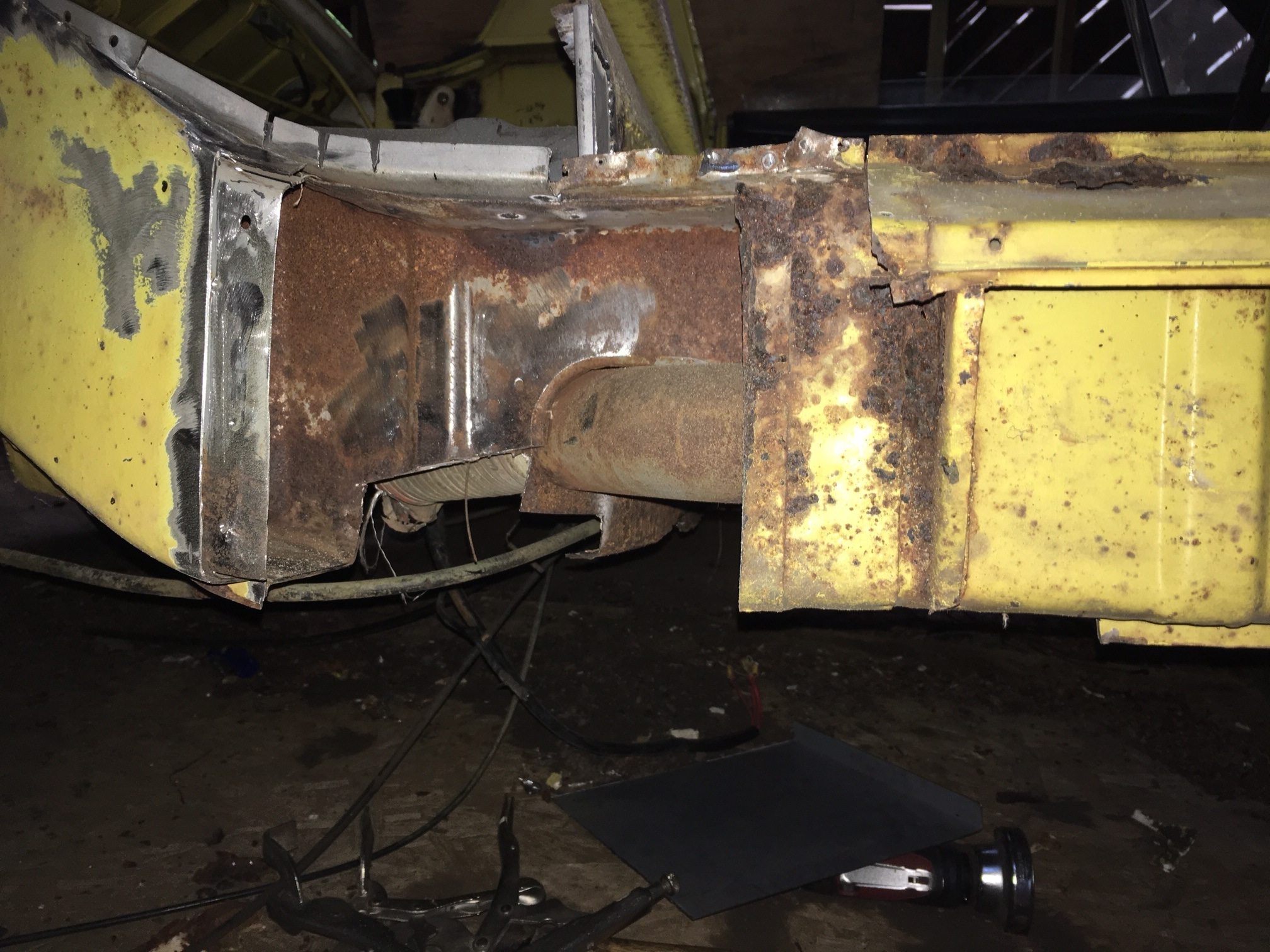

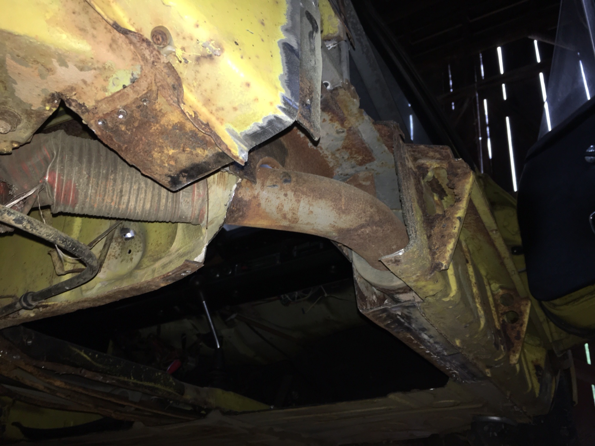

Here's the underside of the passenger long. I was able to jack the car up and door gaps didn't change (IMG:style_emoticons/default/piratenanner.gif) .... Heck, most 914s I bring home don't even have a place to jack it up anymore.

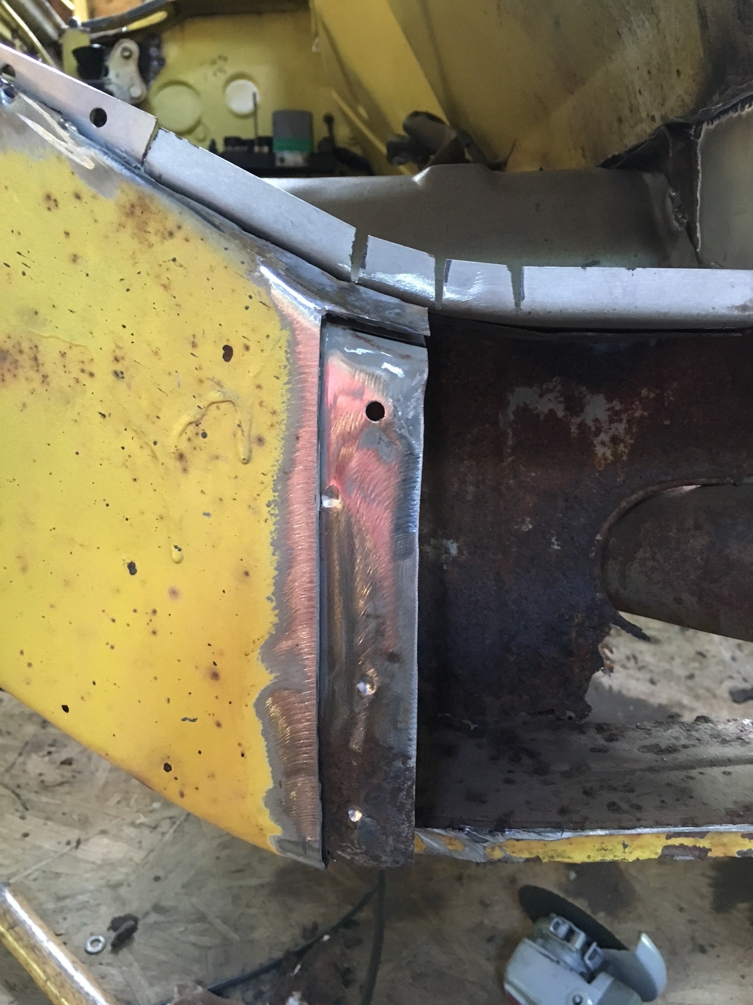

I tore into the long tonight. I first braced the door opening before making any cuts. In total I had to cut out about a 14 inch section of inner long.

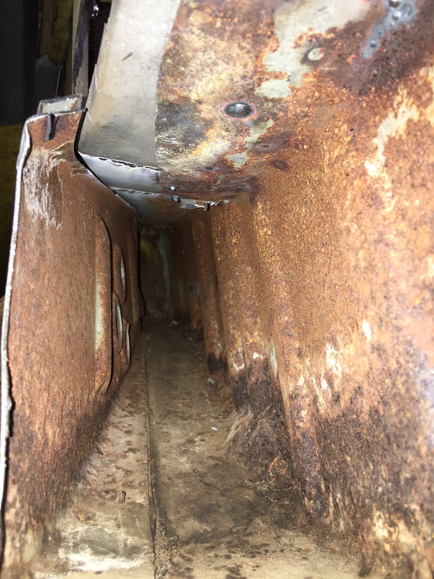

The rest of the upper long doesn't look bad from the inside. The whole long will be treated with Ospho and painted before closing it up.
When cutting out the outer long I made sure to leave a section of "inner" material to tie into later for added strength.
