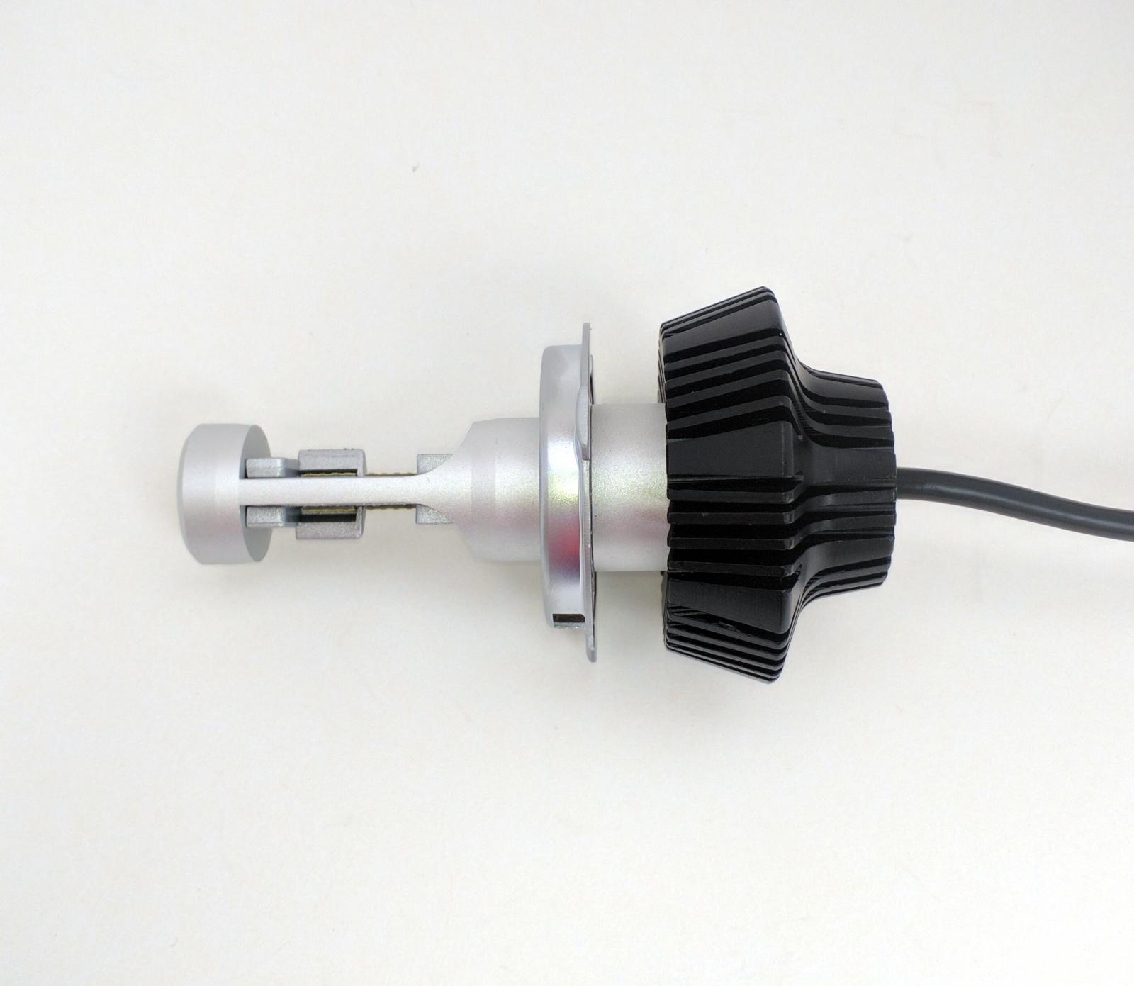

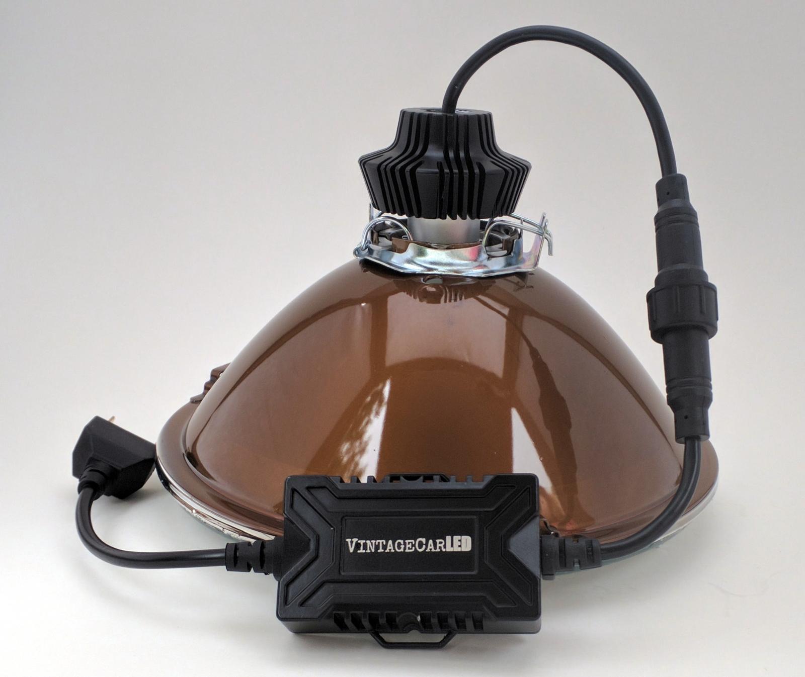

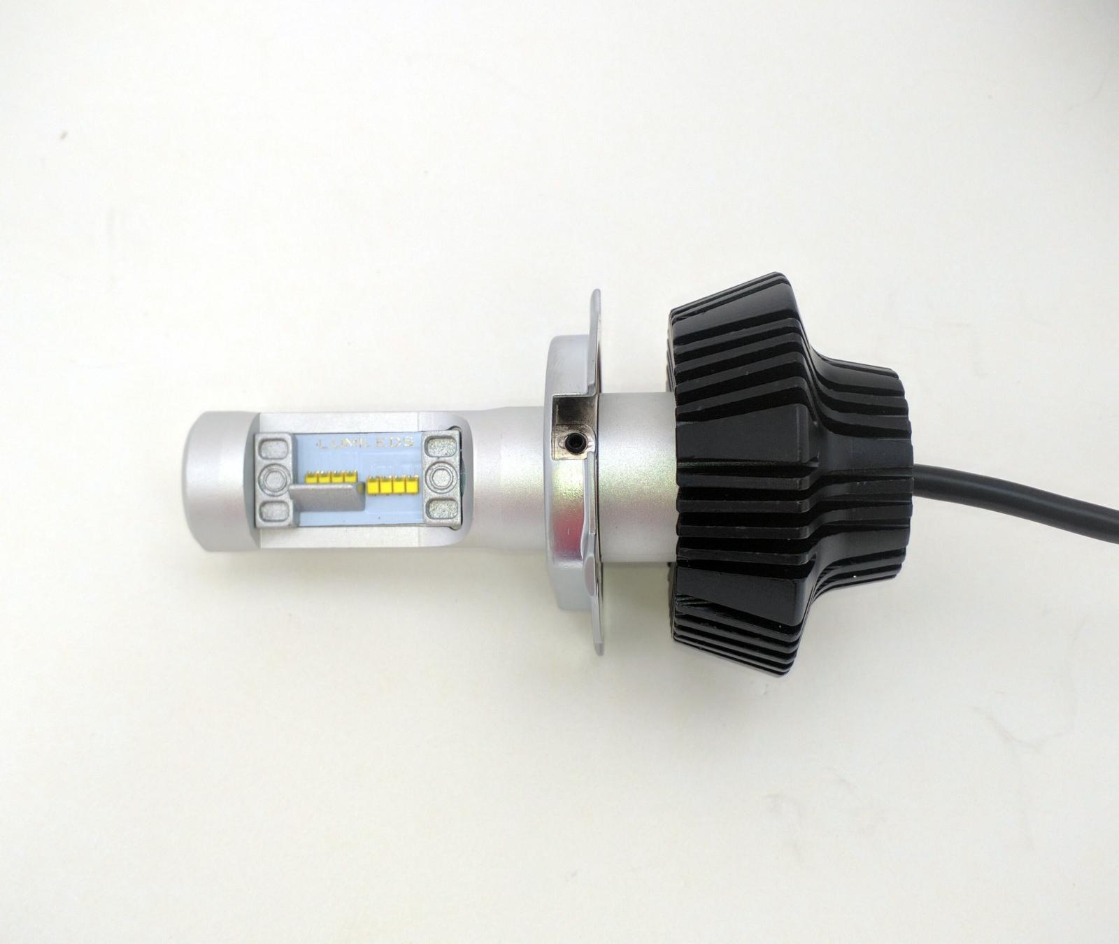

Hi guys, If you have any questions about our products, you can call or email us anytime.
thomas@vintagecarleds.com
713-882-0721
Our VC4000 LED headlight kit uses a 100% glass DOT lens (no yellowing), with a LED bulb, and passive heatsink.
We also have a lifetime warranty on all of our headlight kits we sell.
If you look at our VC4000 bulb, you will notice the LEDs on it are arranged just like the filaments in a standard halogen, which give our bulbs/lenses paired together a fantastic beam pattern.
