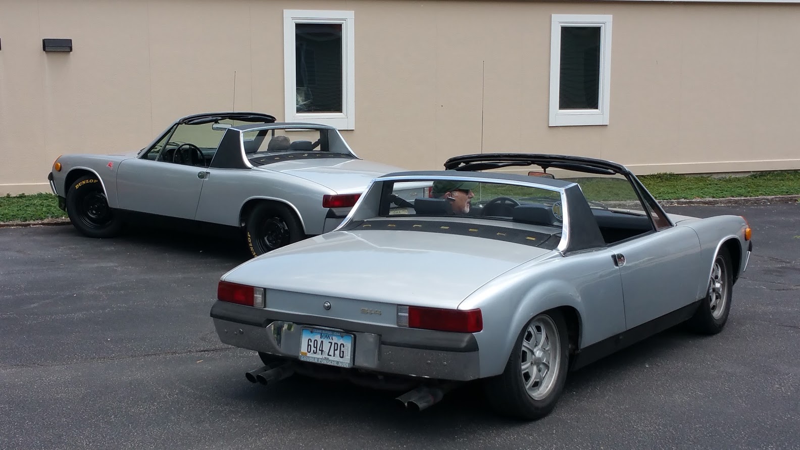

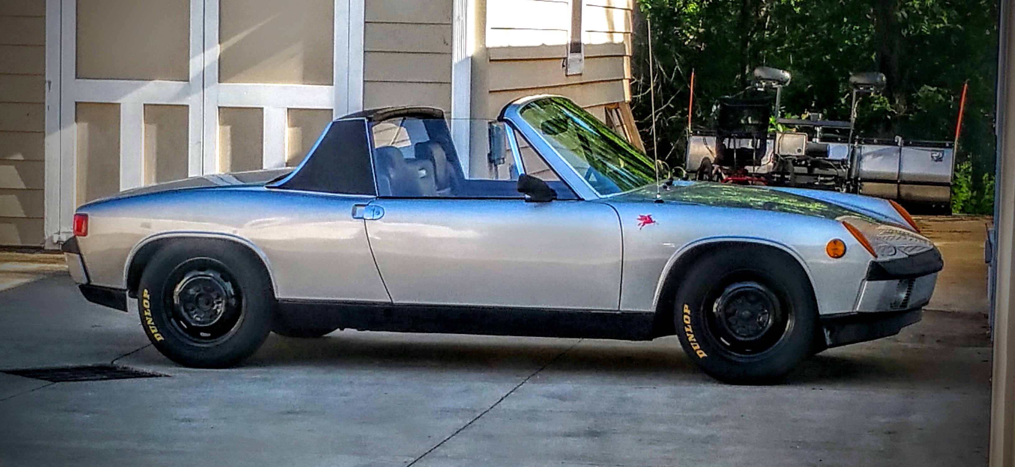

Just a quick follow up. I got my brakes bled properly after installing a new master cylinder. Now I can lock up my wheels. A GREAT feeling, which made a proper shakedown drive possible. After a few days my shifter started acting up. I couldn't get into 2nd or 3rd, it went right into 4th from 1st. With the knowledge from rebuilding everything I knew to look at the cone screws to see if one had come loose. Sure enough the one way at the back was loose and the rear shift rod was rotating in the coupler at the side shift module. I reinstalled it with some blue loctite (and did the same to the front one for good measure) and all is well. It still shifts great. I've been tearing around town in this little go kart for the past week and loving every minute of it. Here's a couple pics of the car, along with a friend's 1971 914. He's the original owner. He's my dad's age, and used to take me for rides in this car when I was a kid. Great memories. Thanks again to everyone who helped me out here, especially Dr. Evil and his invaluable video.
