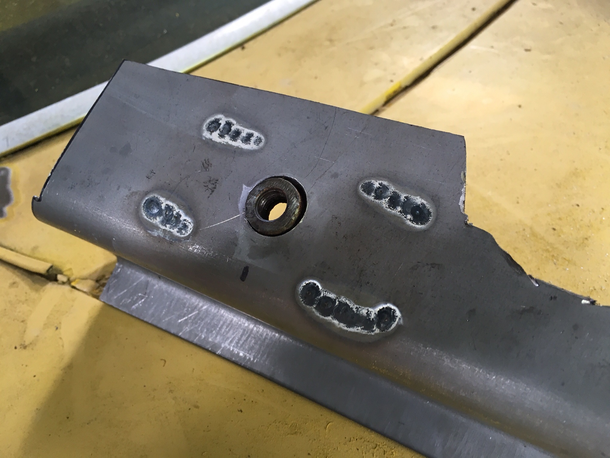

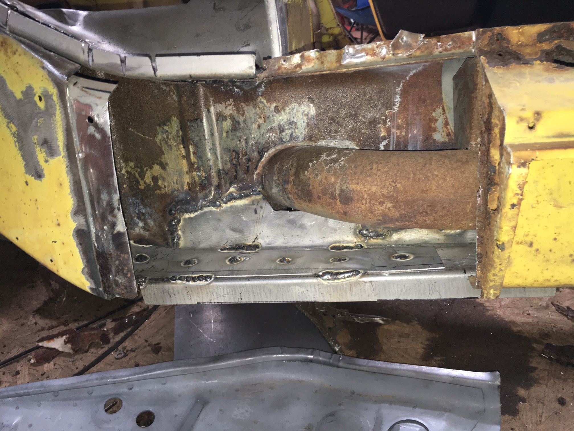

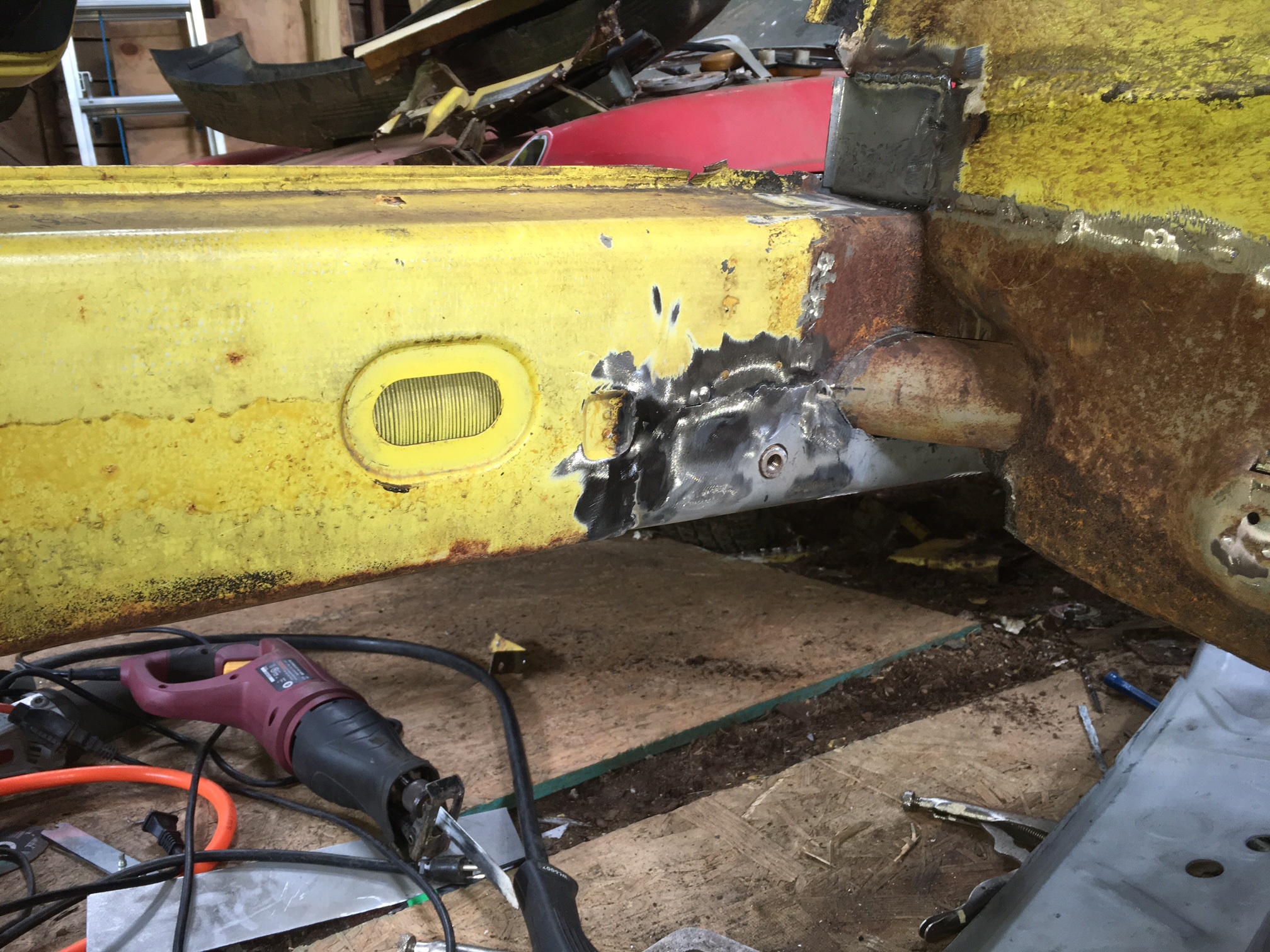

dlee6204   I tore into the long tonight. I first braced the ...   Jun 1 2016, 06:43 PM
dlee6204   Got my inner long welded in. :welder:   Jun 6 2016, 04:07 PM
