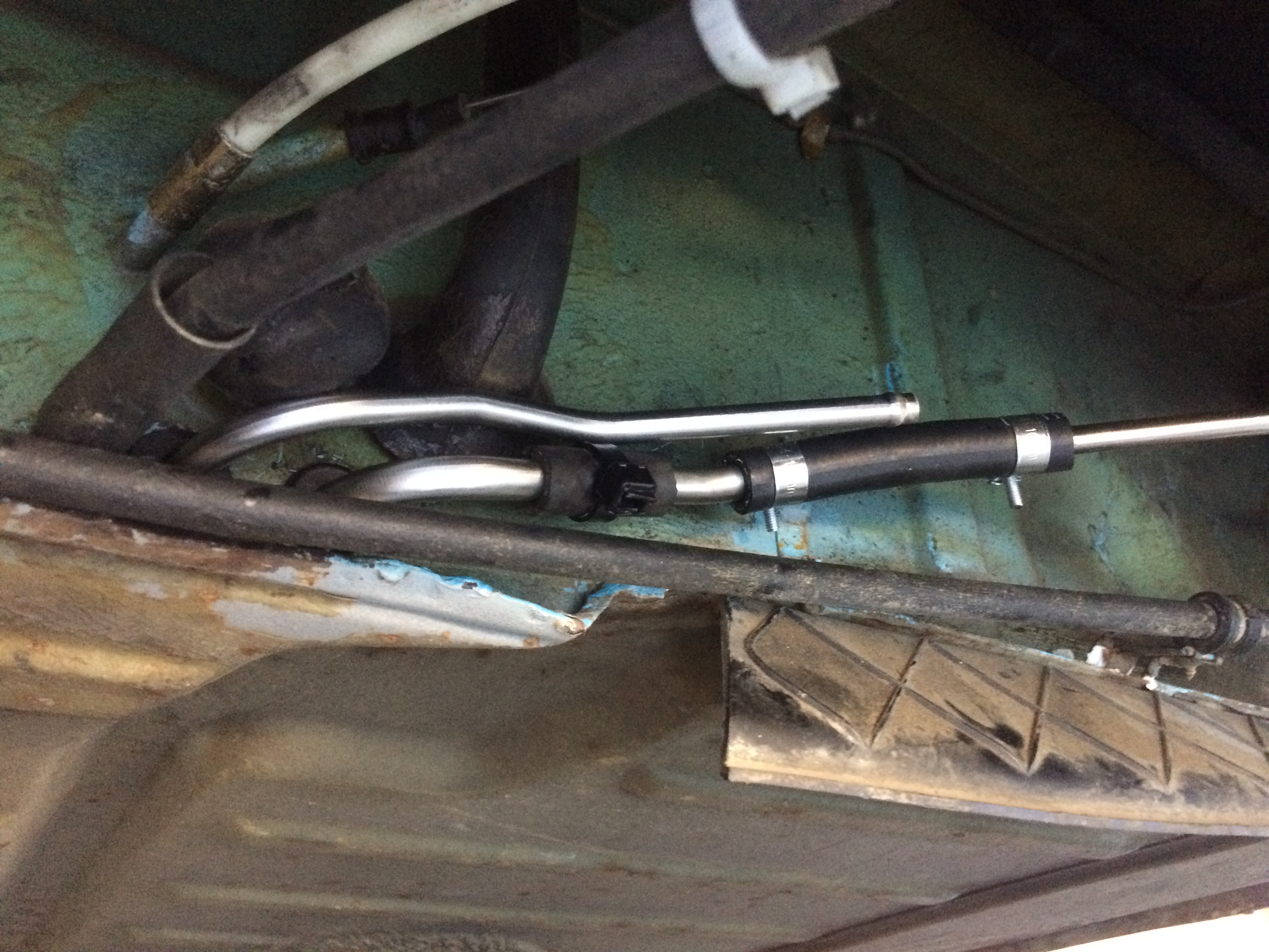

I just installed SS fuel lines from Tangerine Racing and a new Bosch 69133 fuel pump that I bought on Amazon for $72. Fuel lines can be installed with the engine in place (by a non-mechanic; if I can do it, anyone can). Wix 33274 or Purolator F23175 fuel filters both work and are available at Amazon for under $10.

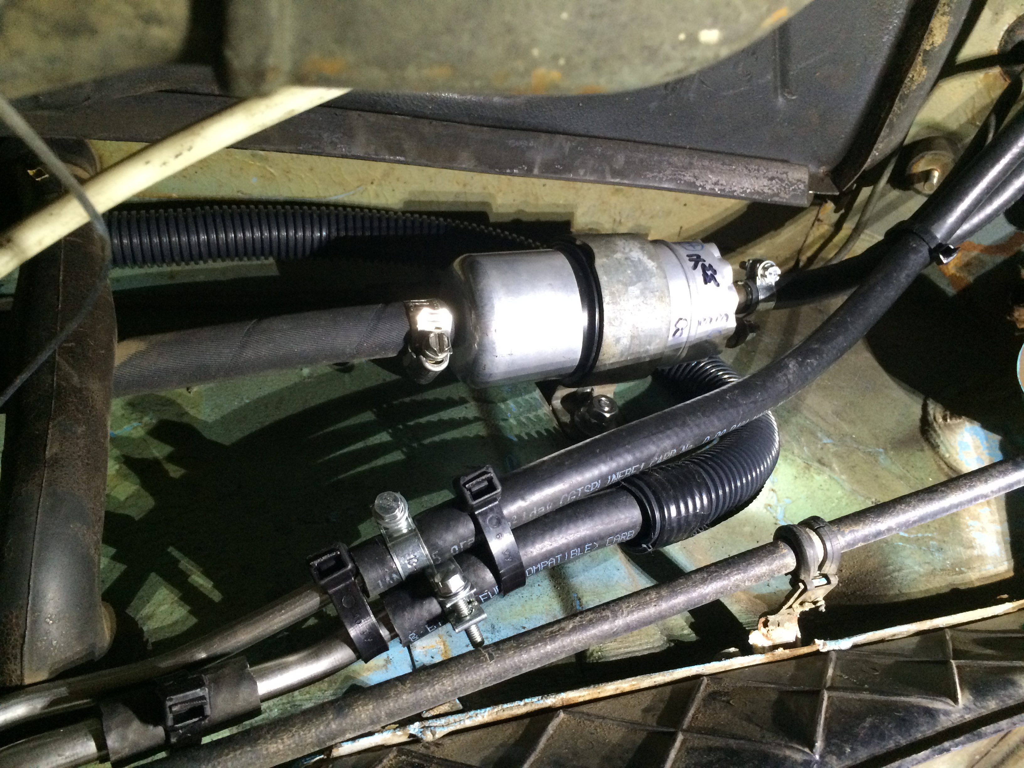

Rathguten   Thanks! Now being that there are three ports o...   Jun 7 2016, 10:01 PM
napasteve   Yes, just remove the spliter so the return line is...   Jun 8 2016, 08:18 AM

Rathguten   Well today I braved 100+ degree heat and installed...   Jun 18 2016, 05:27 PM
