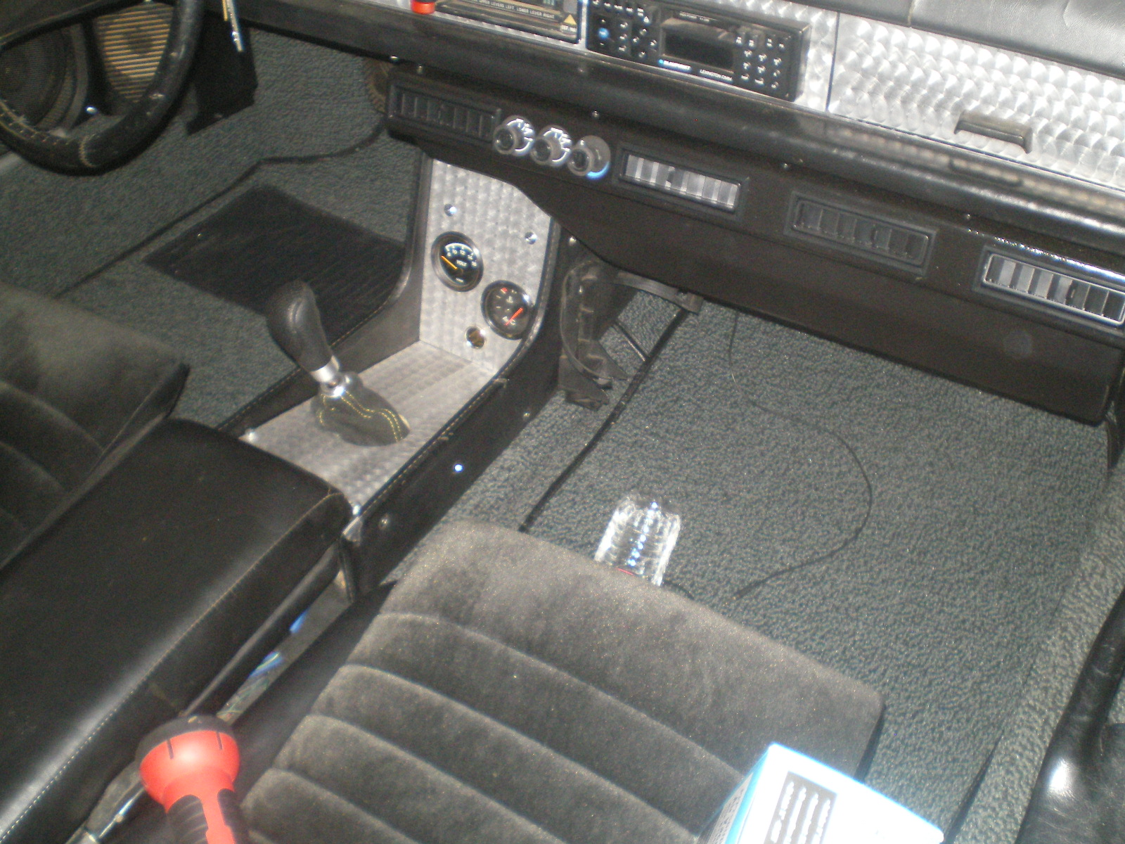

I am working on a Subie conversion and am trying to figure out AC. I live in the desert (Phoenix) so AC will add a lot of usability to the car. Ideally I would like to blow air through the existing vents. I have searched a lot on the forum and see a lot of starts, but few functioning units. I am traveling to Texas today so I am going to check out Vintage Air and Old Air Products to see what products they might recommend for me to modify. Plan two is to hit the Pick and Pulls and search for the most compact evaporator I can find.
Any help or general suggestions is greatly appreciated.
