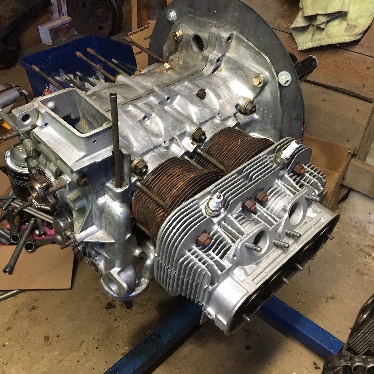

First, got one side of the engine done with P/Cs and head.

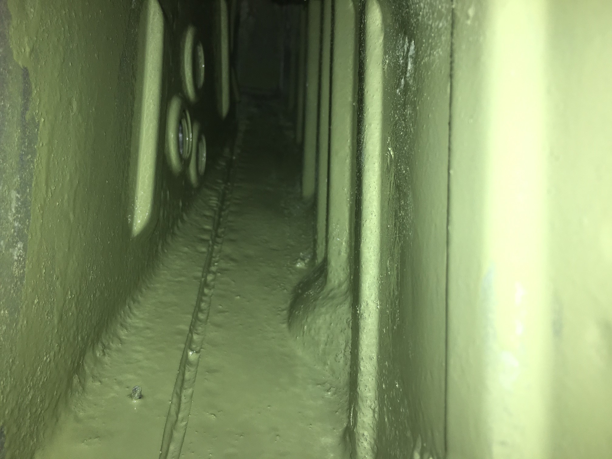

I also coated the inside of the upper long on passenger side. I first treated it with two coats of Ospho and then some internal frame coating. The outer section has already been fitted now I just need to weld it on. Pics to come.

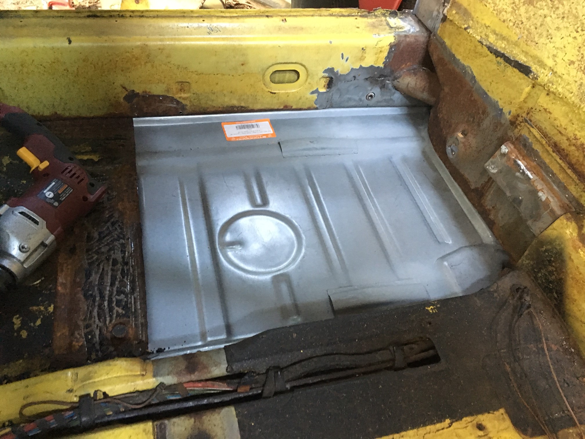

Finally I started prepping for the floorpan. Its currently held in with some self-tapping screws. There are a few areas around the lower firewall that I have to repair before I install the pan but its getting close! Those seat brackets will also be modified to fit the non-adjustable passenger seat.

dlee6204   Started on the floorpan. I first had to trim my f...   Jun 26 2016, 02:38 PM
dlee6204   And floor pan is welded in. I still have to do al...   Jun 26 2016, 02:41 PM
