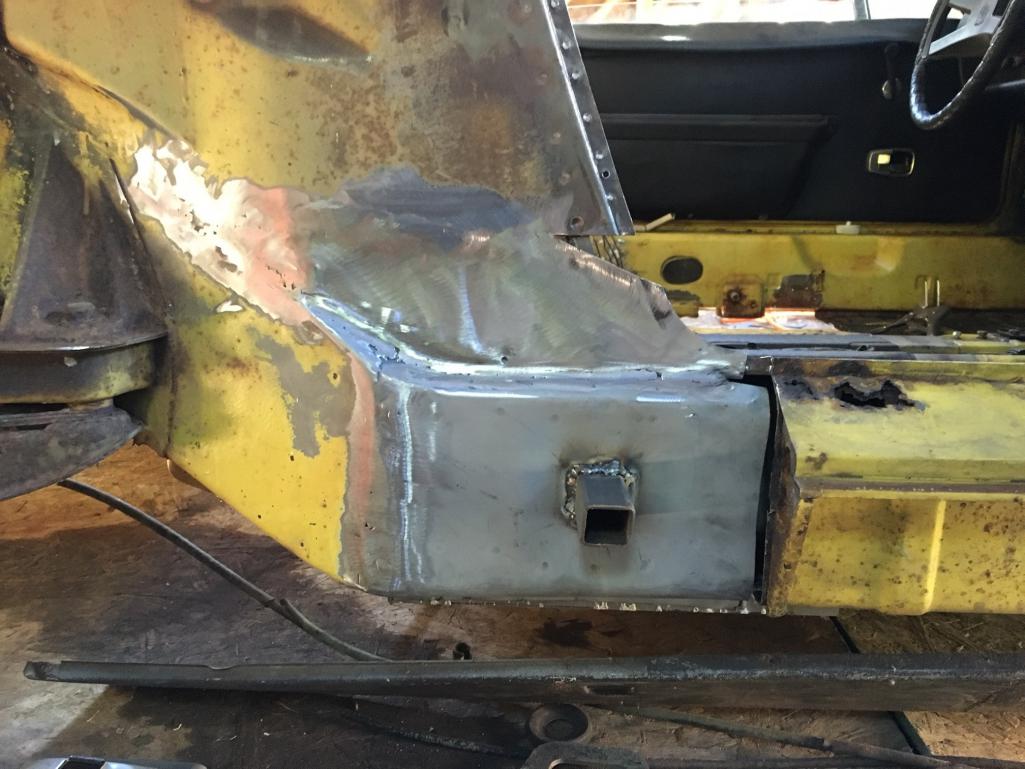

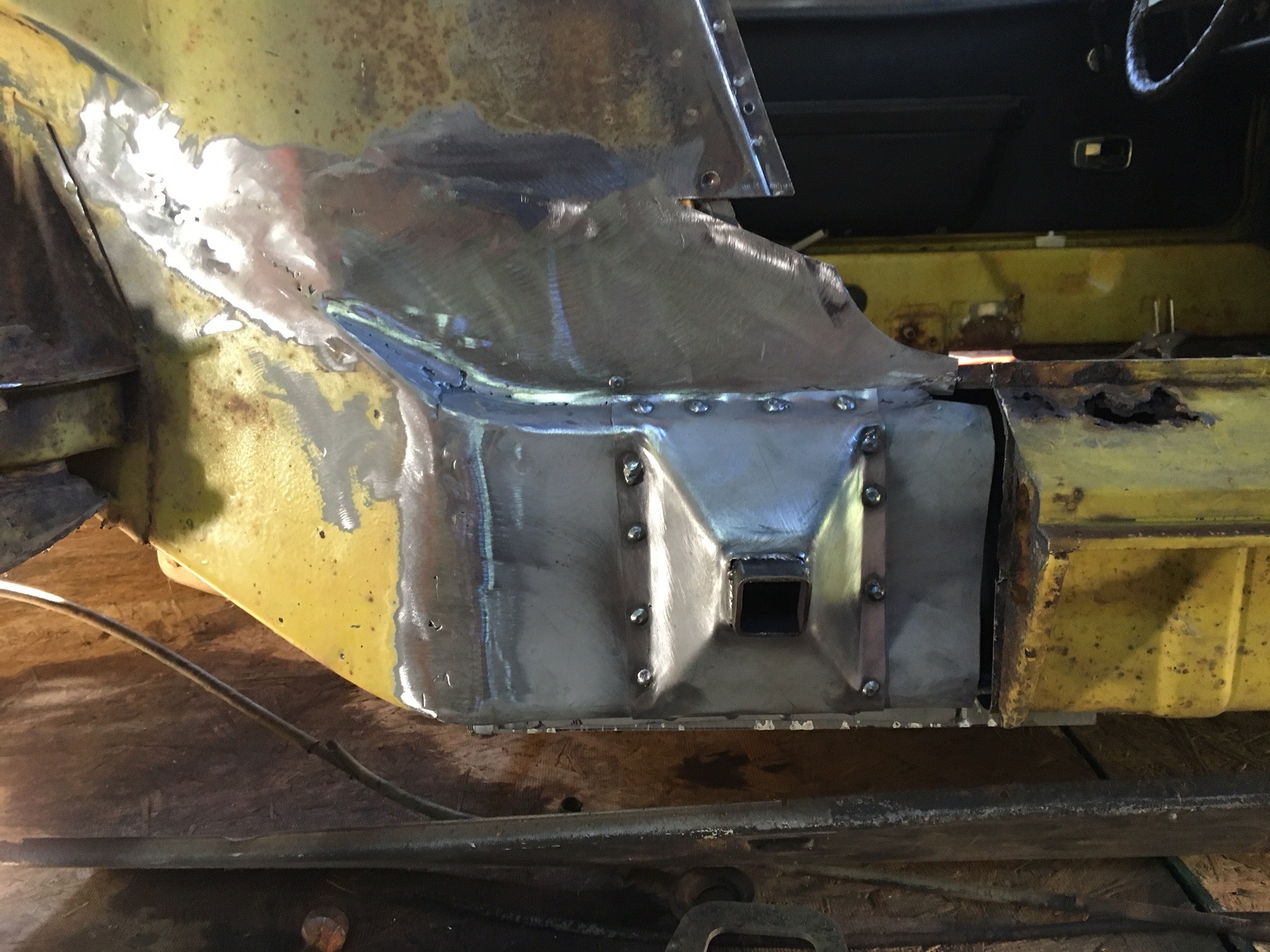

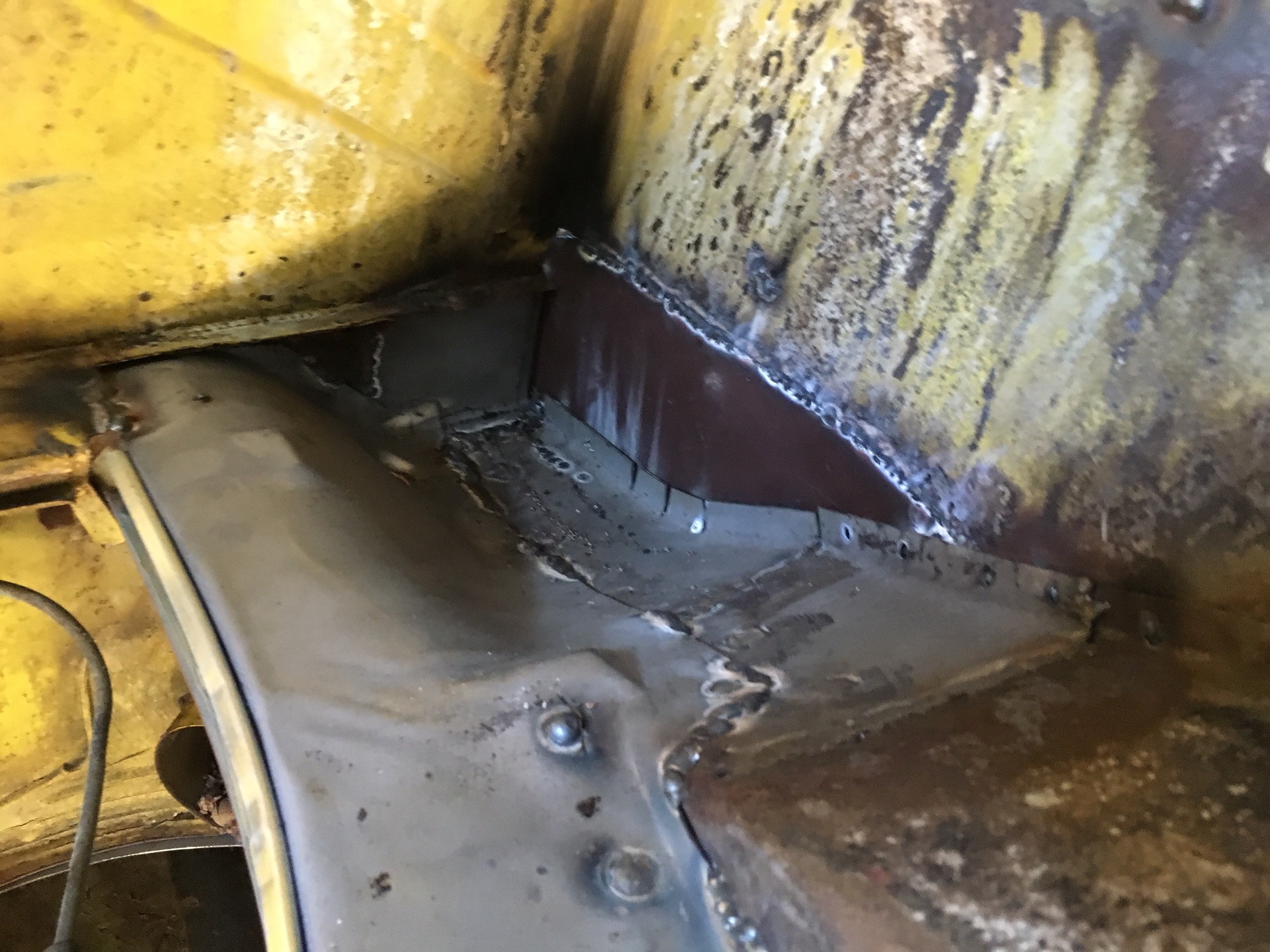

Got the upper part of the long installed and the jackpoint. I have a few welds to do in the "hell hole" and then I can install the battery support and tray. (IMG:style_emoticons/default/piratenanner.gif)
No more hell hole
