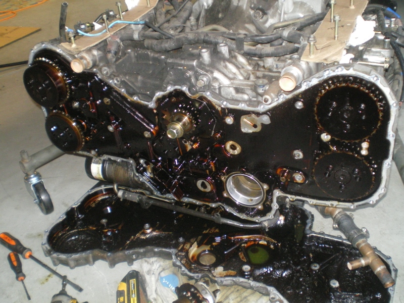

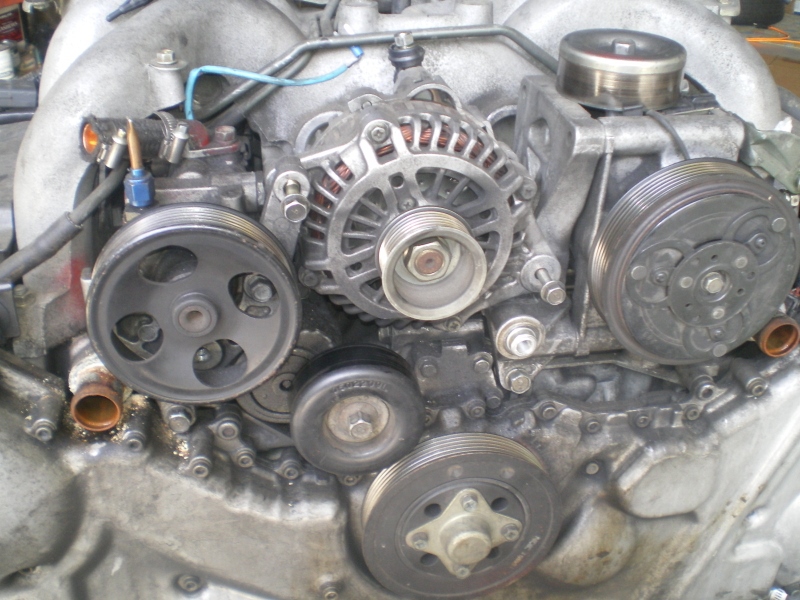

Thx for the video Jim but mine is a six. I do have the factory manual which is super! So this is what it looked like fully dressed sans the idler laying on top.

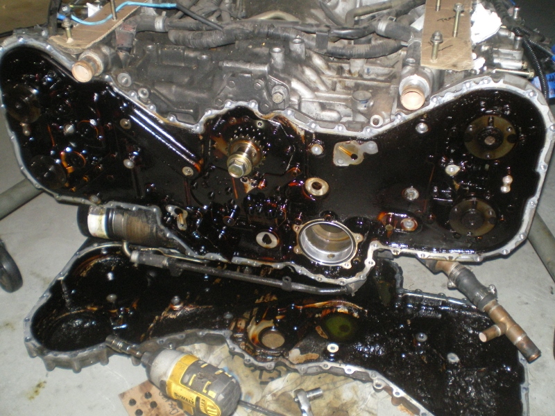

And with her bra off (IMG:style_emoticons/default/happy11.gif)

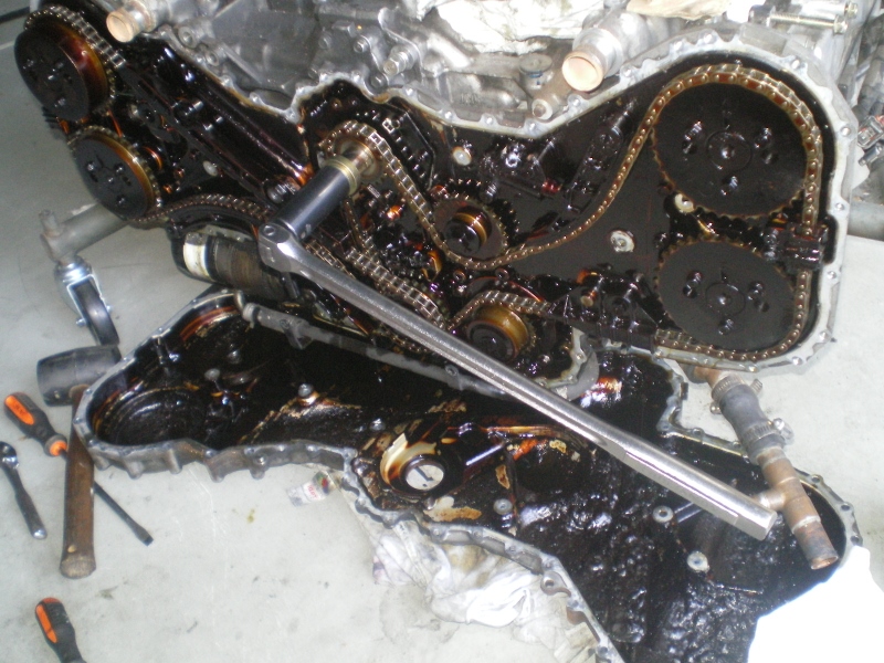

Stripped off her chains

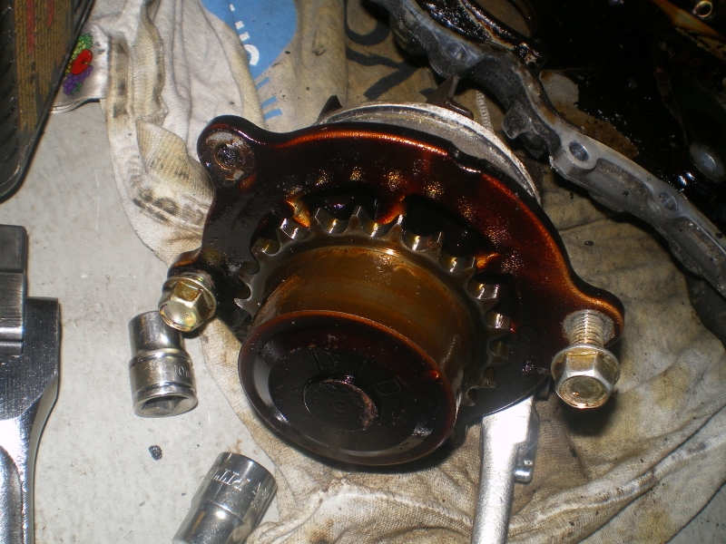

A peek inside the water pump housing. Take a close look a see that the 4 bolt holes are 6mm. You can also see the thermostat in the background.

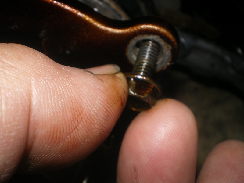

Now look at the size of the holes on the flange of the water pump. They're 8mm and 2 of them are tapped. Once you unscrew the 4 6mm bolts that hold the pump in place you still need to get it out. All you need are 2 8mm bolts that thread into the flange and push against the case. Then you just tighten each a little and walk it out. No "pulling or prying or crying or cussing". 15 seconds and out. Brilliant! Gave me a DUH moment when I thought about it. Why aren't similar pumps all engineered like this?
Here's one showing the smaller screw against the larger hole in the flange.
