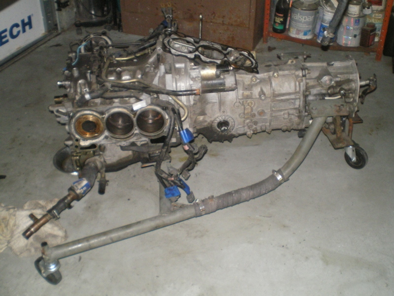

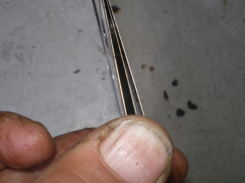

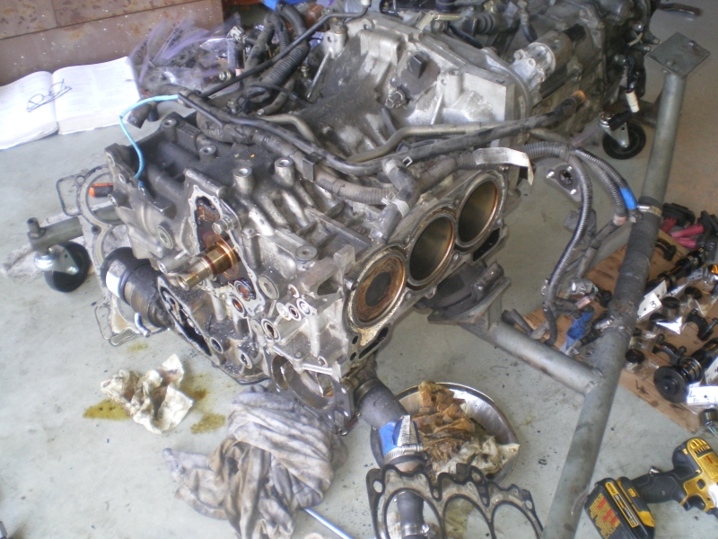

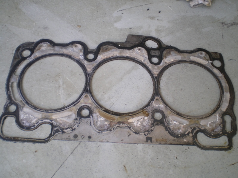

OK, this is what I was referring to when I said the head gaskets "kind of" looked OK.
But is this normal? This small area appears to be "DE-lamenating" compared to the rest of the gasket. And this area is dead straight above the exhaust outlet on the left head.
Carnage

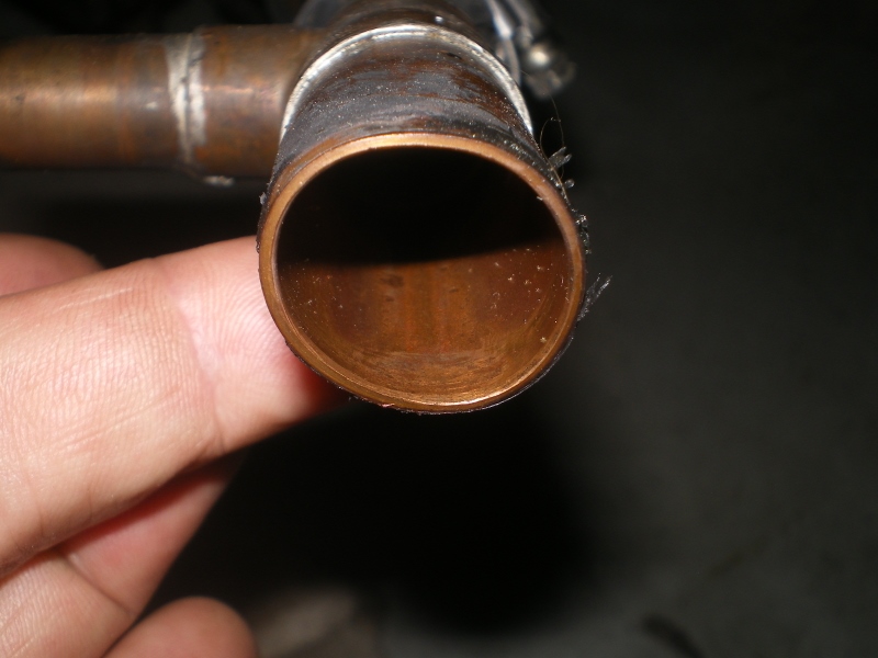

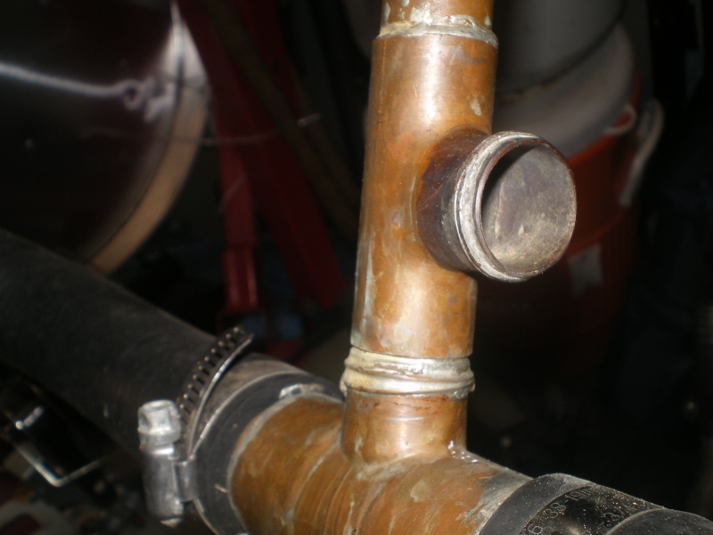

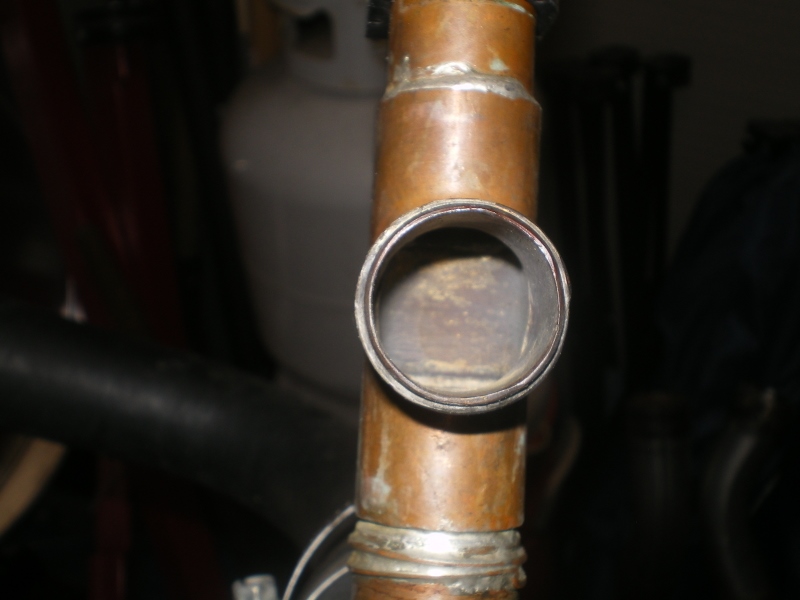

Some's pic showing the condition of 3 copper "plumbing fittings" after almost 2 years 10 mo's in service. As you can see, no apparent damage from electrolysis. (IMG:style_emoticons/default/beerchug.gif)

76-914   OK, this is what I was referring to when I said th...   Jun 12 2016, 10:29 PM
r_towle   See, water = corrosion, just sayin   Jun 12 2016, 11:09 PM

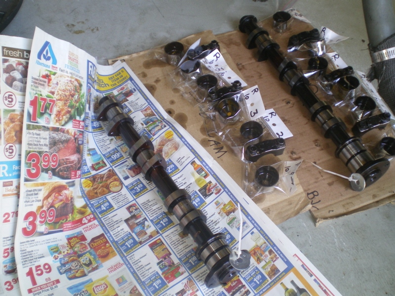

76-914   Finished cleaning except the pan and that can wait...   Jun 29 2016, 08:25 PM
76-914   Since I have to wait a few days for 6ea 8mm allen ...   Jul 7 2016, 07:18 PM
914forme   The right chain still has slack in it as shown b...   Jul 8 2016, 01:39 PM
76-914   Hah! I flew w/o one of those for years until o...   Jul 8 2016, 02:04 PM
