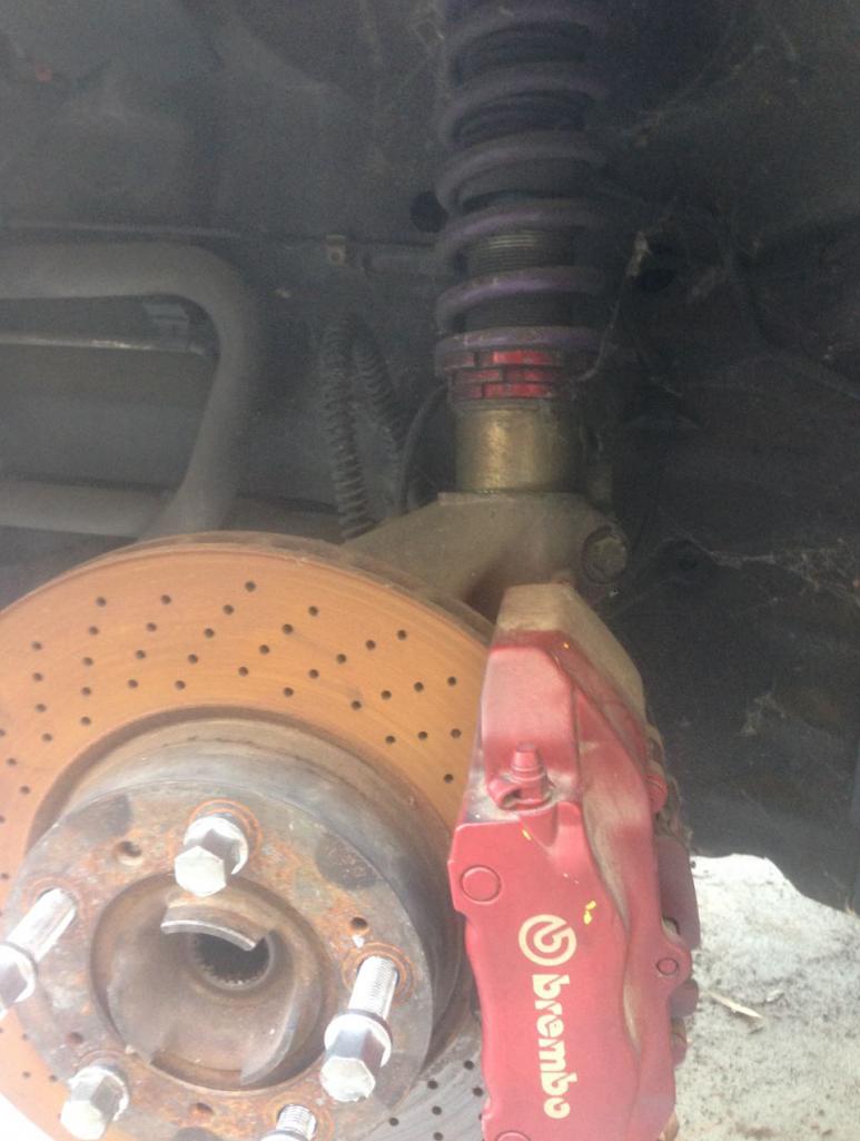

Well since I have to wait until my sand blast kit shows up, I'm taking the front and rear suspension off the 996 to mock up on the 914. Looks like the front will be easy. The rear will require a tube frame. That's OK though since I am planning to tube the rear. I'm planning to pressure wash the suspension this weekend and mock it up on the rotisserie with the car upside down. (IMG:style_emoticons/default/cheer.gif)

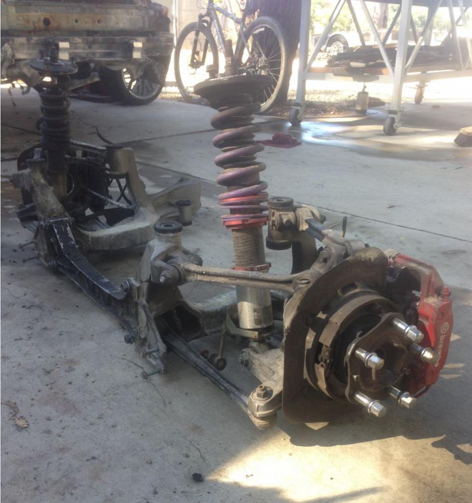

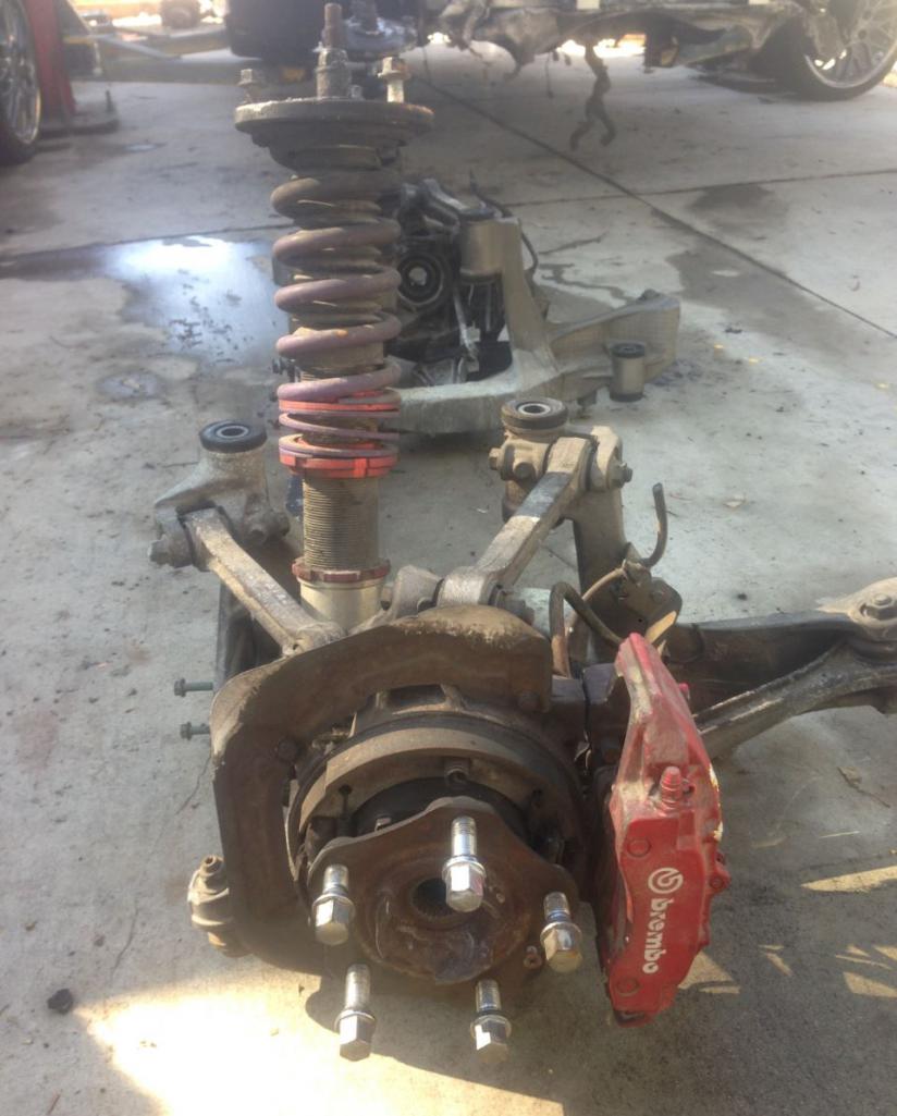

Curbandgutter   And here is the front suspension. I'll be pow...   Jun 17 2016, 07:56 PM
