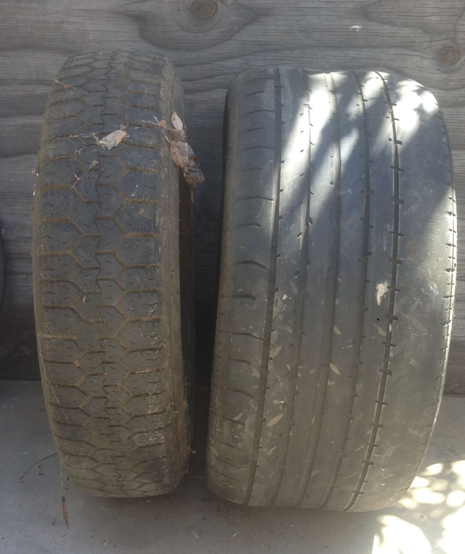

I've really thought it through and finally came to the conclusion that a modified 916 look is what I will do. I will extend the 916 flares enough to cover the 245/18 front tires and 335/18 rear tires. I have thought it through though as I want to stuff the wide tires but I don't want a ridiculous bulge at each corner. I have a couple of tricks up my sleeve to accomplish this though. Also the 996 suspension will make this car to have a 5" wider track in the front and a 4.8" wider track in the rear. It's interesting that the wheelbase of the 914 is 4" longer than the 911?? (IMG:style_emoticons/default/dry.gif)

QUOTE(Curbandgutter @ Jun 17 2016, 09:35 AM) *
whats the smallest wheel that you need to clear the brakes? I would aim for that size. 18s are way too big for a 914. 17 would probably look good with that wide body and still fit over the brakes

QUOTE(2mAn @ Jun 17 2016, 09:57 AM) *
Is it your opinion that it is too big because of your preference or that the wheel is too big and won't fit. If it's just your preference I can respect that. However if you're saying that the wheel is too big then ponder on this. The original 914 wheel rolling diameter for a 914 is 25.4" the 335/30-18 rolling diameter is 25.9"??? Also as they say a picture is worth a thousand words see the attached picture which shows a stock 914 wheel next to a 265/35-18. As you can see that tire is shorter (it is under inflated), however it's rolling diameter calcs out at 25.3 in. Am I missing something?

QUOTE(Curbandgutter @ Jun 17 2016, 10:18 AM) *
Thats a preference thing for sure.
I run 18's rear and think it looks great. I personally prefer 17's in the front though as to have a little better ride quality.
