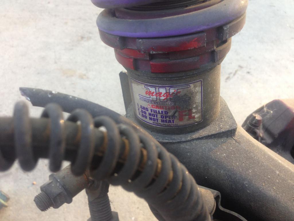

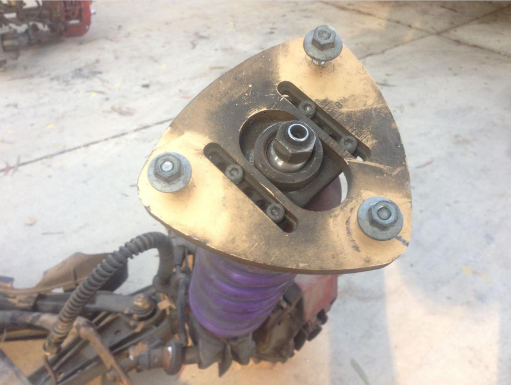

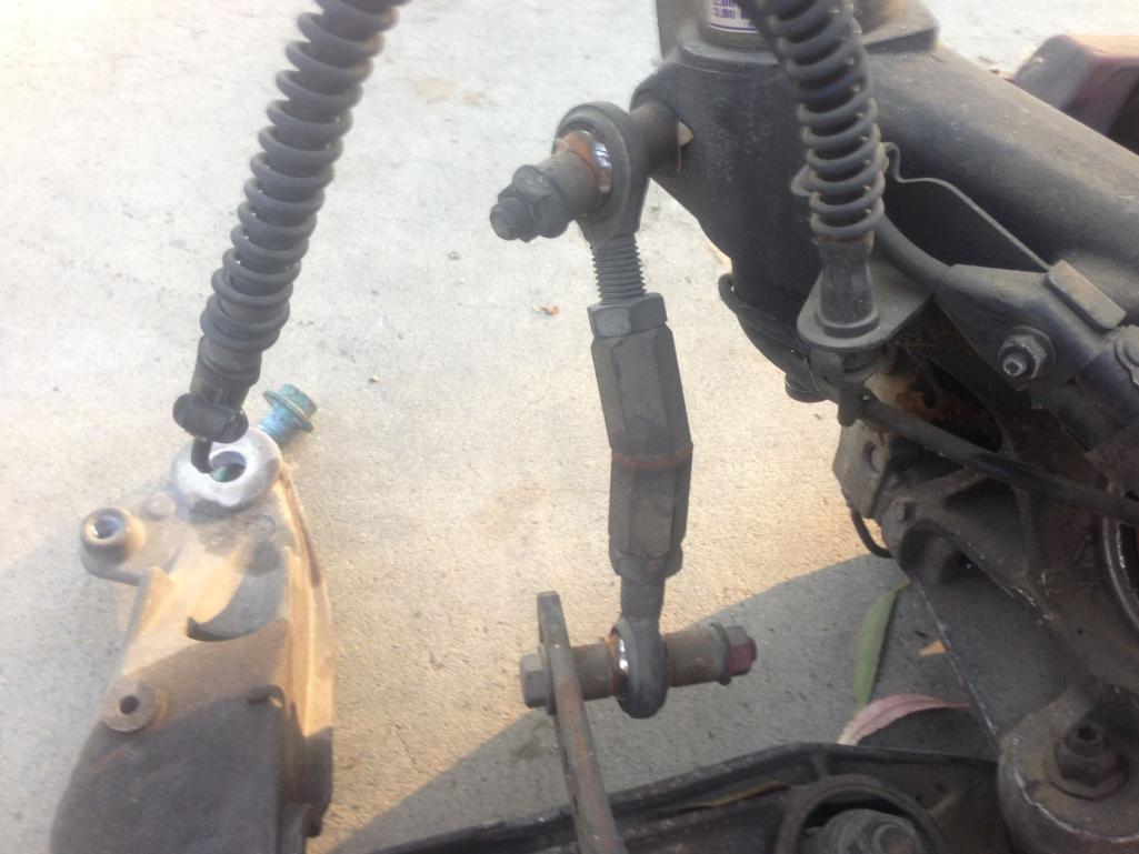

87m491   Wow, a ton of adjustment (and adjusters!) on t...   Jun 17 2016, 09:52 AM

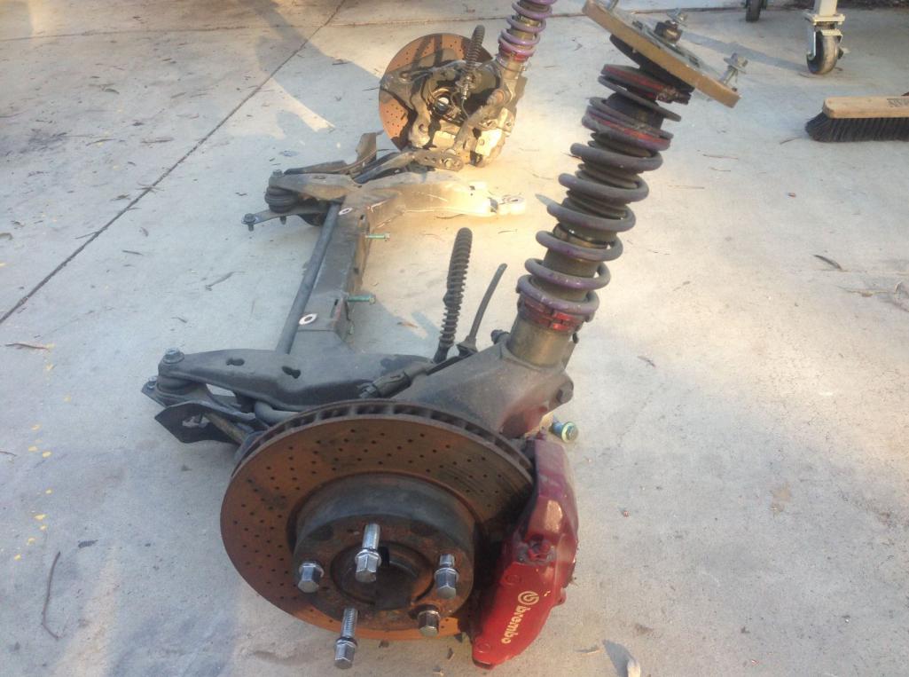

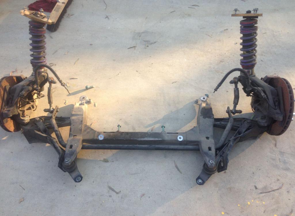

Curbandgutter   And here is the front suspension. I'll be pow...   Jun 17 2016, 07:56 PM
