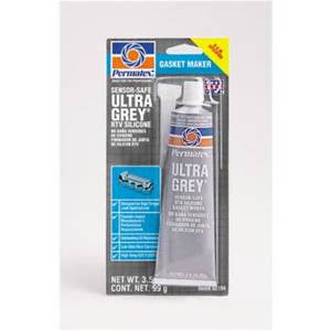

Hey get some of this for the oil pump. It's pretty good sh&t. Very similar to that Honda stuff. RTV with vibration resistance.
You might have it already.
