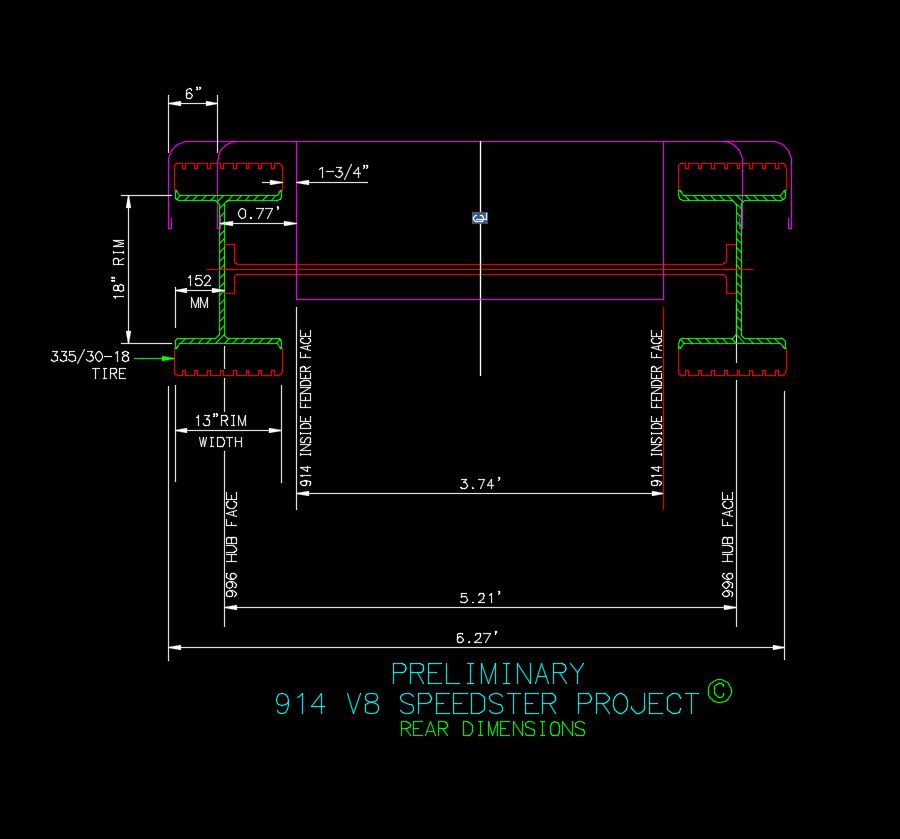

Here is the mock up of the rear suspension along with some measurements and an Autocad drawing of the rear end.

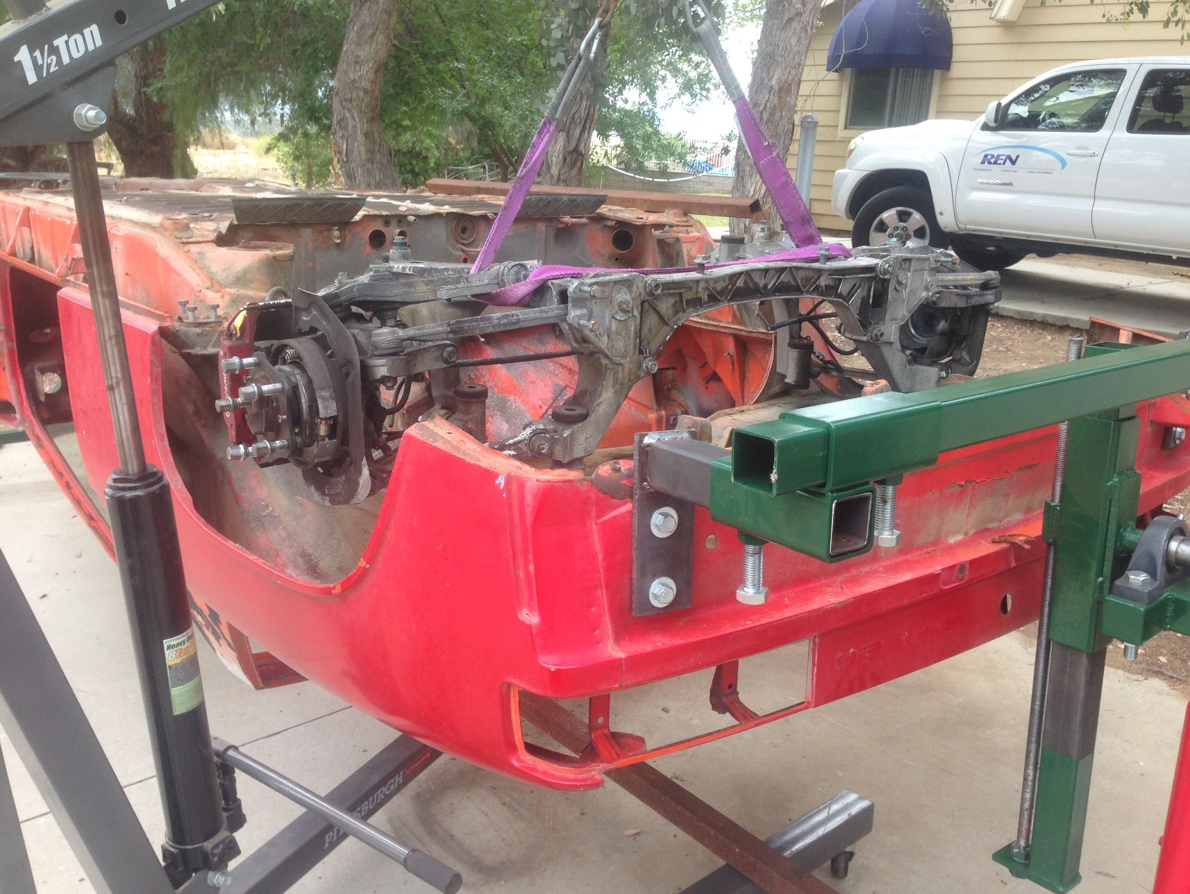

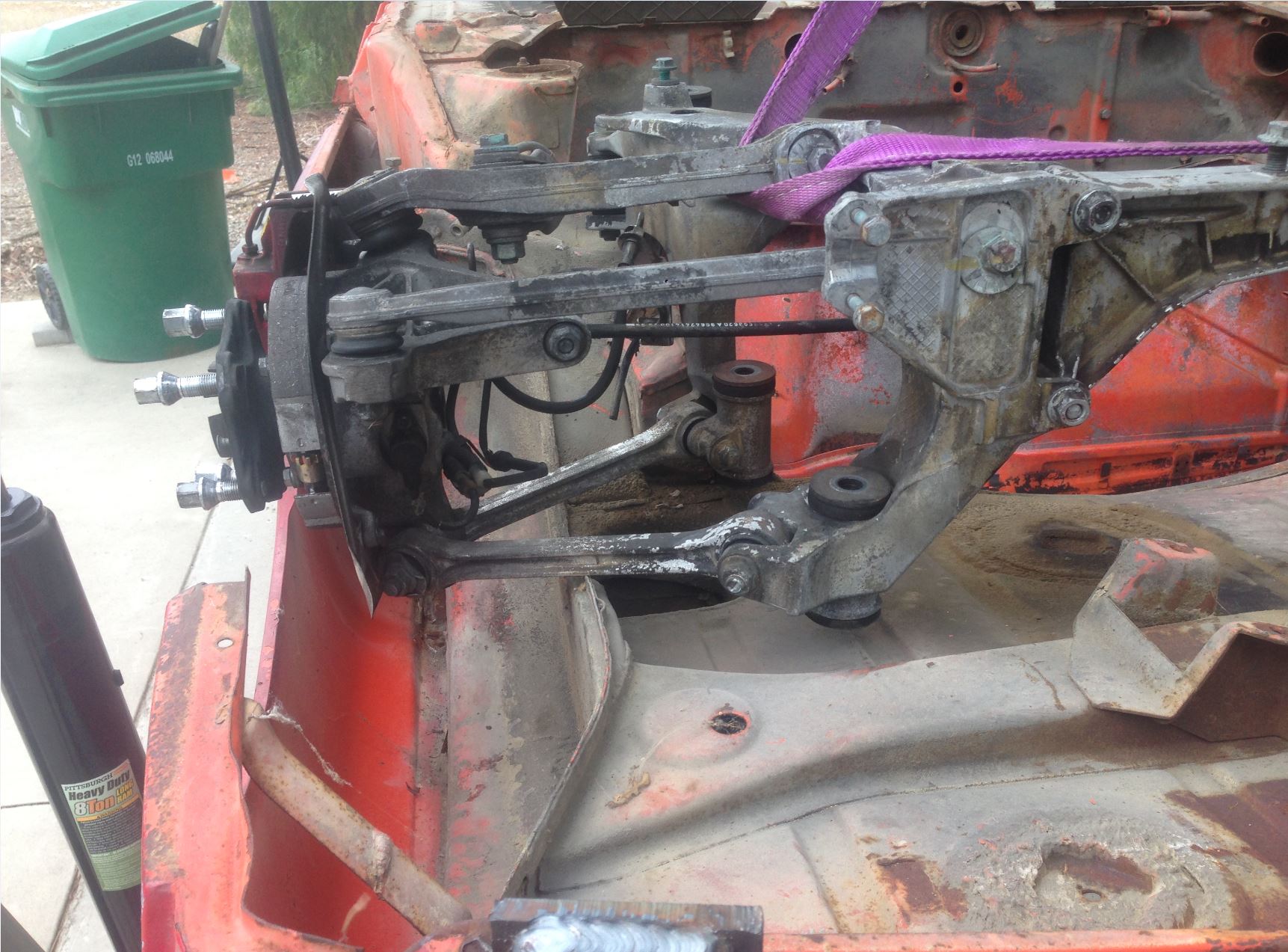

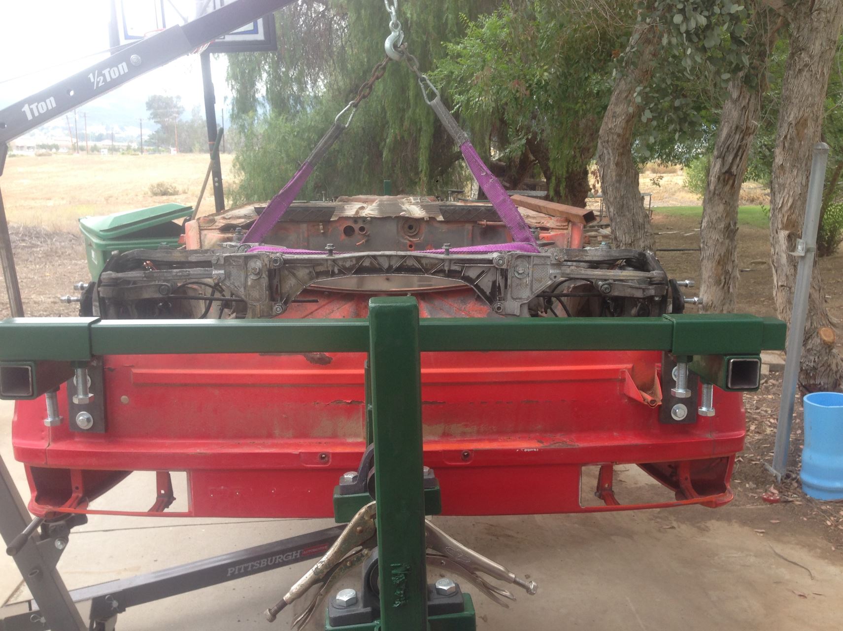

Curbandgutter   Well here is the rotisserie that I made. I took t...   Jun 14 2016, 02:29 PM

Curbandgutter   Looking forward to this. Damn nice rotisserie. Jo...   Jun 17 2016, 09:15 AM
