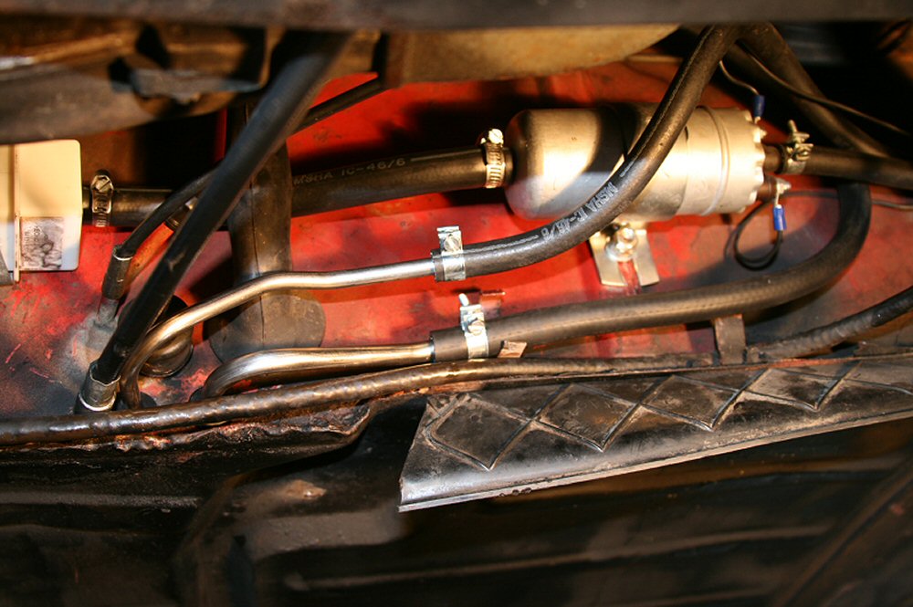

Yes, just remove the spliter so the return line is a straight shot back to the gas tank. I had to move the pump from the original position; no way it would fit in the original spot with input and output on opposite ends of the new pump. I drilled a hole in the firewall (actually 2 walls) and mounted as shown in my previous picture. I just copied what another 914World member did (I need to search around to figure out what thread/member I got the picture below from).

QUOTE(napasteve @ Jun 8 2016, 10:18 AM) *
That picture is from my 914. Feel free to use it to educate other owners. Terry
