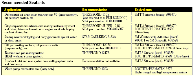

914forme   But you could also use Loctite 518 which is anaero...   Jun 20 2016, 04:26 PM
76-914   But you could also use Loctite 518 which is anaer...   Jun 21 2016, 08:00 PM
Chris H.   That's a good point...the Permatex stuff does ...   Jun 20 2016, 06:13 PM
