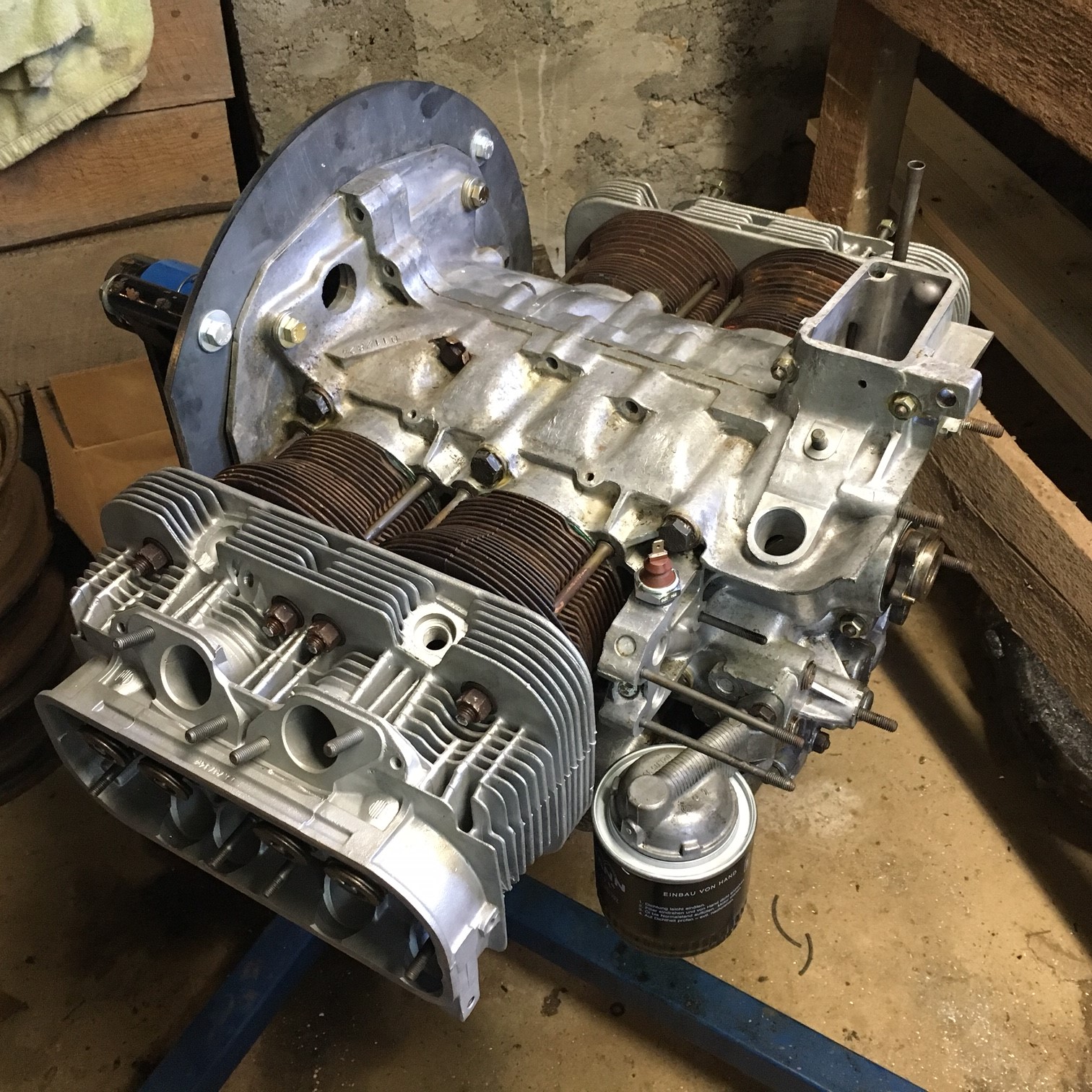

dlee6204
post Jun 20 2016, 08:33 AM
Howdy
Posts: 2,162
Joined: 30-April 06
From: Burnsville, NC
Member No.: 5,956
I've been busy working on my other 914 but I did manage to get the other side of the motor together.
