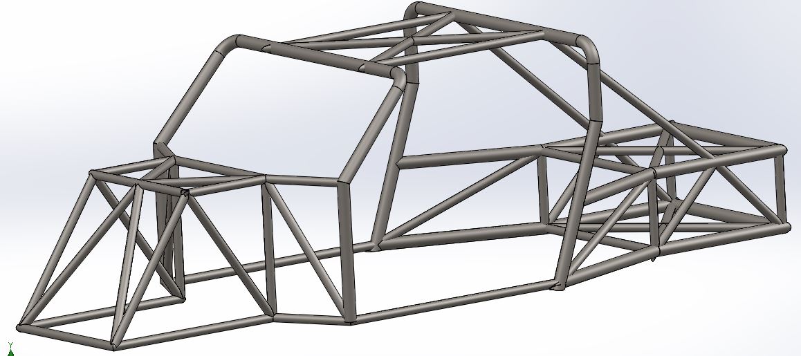

Little teaser as to what the frame will look like.

QUOTE(Curbandgutter @ Jun 19 2016, 10:02 PM) *
Great project for sure!
Did you check the SCCA rules with regard to how high the roll bar has to be over a helmet? I was surprised how high the roll bar has to be....
The Solo roll bar standards are here:
http://cdn.growassets.net/user_files/scca/....pdf?1458925428

914forme   :confused: The top of that rollbar must be 2...   Jun 21 2016, 12:21 PM
Curbandgutter   Well I started to analyze the frame and found that...   Jun 21 2016, 03:43 PM

Mueller   Are you going to model the suspension? If so chec...   Jun 22 2016, 02:07 PM
Curbandgutter   Are you going to model the suspension? If so che...   Jun 22 2016, 03:18 PM
914forme   The next item on the list is to build the frame...   Jun 22 2016, 03:33 PM
Curbandgutter   I am making it out of 4x4 tubing. The tubing has ...   Jun 22 2016, 05:35 PM
Curbandgutter   I am making it out of 4x4 tubing. The tubing has...   Jun 22 2016, 06:02 PM
Curbandgutter   Thank You JD. I appreciate your excellent input.   Jun 23 2016, 10:30 AM
Curbandgutter   2g Lateral Load at rear yields a 1/16" latera...   Jun 23 2016, 08:01 PM
jd74914   2g Lateral Load at rear yields a 1/16" later...   Jun 23 2016, 10:08 PM
Curbandgutter   I'm feeling pretty good about this chassis :ch...   Jun 23 2016, 08:05 PM
Curbandgutter   That did it. Since the lower frame is flush with ...   Jun 24 2016, 11:52 AM
jd74914   That did it. Since the lower frame is flush with...   Jun 27 2016, 09:09 AM
Curbandgutter   It uses thick tubing for the main hoops and thinne...   Jun 27 2016, 04:51 PM

jd74914   It uses thick tubing for the main hoops and thinn...   Jun 27 2016, 07:00 PM
