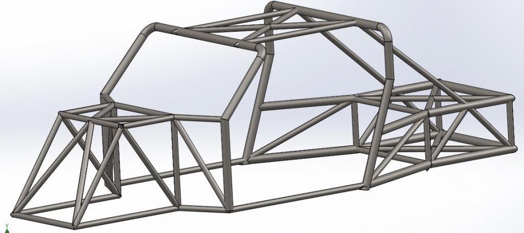

Little teaser as to what the frame will look like.

QUOTE(Curbandgutter @ Jun 19 2016, 10:02 PM) *
Great project for sure!
Did you check the SCCA rules with regard to how high the roll bar has to be over a helmet? I was surprised how high the roll bar has to be....
The Solo roll bar standards are here:
http://cdn.growassets.net/user_files/scca/....pdf?1458925428
eeyore
post Jun 21 2016, 01:13 PM
Posts: 889
Joined: 8-January 04
From: meridian, id
Member No.: 1,533
QUOTE(Randal @ Jun 21 2016, 09:17 AM) *
Did you check the SCCA rules with regard to high the roll bar has to be over a helmet? I was surprised how high the roll bar has to be....
For SCCA, doesn't the main hoop have to have a cross bar, and all of it in a single plane? I.e. no fore/aft bends.
