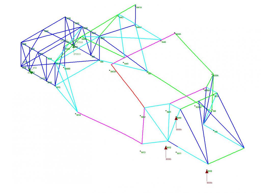

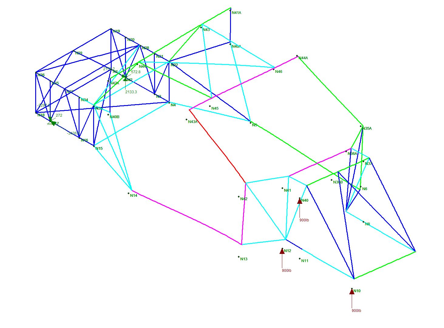

Well I started to analyze the frame and found that the front windshield bar (the one in red) will need to be upsized. I wasn't expecting that. Also, I wasn't expecting to stiffen the longs (n14 to n13) but after today's, result, looks like it's a must to stiffen the longs even with a roll cage. Attached Image
