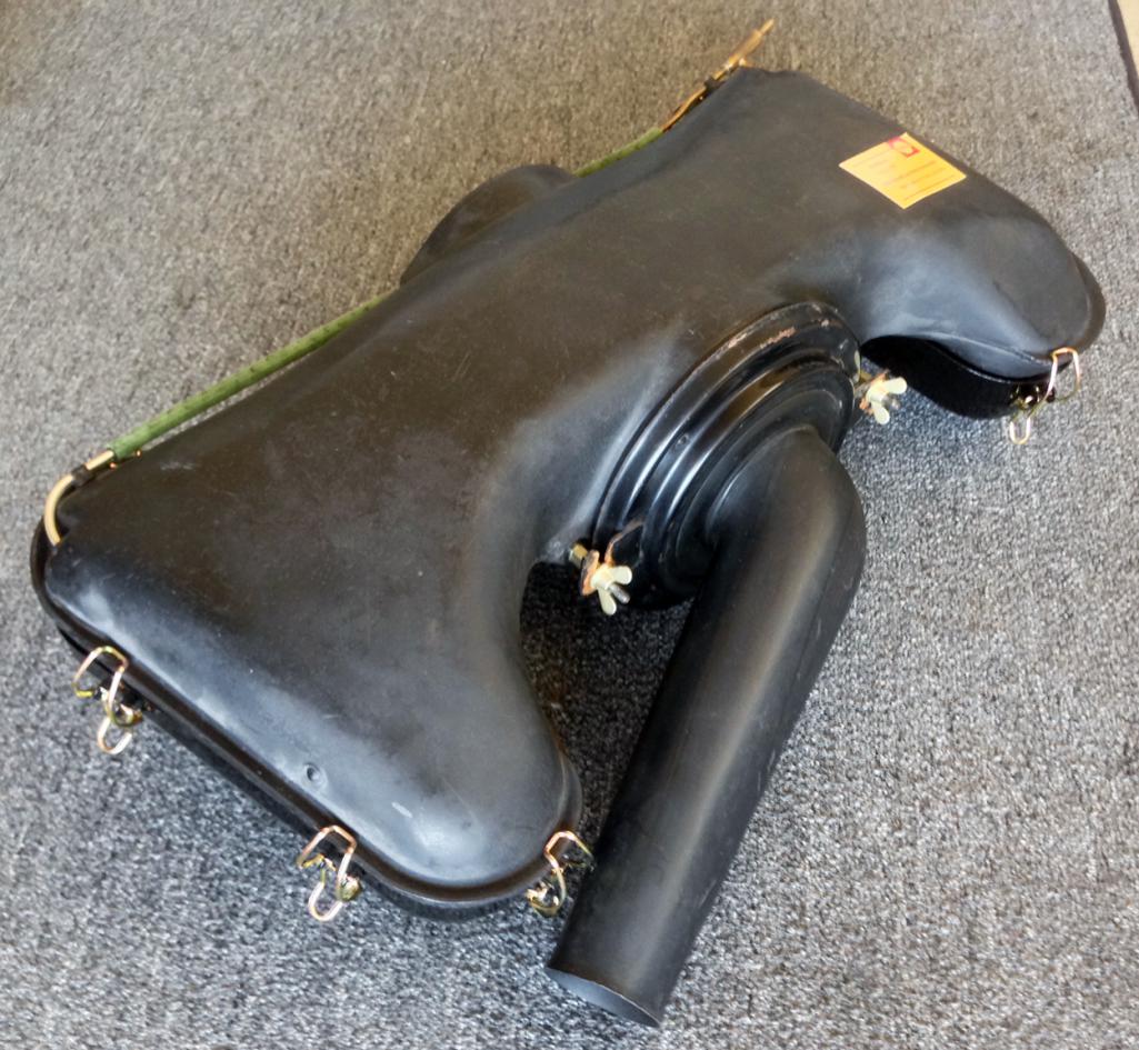

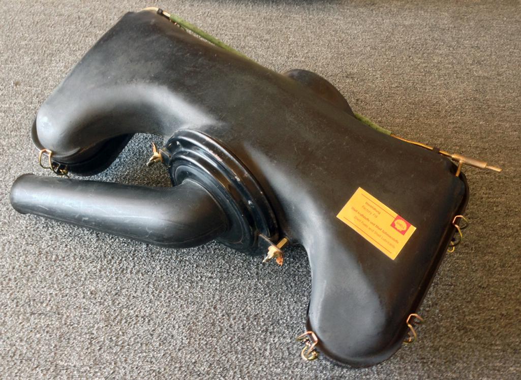

I have an aircleaner box that still has the squirter manifolds and the fuel line that feeds them.
I thought it would be cool to leave them in and mock up the connection.
Does anyone have a pix or know where the feed line for these connected and how was it routed??
Could not find it in PET or the shop manual. From what I can learn, the 911 one was connected to a T and a solenoid that was in the tunnel. What about the six??

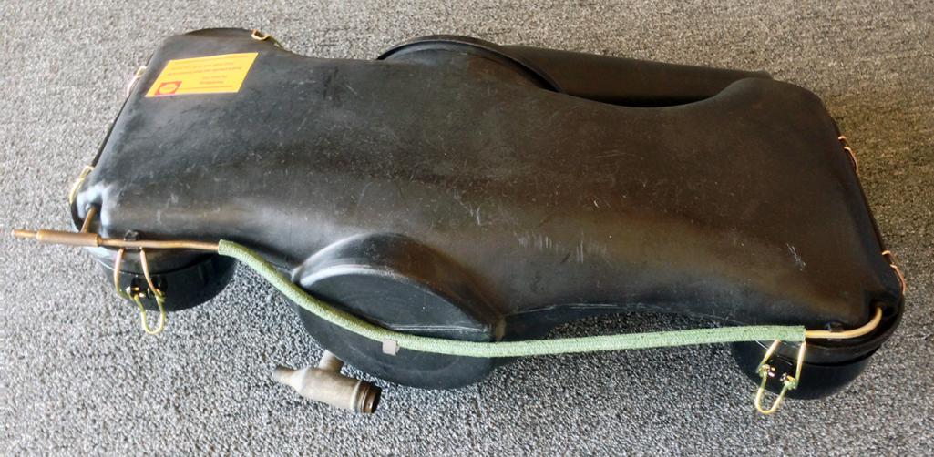

I have all the emissions and cold start stuff from my early six #131
The tubes that run into the air box were disabled by being pinched at some point possibly during the recall?
Green braided hose is just a place holder.
(I have no intention of ever hooking any of this up in the future. It will all continue to live in a storage bin)

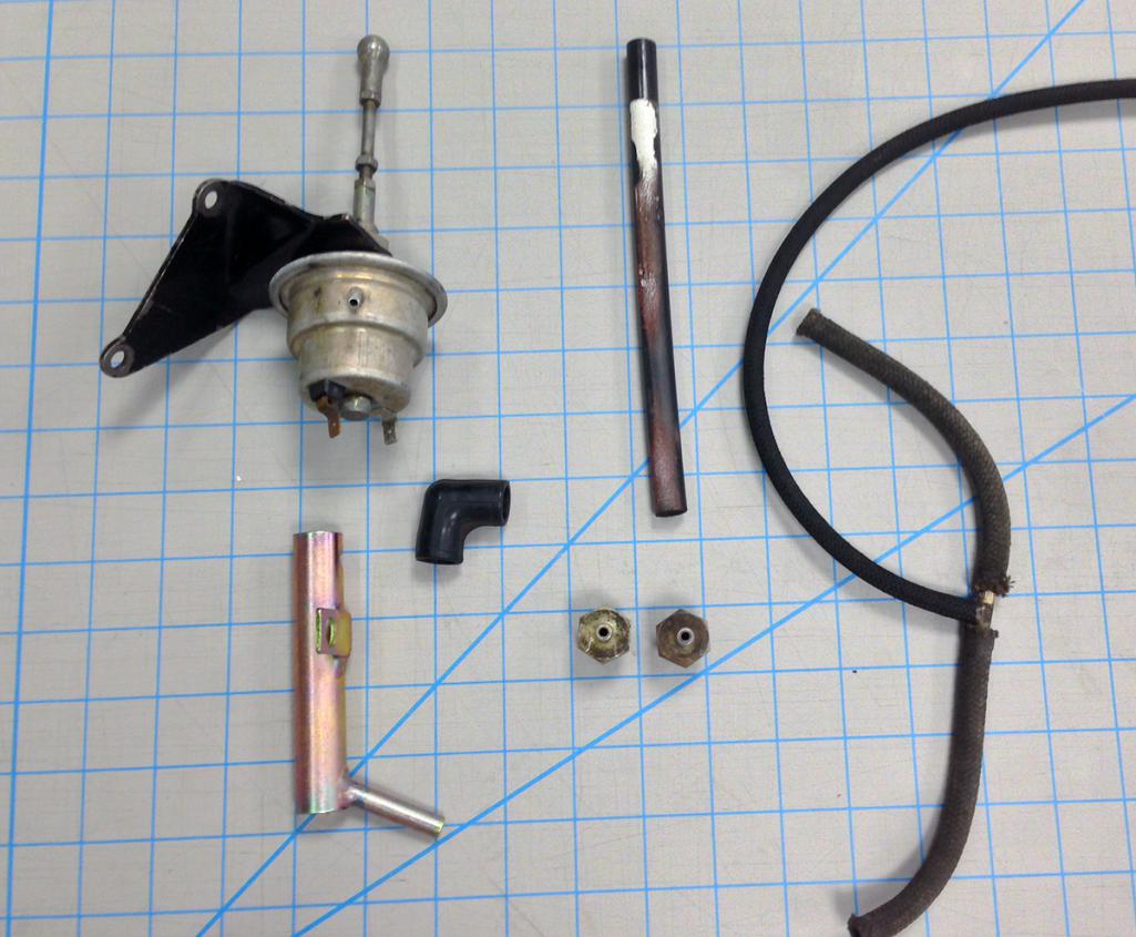

mskala   I'm pretty sure I have the squirter stuff that...   May 3 2016, 05:10 PM
gereed75   I'm pretty sure I have the squirter stuff tha...   May 3 2016, 05:57 PM
mskala   Here is all I found You can barely see in the a...   May 3 2016, 06:27 PM
gereed75   Here is all I found You can barely see in the ...   May 3 2016, 08:14 PM

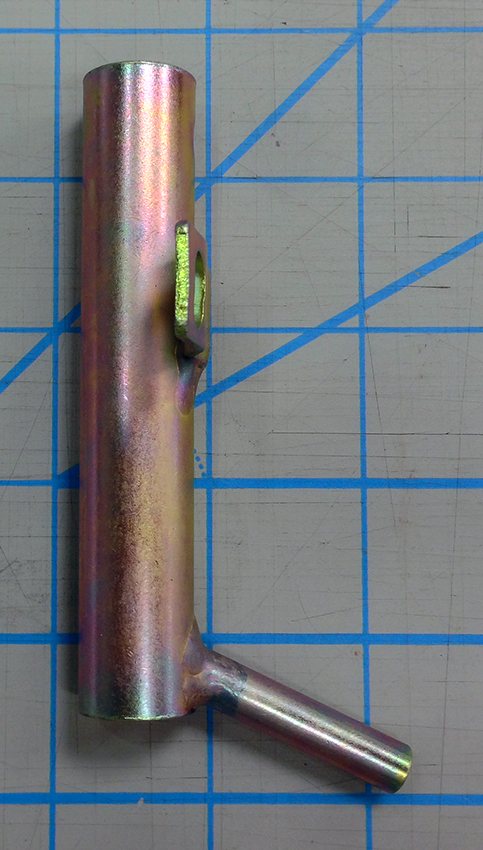

gandalf_025   Here is the dashpot that was removed from my car b...   May 4 2016, 10:29 AM
gereed75   Here is the dashpot that was removed from my car ...   May 4 2016, 01:11 PM
mskala   ... But I have never seen the solenoid or the fue...   May 4 2016, 02:12 PM
gandalf_025   Snorkel may be from a six.. Here is the inside o...   May 4 2016, 02:55 PM
mskala   Found this T and this un-braided hose.   May 4 2016, 04:30 PM
