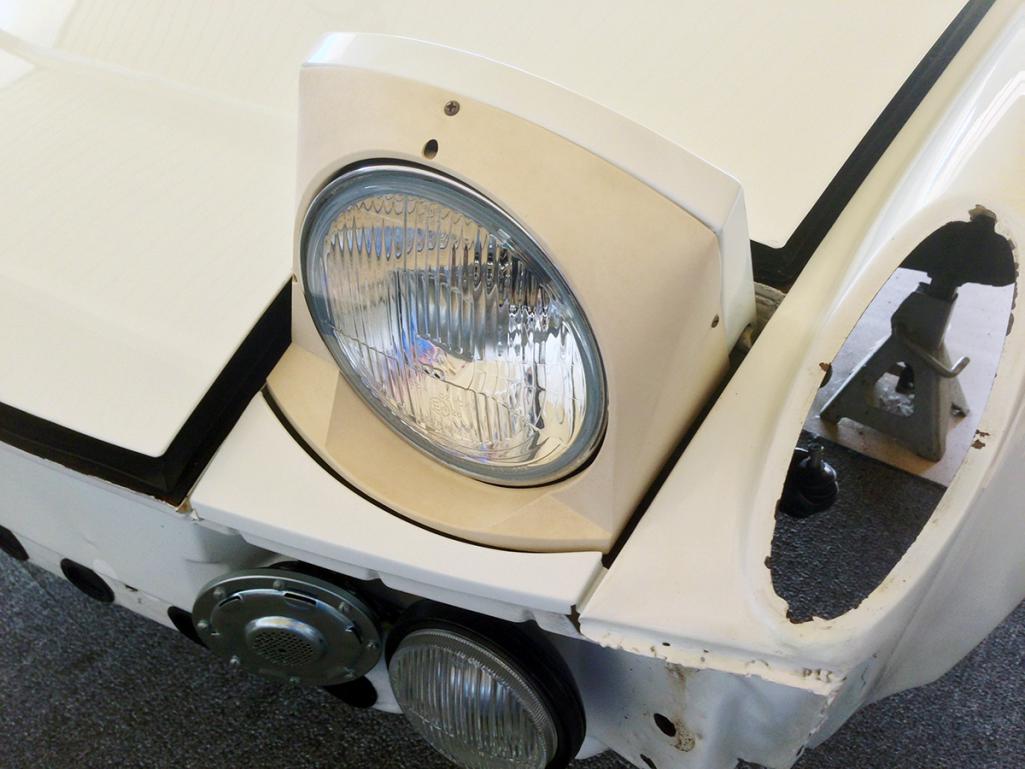

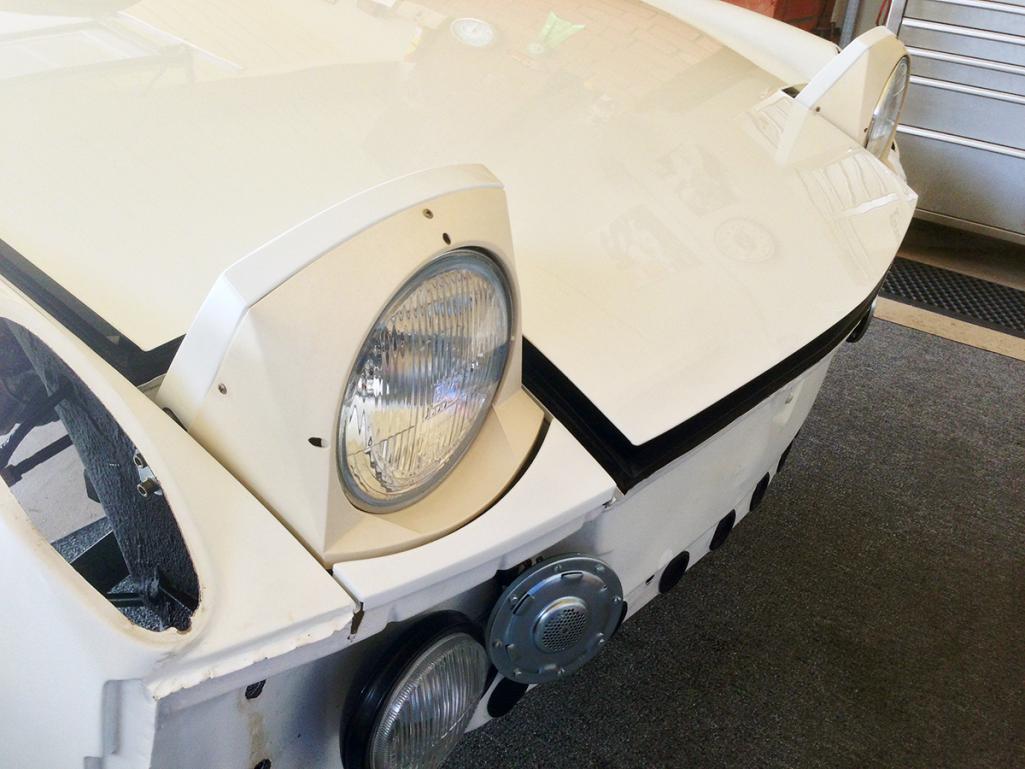

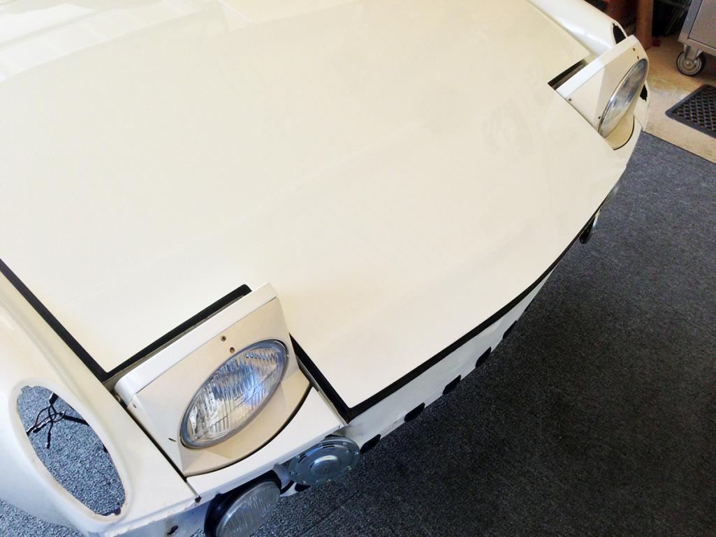

To paint or not to paint that is the question... (IMG:style_emoticons/default/idea.gif)
Here are my 914 early head light doors. They are original white plastic and showing some aging (Yellowing). Paint, or no paint... I keep hearing they are only original once ! Attached thumbnail(s) |
