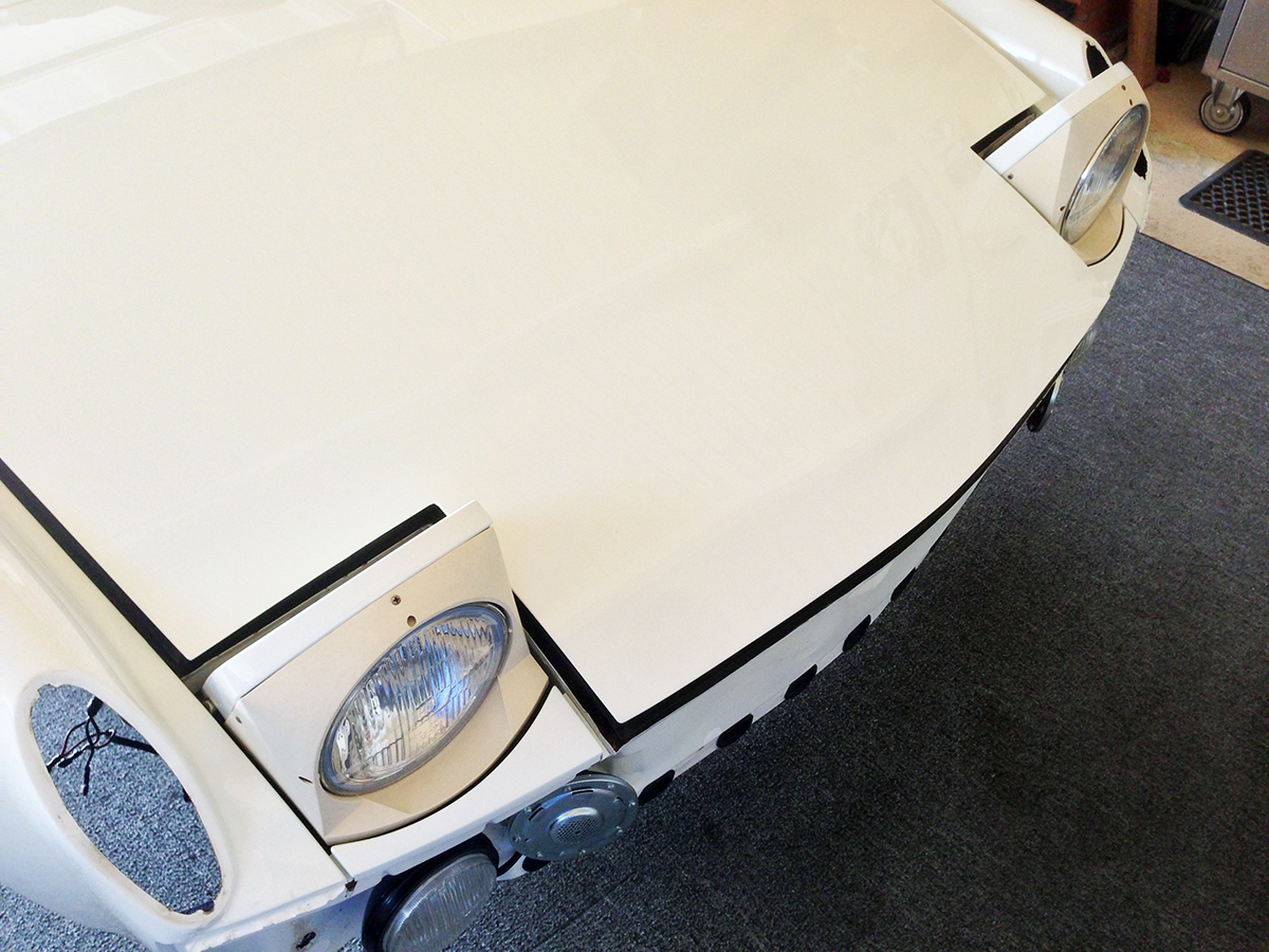

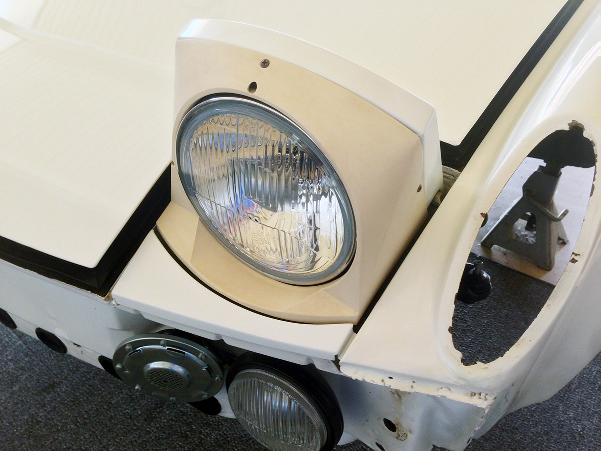

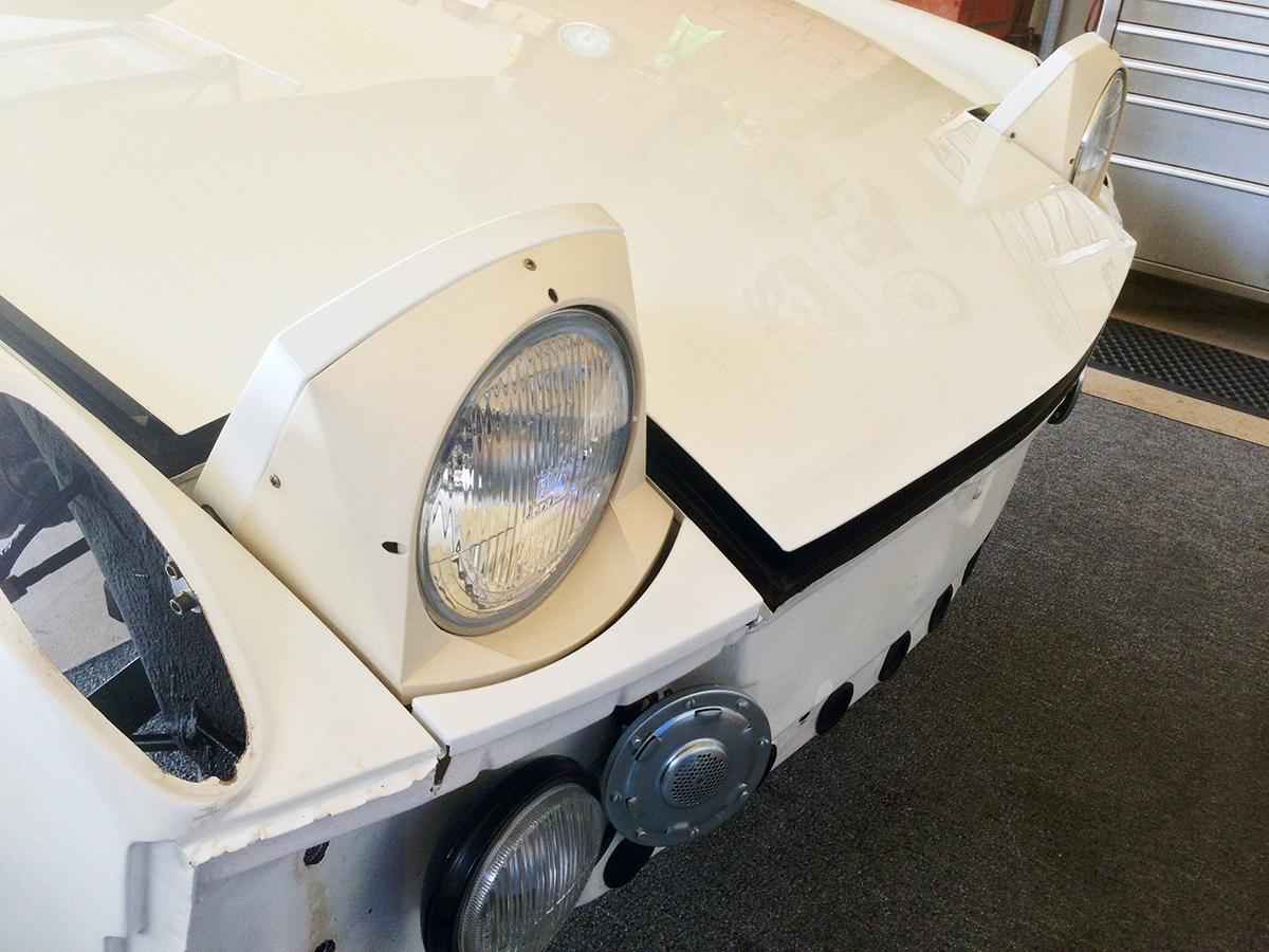

Here are my 914 early head light doors. They are original white plastic and showing some aging (Yellowing).
Paint, or no paint...
I keep hearing they are only original once !

they look nice. i would leave them as-is. mine were black. bead blasting cleaned them up and paint made them white again but I'm sure they don't look original. Still, I'm happy with the result.
