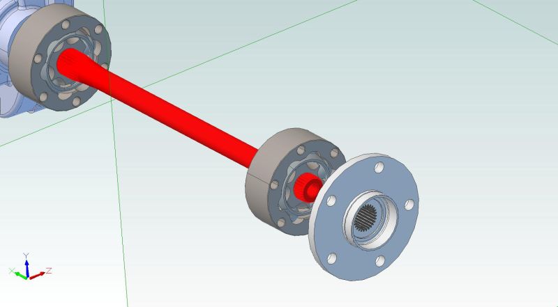

Are you going to model the suspension?
If so check out GrabCAD, I got the CV joints and center section from there (I modeled the rest)

QUOTE(Mueller @ Jun 22 2016, 01:07 PM) *
Hey thanks I'll remember that when I need it. Right now, I'm getting a feel fro the way the frame will behave. The next item on the list is to build the frame table and to mount the 996 to get all of the suspension pick up points tabulated. Then mount the 914 to start building the chassis with the same suspension pick up points built in. I'll be using a plumb bop and a laser meter to measure and square every thing. It's finally coming together. (IMG:style_emoticons/default/piratenanner.gif) (IMG:style_emoticons/default/piratenanner.gif)

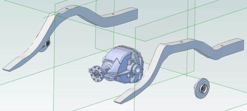

Curbandgutter   Well I started to analyze the frame and found that...   Jun 21 2016, 03:43 PM

Mueller   Are you going to model the suspension? If so chec...   Jun 22 2016, 02:07 PM
Curbandgutter   Are you going to model the suspension? If so che...   Jun 22 2016, 03:18 PM
914forme   The next item on the list is to build the frame...   Jun 22 2016, 03:33 PM
Curbandgutter   I am making it out of 4x4 tubing. The tubing has ...   Jun 22 2016, 05:35 PM
Curbandgutter   I am making it out of 4x4 tubing. The tubing has...   Jun 22 2016, 06:02 PM
