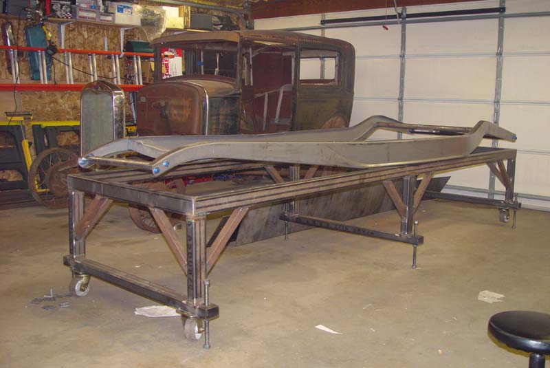

I am making it out of 4x4 tubing. The tubing has much tighter mill tolerances than hot rolled I-beams. Also square tubing is much better than an I-beam in torsion. To make it out of an I-beam I would have to have it blanchard ground. I'm going with 4x4x3/16 frame with six 4x4x3/16 legs. All cross braced with 4 casters and 6 leveling screws. I'll tack weld on the ground enough so that I can raise and assemble. Then I will level all six legs with my survey equipment. Once leveled I will continue welding all seams a little at a time and from opposing corners so that the table does not warp. Then I will finish in that same Hunter Green as the rotisserie. That small chassis table looks like it's awesome for small projects though.
Pic of what it may look like.
