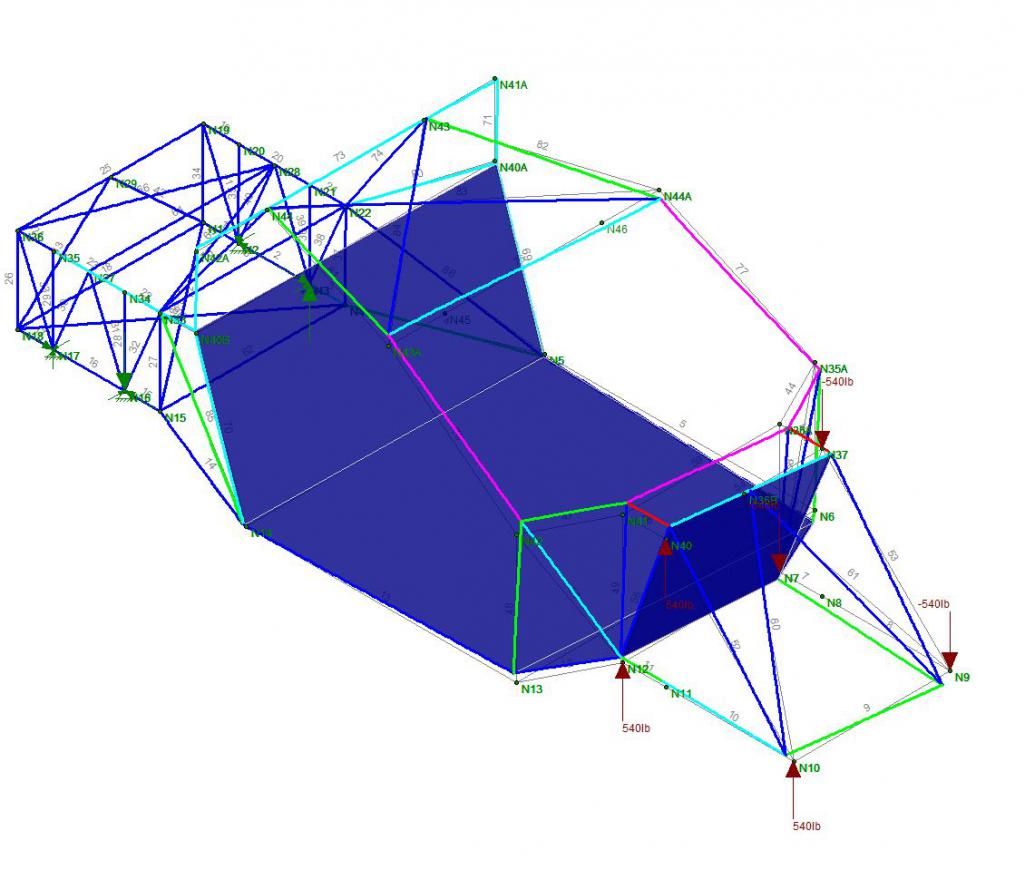

2g Lateral Load at rear yields a 1/16" lateral deflection Attached Image
3g Couple at rear yields a 0.114 vertical deflection Attached Image

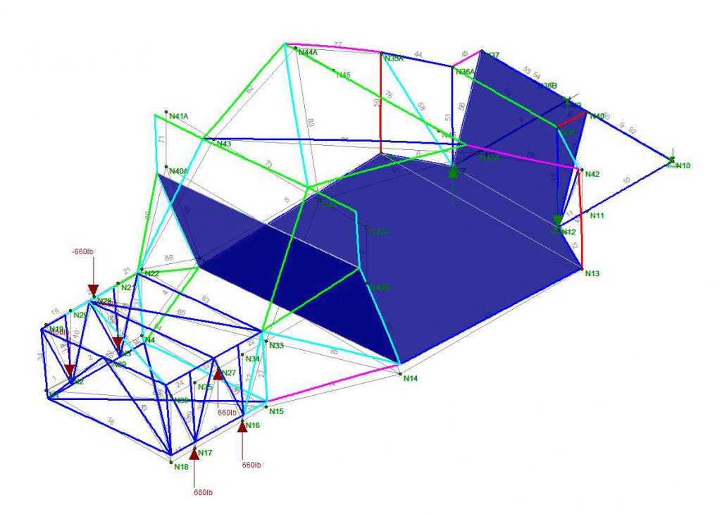

3g Couple at front yields a 0.10" vertical deflection Attached Image

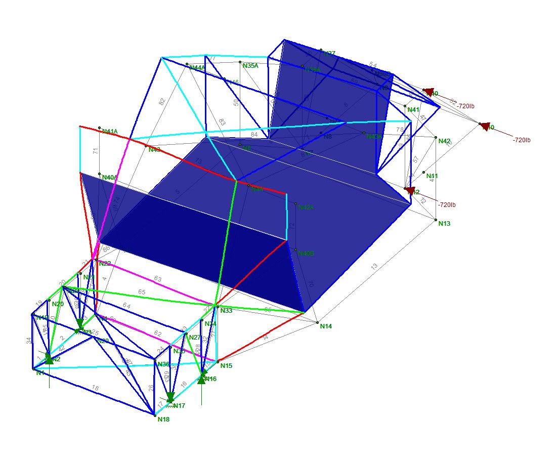

2g Lateral in front yields a WHOPPING 0.70" lateral defelction. This is the worst case. It makes sense too in that the hole where the engine is allows this deflection. I'll have to fix that somehow. I have to wait until the motor is in to add a removable cross brace or just live with it. We will see.Attached Image
