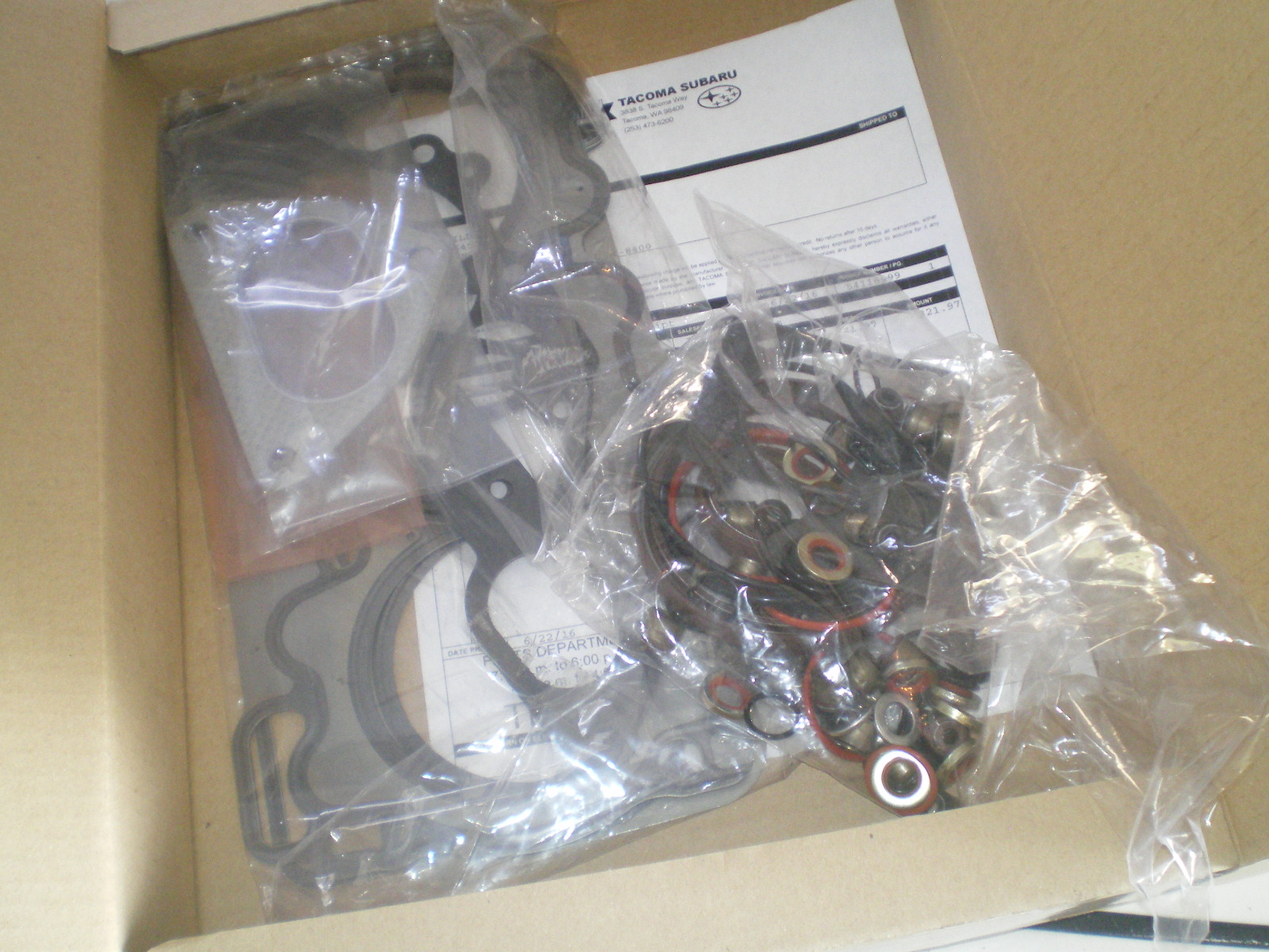

Finally! Gasket set arrived this PM. I need to go work at my daughters home in San Diego tomorrow but hopefully I can finish cleaning the case, chain guard, etc. and have it back in the car in 2 weeks.

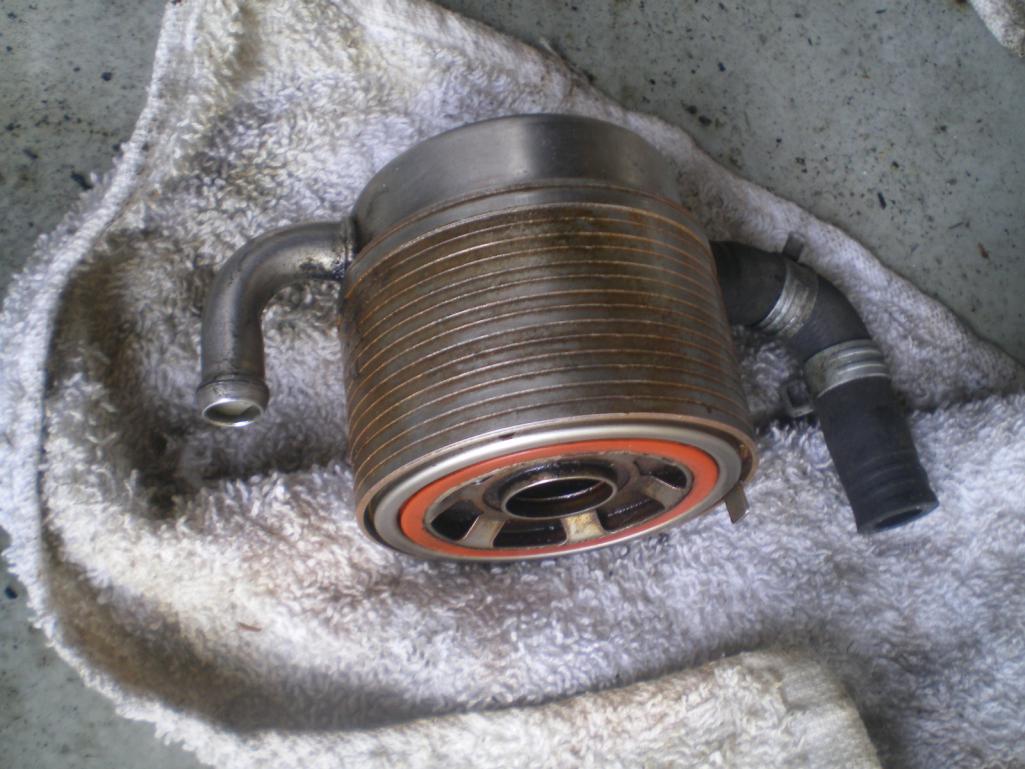

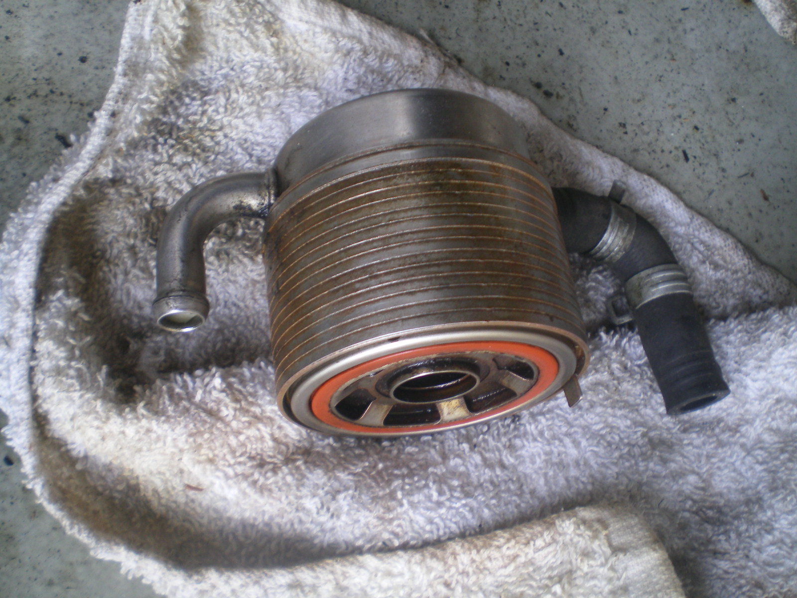

Cleaned the nasty Oil Cooler

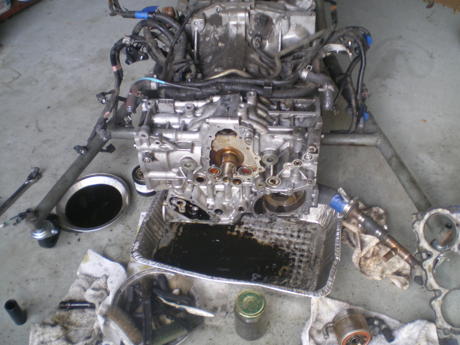

Started cleaning the case.
