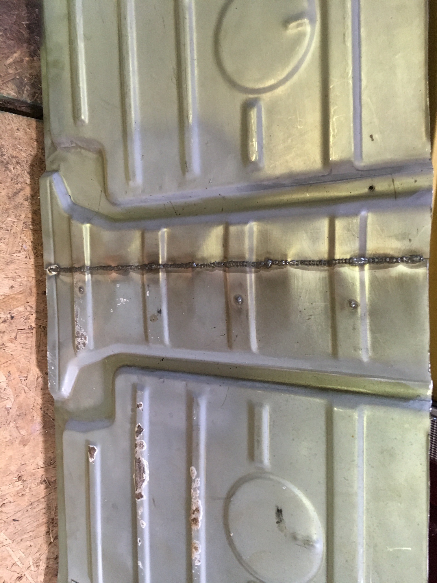

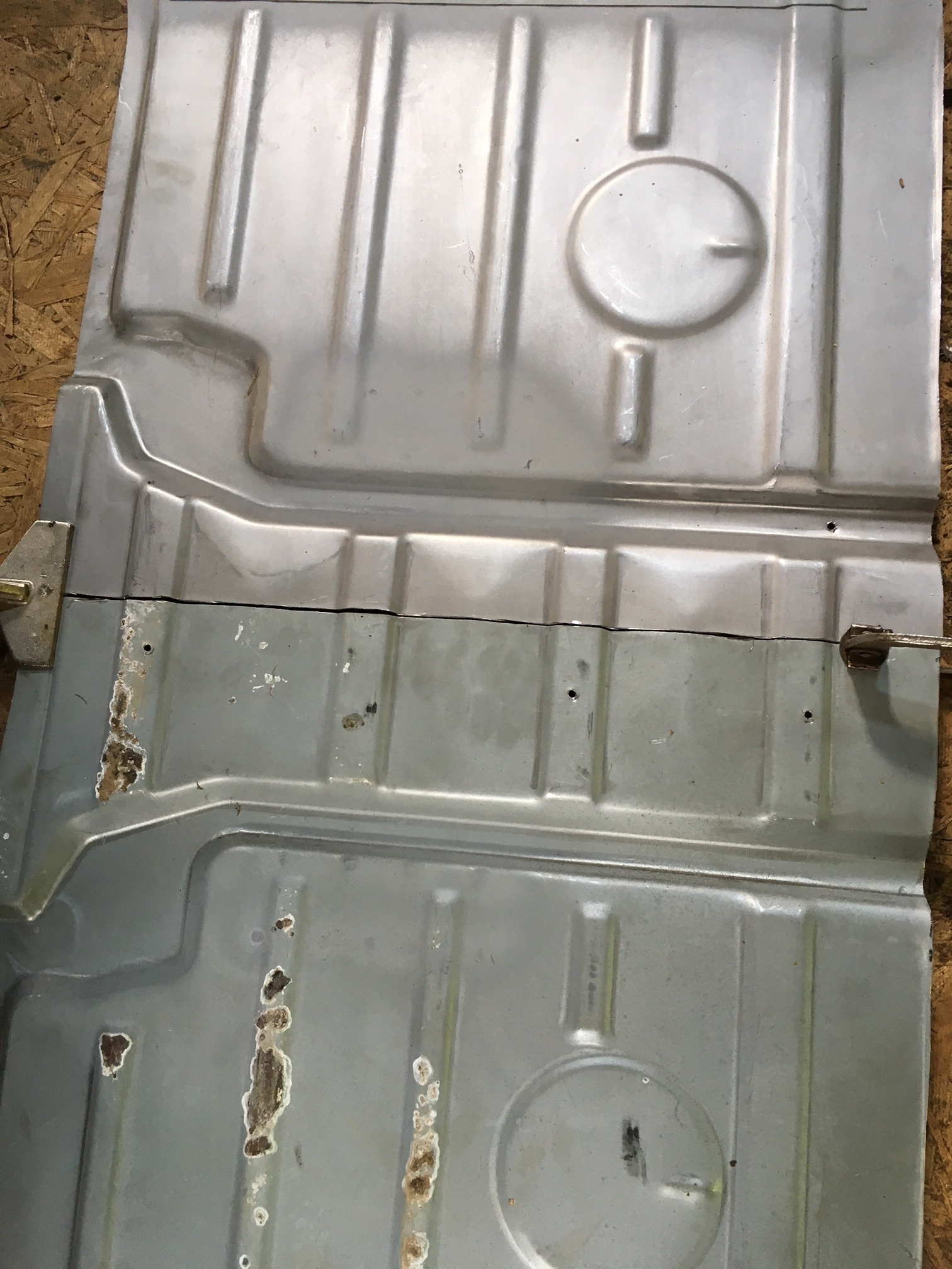

Started on the floorpan. I first had to trim my floor pan halves to weld them together.
Welded together.

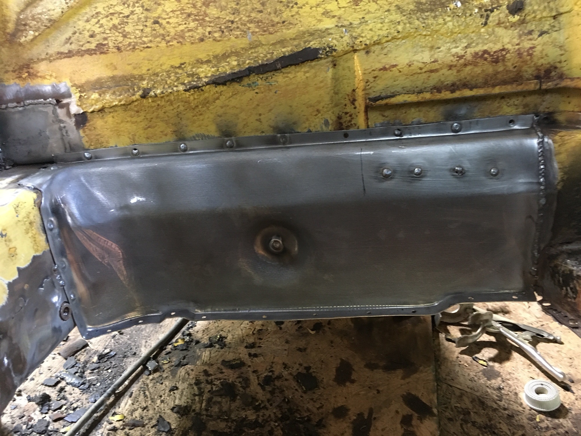

I got the inner firewall welded in too.

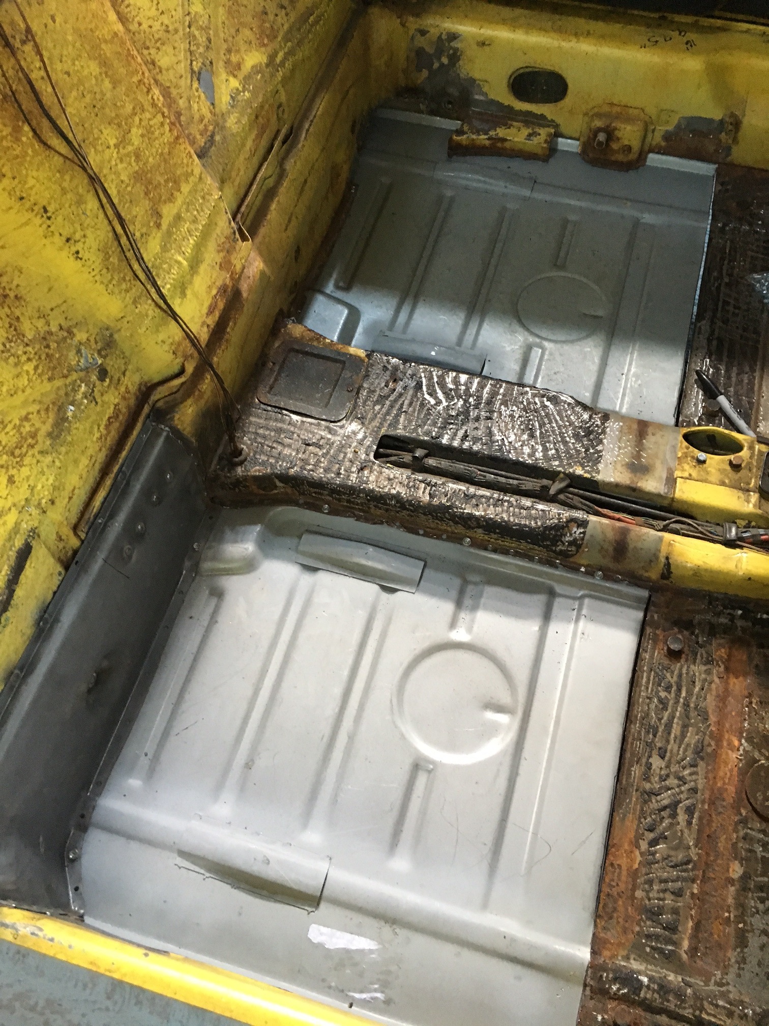

I set the floor in place and made final trimming.
