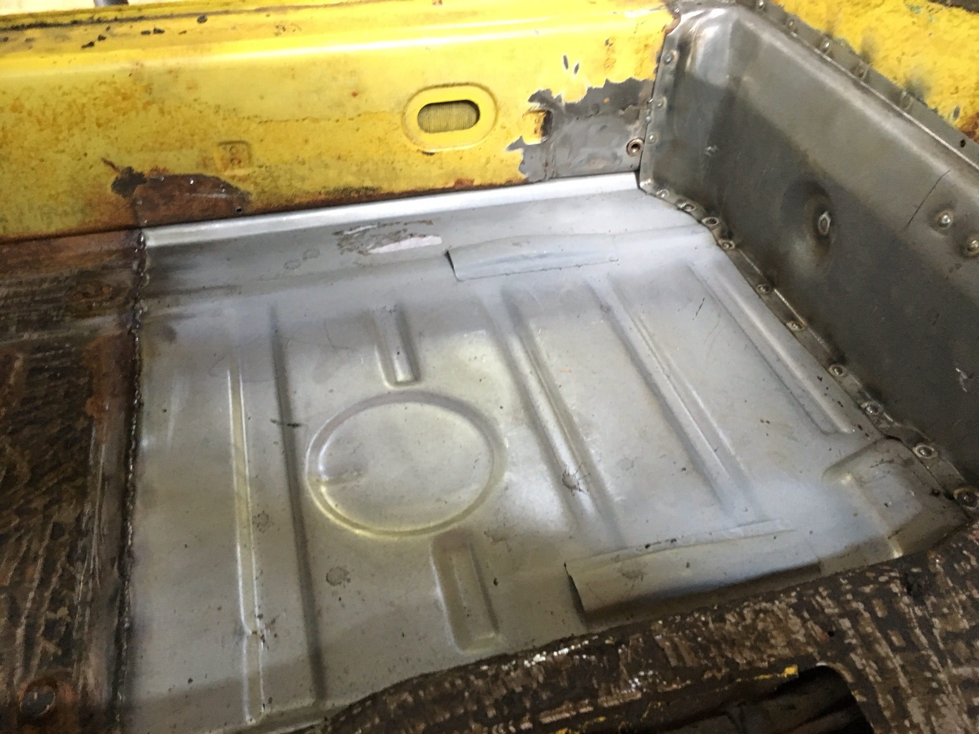

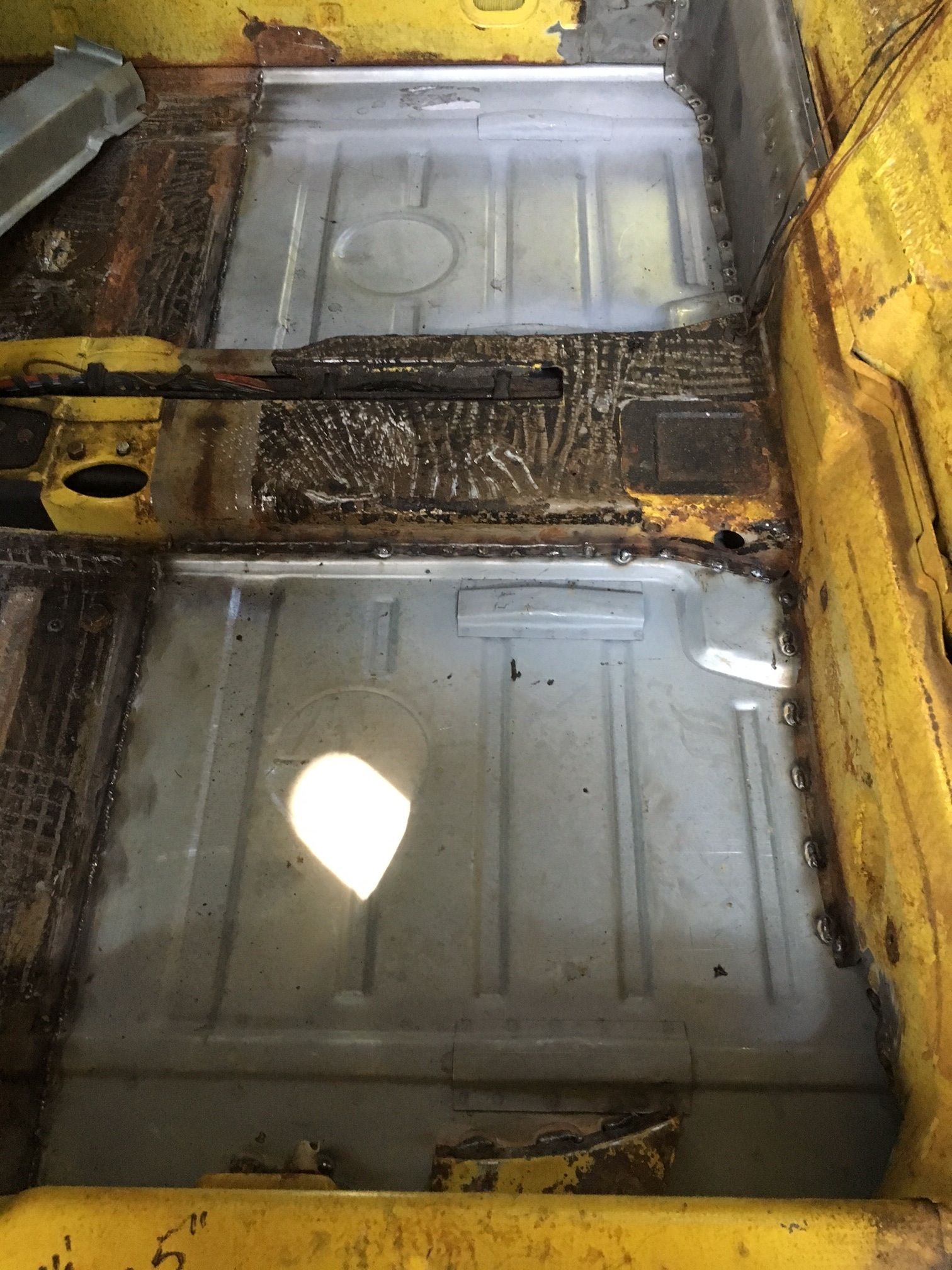

dlee6204   Started on the floorpan. I first had to trim my f...   Jun 26 2016, 02:38 PM
dlee6204   And floor pan is welded in. I still have to do al...   Jun 26 2016, 02:41 PM

dlee6204   Got the interior floorpan complete with crossmembe...   Jul 19 2016, 05:53 PM
