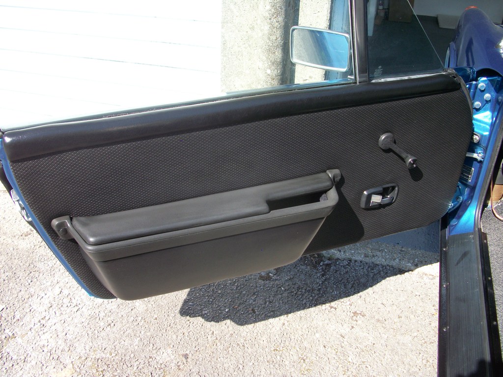

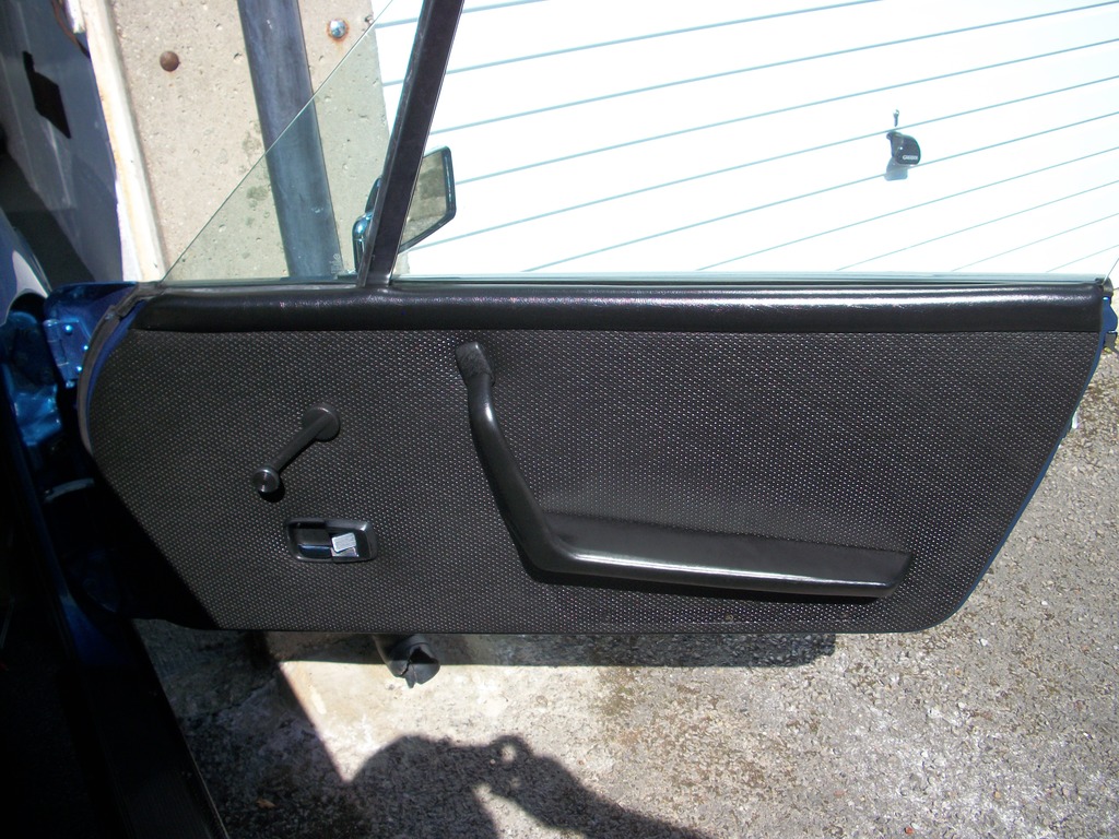

With the door damp membranes on, I fitted both door cards that I’d scrubbed and scrubbed, then cleaned numerous times to bring them back to life, I re-glued the basket weave edges, new staples and strengthened the hardboard backing with the wood rot hardener I used on the rear bulkhead previously. Then fitted the armrest and cubby on the drivers door. Winder handle and door handle escutcheon to finish off. I managed to find replacement armrest screw plugs that were missing and fitted those to complete.
(IMG:http://www.914world.com/bbs2/uploads_offsite/i265.photobucket.com-18255-1467144809.1.jpg)
On the passenger door panel I fitted the very nice condition pull handle I got from Ron on US ebay, winder and escutcheon. (Ron if you ever stumble across this thread….many thanks for your help in supplying me with superb condition used parts) The lower false cubby that came off my car is broken around the 3 fixing holes at the base so for now I’m deliberating on a repair or trying to find a good replacement (albeit the searching hasn’t shown any good ones up to now)
(IMG:http://www.914world.com/bbs2/uploads_offsite/i265.photobucket.com-18255-1467144809.2.jpg)
I even lined up each winder handle perfectly with each other when the windows are tight up!
With the door cards on it’s almost done now interior wise, just got to sort out those speaker covers. I currently have 2 broken ones off my car, 2 really bad quality (1 broken) Auto Atlanta ones and a single presentable RH one I got from Ron on US ebay. I also have just had a UK source for more, so hopefully it will sort itself out. I’ve already bought some new 4” speakers to go behind them to compliment the Blaupunkt, so itching to get the job done now!

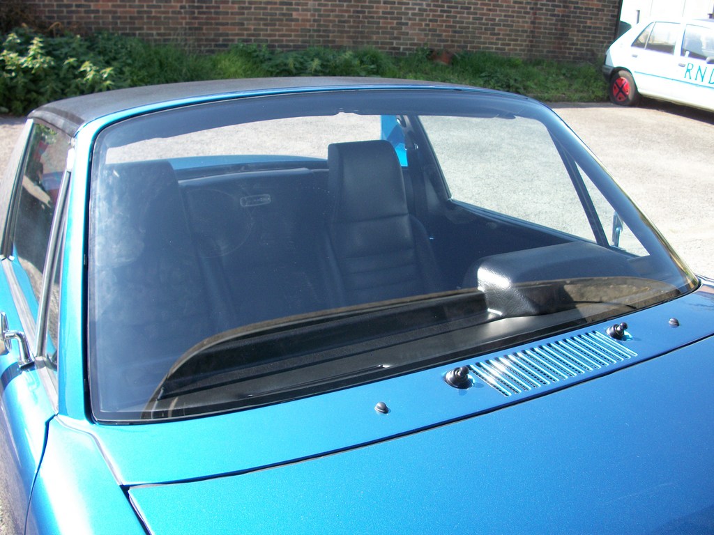

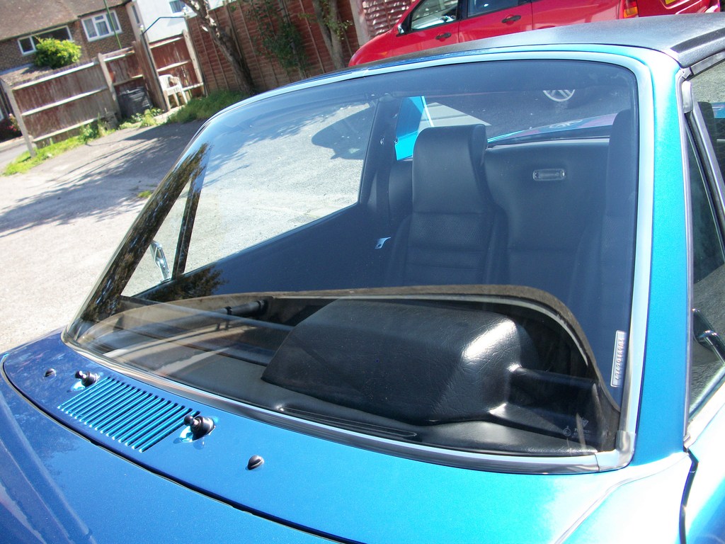

Today I made good progress and after all the preparation and pain I finally got the new Genuine Windshield fitted single handed (no UK Auto Glass companies would entertain fitting it using the Butyl method) so I stood inside the car reaching over using a set of rented glass suckers.
(IMG:http://www.914world.com/bbs2/uploads_offsite/i265.photobucket.com-18255-1467144810.3.jpg)
With the weather being hot again this afternoon it was ideal to warm everything through and help the Butyl ribbon become more workable. The screen went in a treat and sat neatly on the packing pieces to hold it central in the aperture. After a couple of hours of massage in the heat of the sun I got it sitting nicely down with the butyl compressed to give a wide adhesion and room for the ali trim.
The next thing to do was to mask up the paintwork around the screen to avoid any accidental damage when fitting the surround trim. I then used a small modellers brush to paint the body surround with waxoil under where the trim fits. This in combination with the caulking I put around the plastic clips should stop/restrict any rust forming where water sits. Starting with the lower piece first I carefully fitted the two corners to it and slipped them fully on each end. Having measured and marked the centre I carefully clipped it down working outwards to each corner. When reaching the corner before the final clip, the corner joiner piece was then adjusted to suit the aperture. Lastly before clipping the trim into the last lower clips I slid in the two remaining parts of the surround trim into the lower corners and set how far they slid in (the height) with the top of the aperture. The top link cover piece was slid onto one of the side trims and then the lower corners clipped in and working up the pillar I carefully clipped the rest of the trims in place. The top centre link piece was slid out onto the other trim and set 50/50 in the middle of the car before clipping the surround into the last clips. The masking tape was then carefully removed.
(IMG:http://www.914world.com/bbs2/uploads_offsite/i265.photobucket.com-18255-1467144810.4.jpg)
All that was left to do was fit the recently refurbished rear view mirror. I’d purchased a genuine stick pad from Porsche on the 914 part number so carefully fitted it to the mirror. The adhesive on these sticks better when warmed up, so I left it on the black granite worktop in my conservatory this morning so that it was warmed right through before applying the sticky pad. I used masking tape on the outside of the Windshield to mark the mirror position (measured from my old shield) and cleaned the inside of the glass thoroughly.
The sky had clouded over by now and it had gone black with approaching rain (there’s UK summer for you) so I needed to warm the windscreen to aid the mirror to stick well, so pushed the car back into the garage which was like a small oven after having sun on the roof most of the day. Since there is no power in the garage I couldn’t warm up the screen easily so had to think of another method.
(IMG:http://www.914world.com/bbs2/uploads_offsite/i265.photobucket.com-18255-1467144810.5.jpg)
This hot water bottle did the trick and after 10 minutes the glass was toasty warm, so I fitted the mirror firmly and left the heat to do it’s magic while the bottle cools overnight.

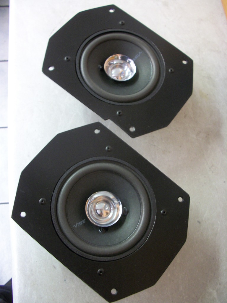

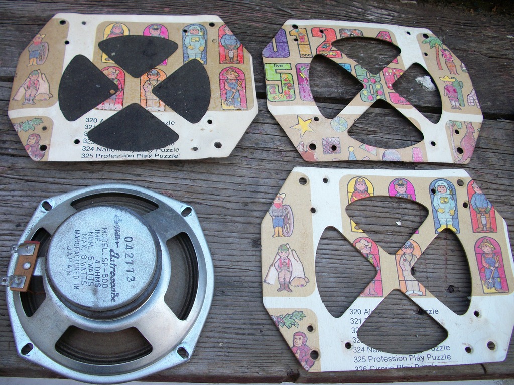

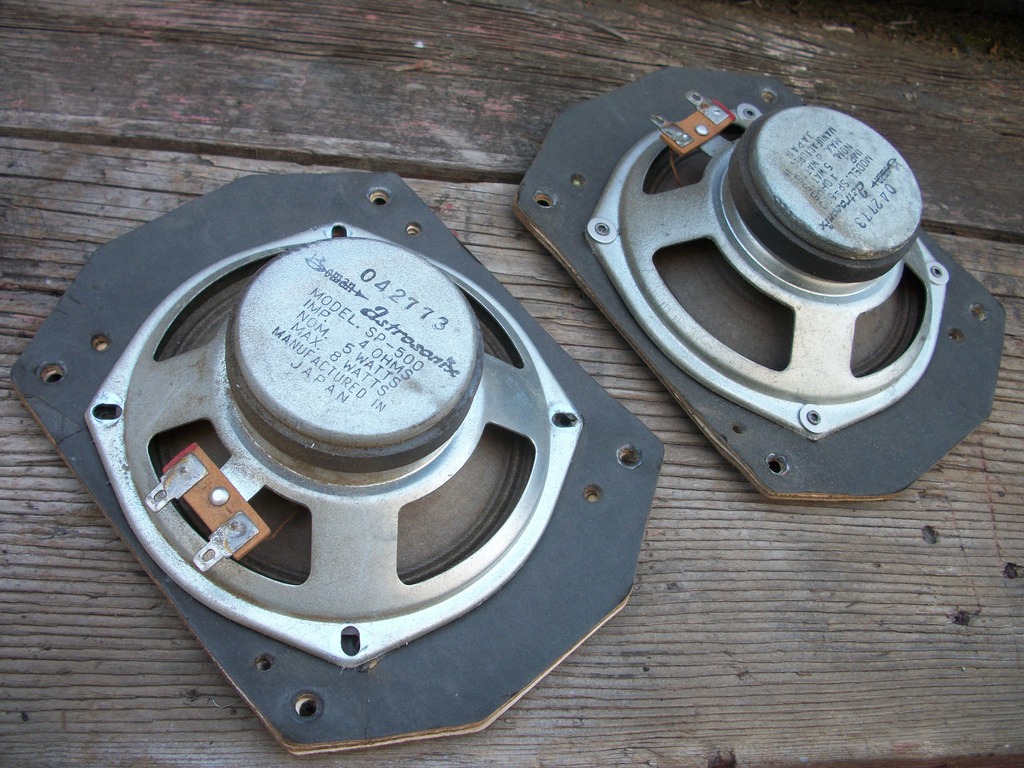

This evening I started again on the 914. I’m sort of resigned to having to make good speaker covers out of the collection of damaged ones I have, so started by stripping my old ones down.
The speakers say made in Japan ??? and were held in with 4 small bolts in each corner of a multi-ply card mounting plate. The card plates were all flimsy and the black tissue type speaker paper on the outer side was holed and rotten. I decided to drill out the rivets holding the old speakers so I could use the ply card as a template to make new ones.
(IMG:http://www.914world.com/bbs2/uploads_offsite/i265.photobucket.com-18255-1467144811.8.jpg)
This is where it gets quite interesting…..
The ply card plate looks professionally made and mass produced. The rivets are pan head so need a machine to install. The card is die cut and again needs a machine to manufacture like this.
When the rivets were out the ply card pieces came apart to reveal this…
(IMG:http://www.914world.com/bbs2/uploads_offsite/i265.photobucket.com-18255-1467144811.9.jpg)
Printed card from some old Children’s game set, possibly to teach Japanese children English? The manufacturer must have recycled old toy box card to make the 914 speaker mounts!
Suffice to say I plan on making a much better mounting plate over the next few days to hold my new speakers in place.

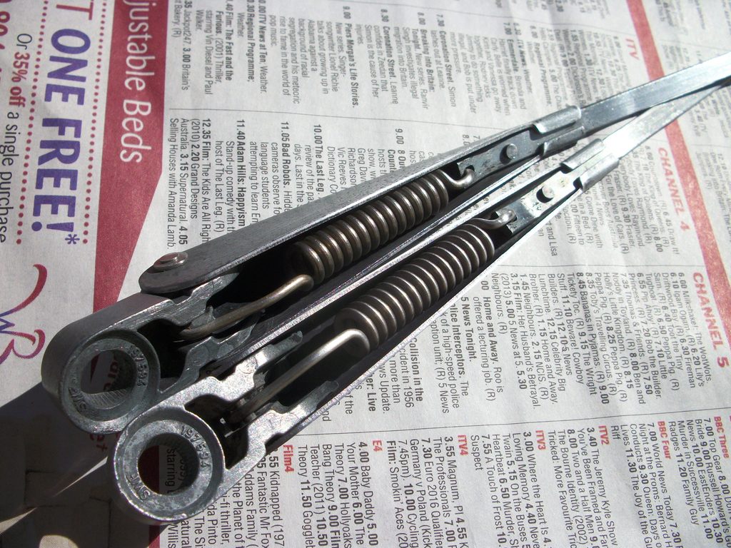

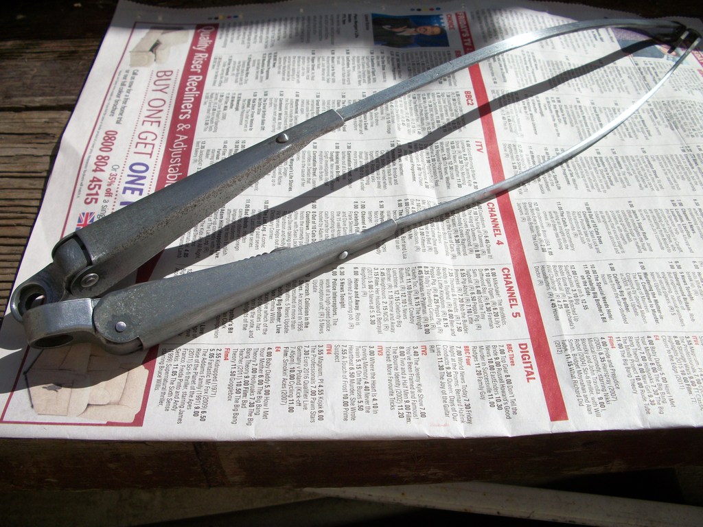

This morning the etch primer was well and truly dry on the wiper arms so I gave them a couple of coats of satin black and hung them back up in my conservatory and left for work.

As it started to get dark I managed to fit the new blades to the 914 wiper arms then fit the arms to the car. I was puzzled again about the wiper positioning and having purchased genuine Bosch blades I wasn’t happy how the drivers side sat on the screen. The blade didn’t follow the curvature of the glass at its end (near the chassis plate) it stuck out in mid air. After some research it was apparent that the new Bosch blades have evolved over the years to better suit the modern flat screens and therefore don’t bend as much as they used to. In comparison with some blades on my other cars I have from the 70’s the new blades are more “chunky” in comparison to older designs and pivot & flex less. Despite my best efforts, the only way to get the tip to sit better on the 914 screen is to bend the end pivoting section of the new Bosch arms to a slightly greater arc so that it allows the rubber blade to sit closer to the glass.
Using the Haynes manual guide I set the two blades (post 71 year car) to as close as I could to the recommended 20mm gap before it got too dark to see.

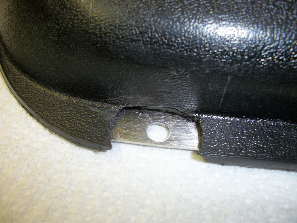

Moving into my workshop I started on the passenger false door cubby repair. I used a strip of 1mm stainless steel about 300mm long folded to an angle about 10mm x 15mm. This was placed inside the base of the damaged cubby from the inside and the screw holes marked on it. Removed and drilled with 3 x 6mm holes, I de-burred and roughed up the surface with 80 grit on both the angle and rear of the plastic cubby. Using polyurethane panel adhesive I bonded the angle onto the back of the cubby to give it strength across the base where the screws pass through and also bridge the gap where the broken and missing piece went around the end hole. The cubby was then clamped in my vice and mole gripped with protective packing pieces at each end and left to dry for the morning.
Day 247

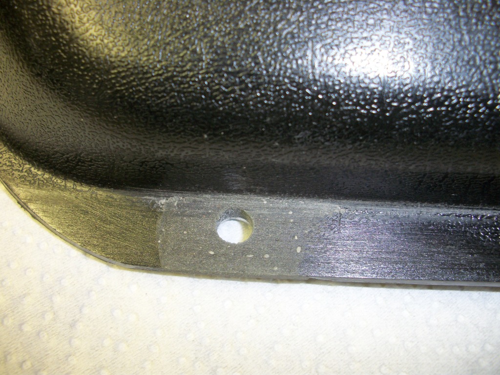

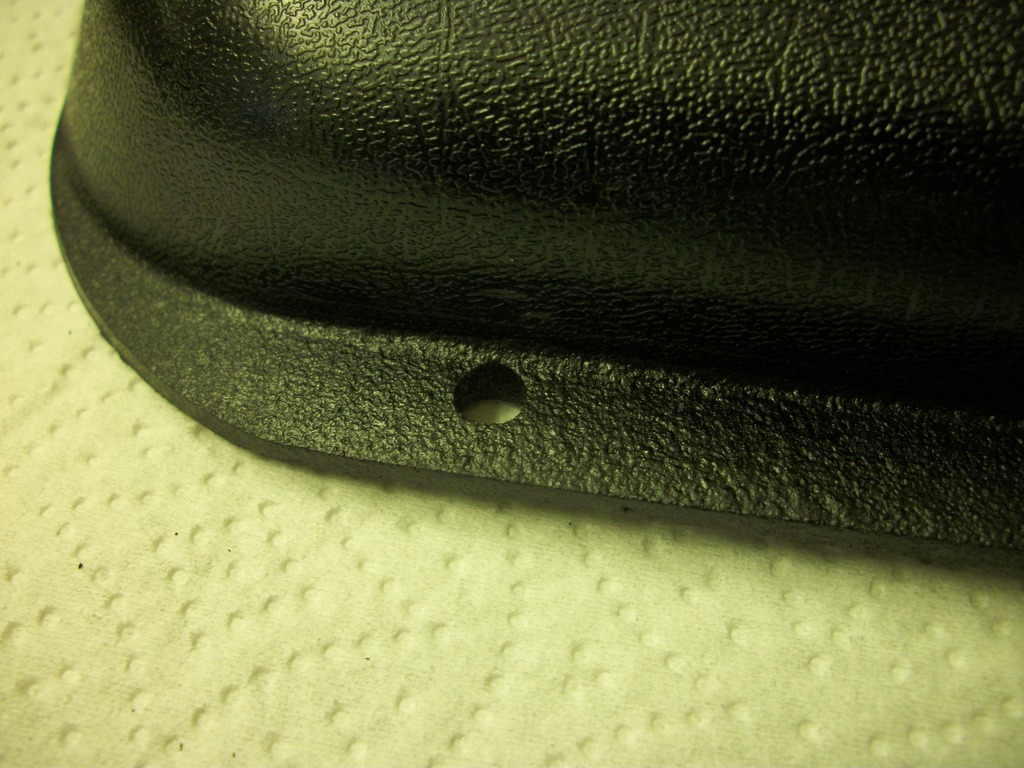

Today I carried on with the passenger door cubby repair. The bonding agent on the 4” long angle stainless reinforcement was dry this morning so I cleaned up any excess that had squeezed out. Since the cubby had been damaged before I got the car the pieces were completely missing around the mounting hole.
(IMG:http://www.914world.com/bbs2/uploads_offsite/i265.photobucket.com-18255-1467144811.10.jpg)
With the stainless angle in place I had a good base so taped up the edge and hole to make a trough (mould) and mixed some flexible plastic bumper repair 2 part resin and poured it into the mould and let it dry while I went to work.
This evening when I got home I filed and sanded the resin down to blend in and re drilled the hole.
(IMG:http://www.914world.com/bbs2/uploads_offsite/i265.photobucket.com-18255-1467144812.11.jpg)
The repair was finished off with a light coat (localised only over the repair) plastic bumper texture coat rattle can spray. Not exactly a grain texture, but close enough to hide the repair to the eye.
(IMG:http://www.914world.com/bbs2/uploads_offsite/i265.photobucket.com-18255-1467144812.12.jpg)

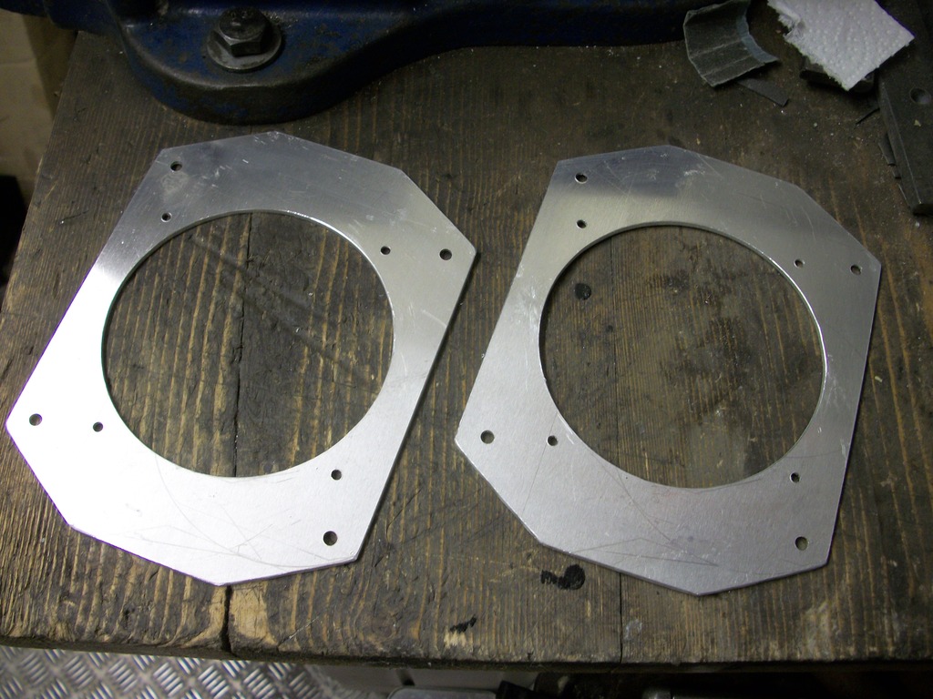

Working inside my shed I had no issue with light, so carried on and made two Aluminium speaker mounting plates with hacksaw, drill and file to match the cheap cardboard originals.
With 3mm aluminium sheet there was no need to make the sound obstructing X in the centre, so hopefully they’ll be some better sound from my new upgraded 4” speakers.

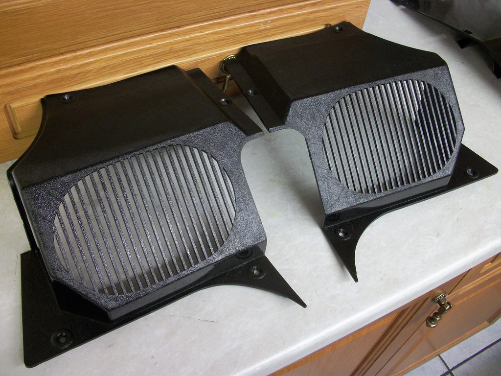

This morning I sanded down the speaker plates to key them and gave them a couple of coats of satin black before leaving for work.
During lunch I had a bit of a run-around looking for some speaker cloth. The plan is to mount the new speakers in the new brackets then cover the face with black speaker cloth before fitting into the housings. My new speakers have little in built tweeters in the centre that are a bit of chrome bling and would stand out a mile looking through the bars of the speaker housing so the material should hide them and do the trick. Anyhow the two places I had enough time to visit were out of stock, but hopefully I have a 3rd in mind tomorrow so will ring ahead this time to save a wasted journey.
This evening when I got home I gave the mounts another coat before starting to make a good set of speaker housings from the damaged ones. Fortunately I have most of the broken bits and enough damaged housings to cut up and make a good set.
I started the same way as the door cubby with bending up some thin stainless sheet. This time though, because I had broken bits I could carefully glue them back together with ABS plastic waste/drain pipe adhesive from the plumb centre. I’d tried a bit on the rear of the housings a few days ago to determine what type of plastic it was and which solvent glue dissolved it or just set on the surface and peeled off. The former I found, was the standard ABS glue for the white plastic household waste pipes. Carefully applying a tiny amount to the pieces I glued them back together and made the missing pieces (like a jigsaw) from the spare damaged housing I have and glued them in too. After about half an hour it was dry enough (but fragile) to use the polyurethane bond to attach stainless re-enforcing plates behind the joins. I’d key sanded the back of all the pieces before gluing together and sanded the stainless to key that, so the housing was ready to bond on the plates already. Cleaning and tidying it up I’ve left them to dry now until tomorrow.
Day 249

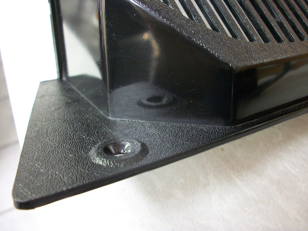

Today I spent the day finishing off repairs to the two damaged speaker housings. Much like the door cubby but I discovered they are made of the same plastic as the rear light housings. Since I polished them with Brasso to a fantastic shine I gave the speaker housings a go too. There are multiple repairs where I’ve glued them back together and made new bits to fit in where parts were lost, so a 1200 grit wet and dry was require over the joins before the Brasso.
I’m really pleased how they’ve come out, and challenge anyone to spot the repairs!
(IMG:http://www.914world.com/bbs2/uploads_offsite/i265.photobucket.com-18255-1467144812.14.jpg)
Brasso polish is wonderful on this type of plastic for turning a sows ear into a silk purse.
(IMG:http://www.914world.com/bbs2/uploads_offsite/i265.photobucket.com-18255-1467144813.15.jpg)
With the housings all done now I riveted the new speakers into the newly made mounting plates as per the ones I’d removed. The rivet heads were blacked out with a little paint and left to dry.
(IMG:http://www.914world.com/bbs2/uploads_offsite/i265.photobucket.com-18255-1467144813.16.jpg)
Due to the numerous bits of stainless re-enforcing plates behind the plastic housings, I had to cut out a small relief in one of the speaker plates to give clearance for it to fit (top plate in picture)
At lunchtime today I called ahead and found a supplier with black material in stock to cover the face of the speaker and plate. They cut half a metre off the roll which was the smallest amount they do and asked for 49p I gave them a pound £ and said keep the change.
The plan for tomorrow is to cover the face of the speakers and fit them in the housings ready for assembly at the weekend.

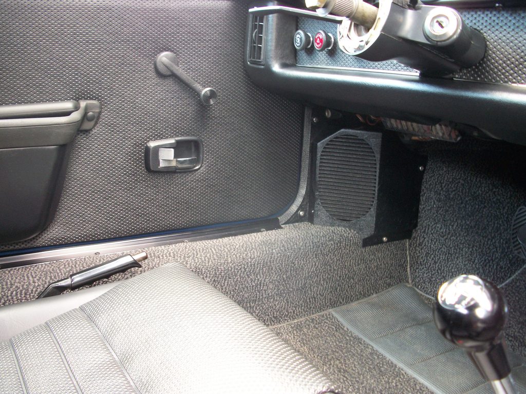

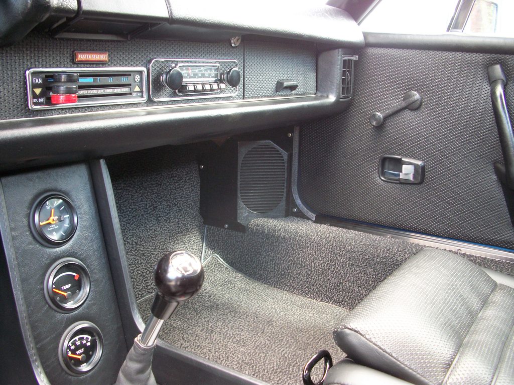

Today I fitted the speaker cloth to the new speaker mounts and fitted them both into the housings ready for putting into the car tomorrow. It was a busy day (& week) at work so I was late home tonight and after food shop it was almost 9pm before I could start on the 914, but at least I got an hour in and finished the speakers off.

Once back in the stainless trim was close up to the basket weave and I could finally fit the rebuilt speaker grilles and test the Blaupunkt. All good!
(IMG:http://www.914world.com/bbs2/uploads_offsite/i265.photobucket.com-18255-1467144813.17.jpg)
(IMG:http://www.914world.com/bbs2/uploads_offsite/i265.photobucket.com-18255-1467144813.18.jpg)
I also fitted the repaired false cubby to the passenger door. Again it fought me for a while trying to get the 3 screws to find the holes in the steel of the door. I had to take it on and off a few times and add a little vertical pressure and use a scriber down the holes to guide it in. I didn’t want to drill any more holes in the door for the screws but after a frustrating half hour I got the first one in. After that the remaining two followed with ease.
All that’s left now is the steering wheel and the interior will be complete.

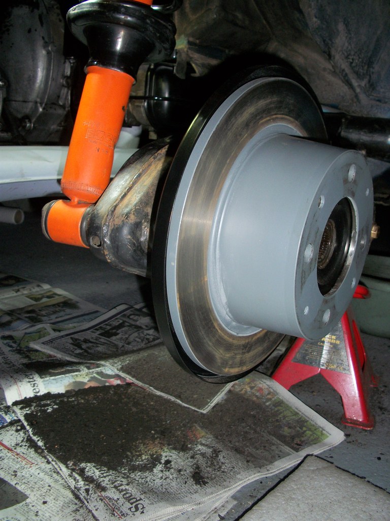

With it eventually clean, I pushed the car back into the garage and placed it on four axle stands.

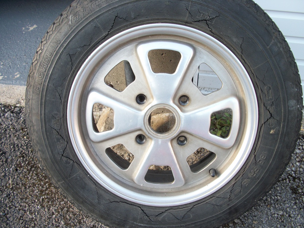

This was a small milestone in the restoration. I’d wanted to get the wheels refurbished for a long while now but having to have the doors wide open refitting interior I need to be able to keep pushing it in and out of the narrow garage so the wheels had to stay on.
The plan now is to take them into work and get the tyres off at lunchtime so they can have the anodising electrochemically removed for selective polishing.
In the meantime while they are away over the next couple of weeks I hope to clean and refresh under each wheel arch and complete a few remaining mechanical jobs.

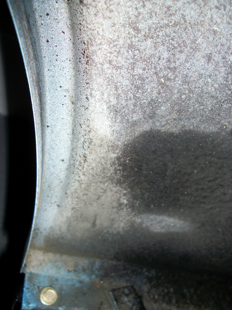

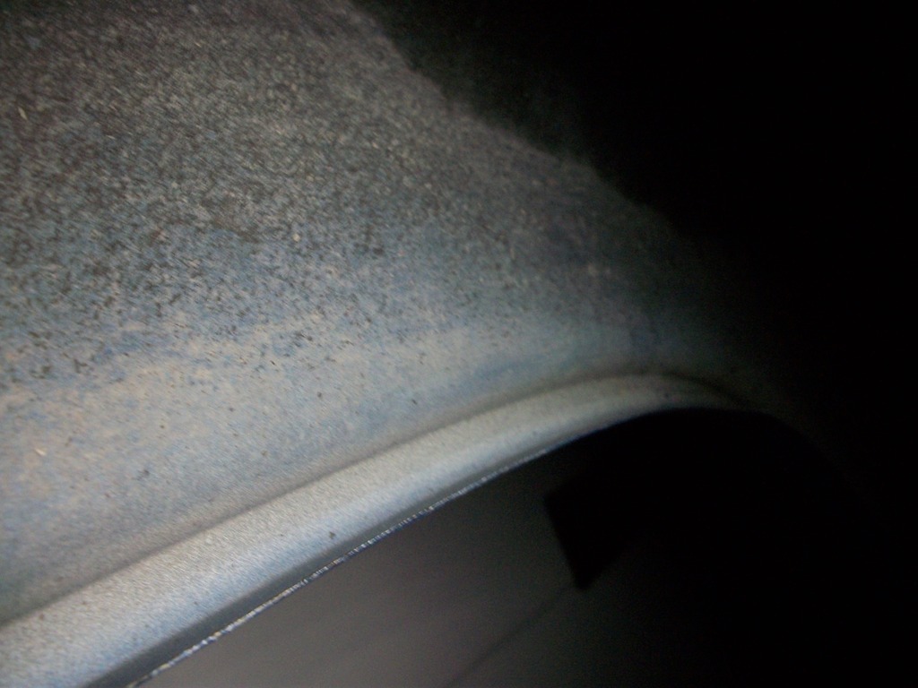

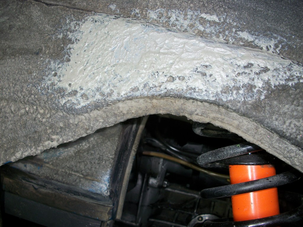

Getting back home I started by cleaning under a wheel arch of the 914.
The PO (a one owner car from new) had had the car spray undersealed by Porsche when it was new. This is a black coating and is everywhere under the arches and over the floor pan. Good news to stop it from rusting when new, but a bit of a pain now 41 years later when some of it has flaked off.
There are sections where it falls off in flaky sheets to reveal nice shiny Alaska Blue paint underneath as they must have just sprayed it on without keying the surface.
I have a quandary now.
Do I spend the rest of my days scraping it off with a plastic scraper or do I remove the loose and re apply new all over?
My OCD would like to see mirror polished blue paint under the car, but if I do this I’d be too scared to use and enjoy the car. Since this was a dealer option do I just re coat it all (knowing that the shiny blue paint and good metal is underneath?)
Anyway after a couple of hours with my head inside a wheel arch, looking like I’d been down the mine, I called it a day, and swept up all the loose scrapings with a brush and pan.

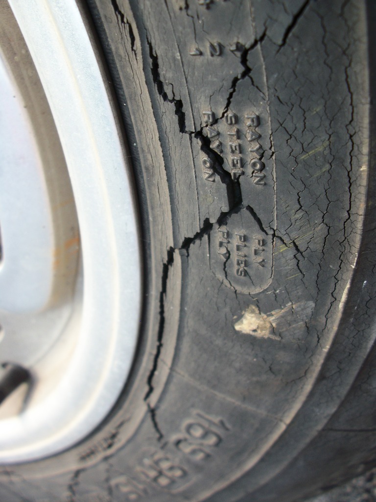

I thought I’d take a quick picture for the records of the California Desert Sun UV and age degraded tyres.
(IMG:http://www.914world.com/bbs2/uploads_offsite/i265.photobucket.com-18255-1467144813.19.jpg)
And in close up…
(IMG:http://www.914world.com/bbs2/uploads_offsite/i265.photobucket.com-18255-1467144814.20.jpg)
I’m gobsmacked that the shipping company pumped these up with air to load the car almost a year ago and NONE of them have gone down in that time.
Loading on the flat bed truck to take it to the paintshop made me flinch a little when the ratchet straps pulled down on them, but nothing….they just kept on holding air pressure.
Unfortunately I think the Ministry of Transport inspector would have something to say if I kept them on the car. Even if I did like Anthony Hopkins did in “The worlds fastest Indian” movie and filled all the cracks with boot polish, I don’t think it’d be wise to drive on them.

Day 253
Today I took the 5 wheels over to my local tyre fitters at lunchtime and got the tyres taken off. They tried to lecture me on how dangerous the tyres were to drive on! I had a bit of fun telling them I wanted to put them back on the car when my wheels had been refurbished so that I could keep the car original for concours purposes...the chaps face was a real picture!

I’m still amazed by the condition of the bodywork on this 41 year old car. Having cleaned mud, dust, spiders webs, leaves, pine needles and lots of fine desert sand from the textured underseal there is no rust anywhere I can see.
Here’s a picture from inside the rear wheel arch looking outwards behind the arch return edge, had this been a European car it would have started to rust within months with such a thin coat of paint and missed completely with the underseal.
(IMG:http://www.914world.com/bbs2/uploads_offsite/i265.photobucket.com-18255-1467144814.21.jpg)
Looking down the arch to the bottom where it meets the longs/sill, it’s absolutely solid here. Unbelievable when you think this is where all the mud and dirt collect on the horizontal ledge. Washing and cleaning it all out I couldn’t fault the car anywhere.
(IMG:http://www.914world.com/bbs2/uploads_offsite/i265.photobucket.com-18255-1467144814.22.jpg)
With the white primer showing through a dusting of blue paint and missed entirely with the underseal (due probably not being able to get in at the right angle to spray it) I will certainly get in there and make sure its coated with maximum black Waxoil to keep it from rusting in our UK climate.
Despite all the hard graft in getting it super clean before applying the waxoil, it’s certainly worth the effort when you’re working on an old car in this superb original condition.

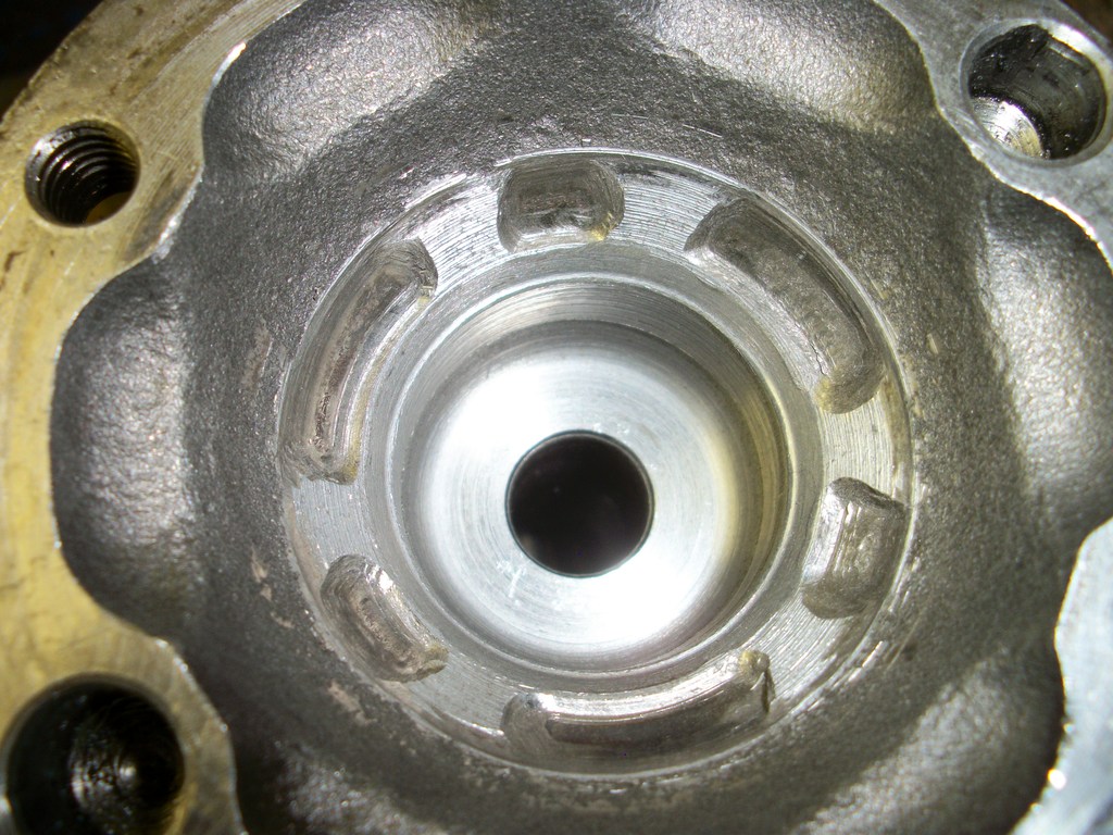

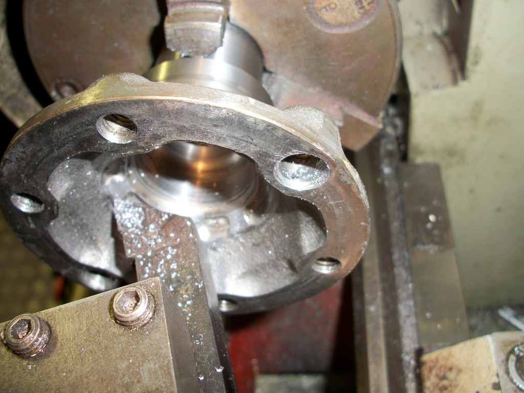

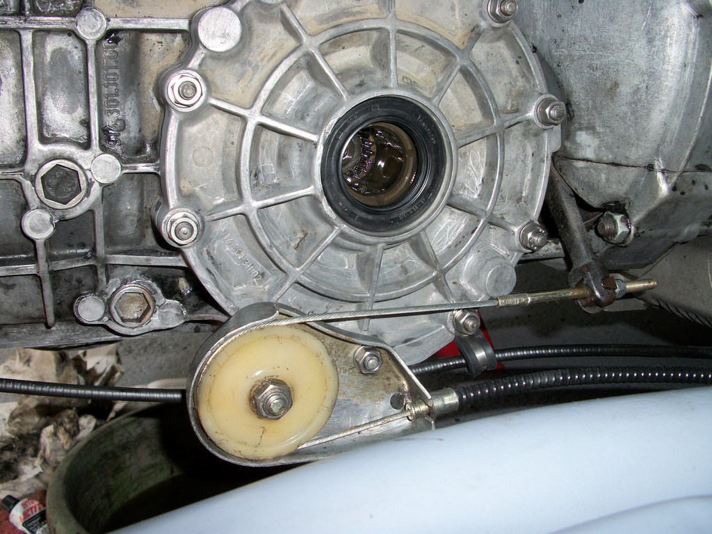

Today I started to replace the Driveshaft seals on the gearbox. After a bit of a struggle with the CV joint bolts They came out to reveal some very dry molybdenum grease and on further inspection the CV boot rubbers had started to perish at the base of the concertina mouldings. To be fair by the state of the grease they need stripping down cleaning and re-packing with grease, so it’s a good time to replace the boots. (Will order some up on Monday)
To ease access of cleaning (and to do it properly) I removed the castleated nuts and pulled out the hub shafts with the driveshafts. In this way I can get all the crusty old grease out of them and also clean the dirt and sand from inside the large hole in the trailing arms later in the week.

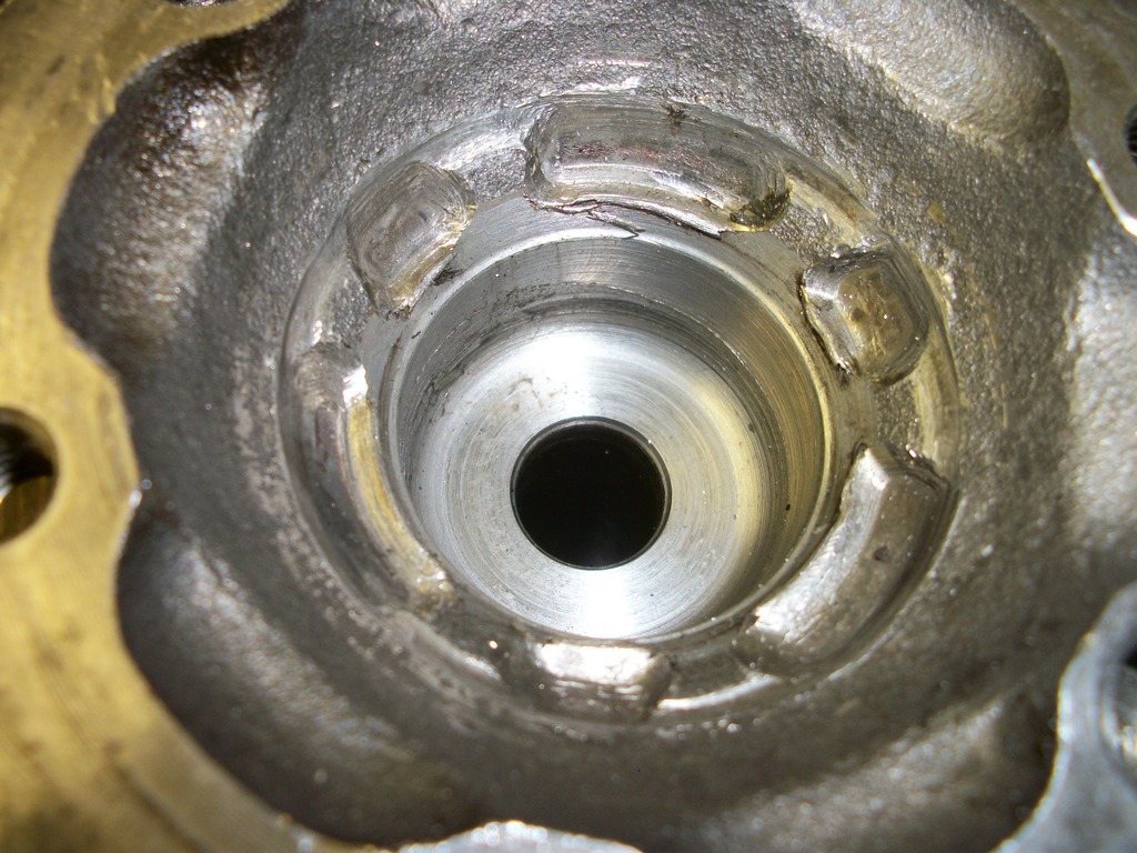

Next I removed the O/S drive flange from the gearbox to access the first lip seal. I cleaned the old grease out of the recess in it and almost cut my finger.
(IMG:http://www.914world.com/bbs2/uploads_offsite/i265.photobucket.com-18255-1467144815.23.jpg)
All around the inside chamfer there was rubbing and burring? I cannot see how this could of happened unless the CV joint had failed/Circlip come off in the past or shims had been required and been lost?
The oddest thing is that there is no visible wear on the CV joint that was attached to it? I inspected the other end of the driveshaft in case someone had taken them out in the past and put them back the otherway around. (inside to outside) but no wear on either end? The only explanation I can think of is that a CV joint may have been replaced in the past.
Despite the wear not getting in the way of anything, I wasn’t keen having the mushroom burrs on the flange because if they broke loose; small bits of metal could get into the CV Joint and ruin it.
I put the flange in my lathe and turned down the burrs so that they were gone.
(IMG:http://www.914world.com/bbs2/uploads_offsite/i265.photobucket.com-18255-1467144815.24.jpg)
This was the easiest way I could think of the get down inside the flange to remove them. I was careful not to machine the “dents” out as this would take too much metal off and could possibly weaken the flange. Just taking off bad burrs would be enough. Finally I gave the outer casting of the flange a coat of thin waxoil to protect it.
(IMG:http://www.914world.com/bbs2/uploads_offsite/i265.photobucket.com-18255-1467144815.25.jpg)

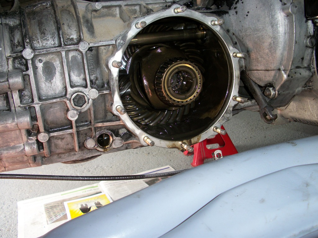

With the drive flange off I had new seals and a new O ring so I took the differential cover off so that I could inspect the bearings, gears and clean out the sump of the gearbox.
(IMG:http://www.914world.com/bbs2/uploads_offsite/i265.photobucket.com-18255-1467144815.26.jpg)
All mechanical parts looked good, but there was a fair bit of sludge in the bottom of the gearbox casing that simply taking out the drain plug wouldn’t remove. I cleaned it all out so that it was spotless before turning my attention to the cover that holds the lip seal.
With this removed it was very simple to drive the lip seal out from behind without risking any damage. Once out I cleaned everything up. I’ve been slowly cleaning the engine, gearbox & suspension. When the car was originally undersealed they sprayed it everywhere and splattered everything. It was even on the outside of this diff cover plate! With it off and on the bench I was able to clean it much easier so took the opportunity and then carefully fitted the new lip seal.
With the gearbox cleaned out and dry I fitted the new O seal and put the cover back on and refitted & adjusted the clutch cable. (Need to get a new gaiter for the cable too)
(IMG:http://www.914world.com/bbs2/uploads_offsite/i265.photobucket.com-18255-1467144816.27.jpg)
Need to get a new dust cover for that clutch cable end.
Finally I refitted the RH drive flange with a tiny application of new gear oil on the seal & shaft and tightened up the bolt.
LH tomorrow.

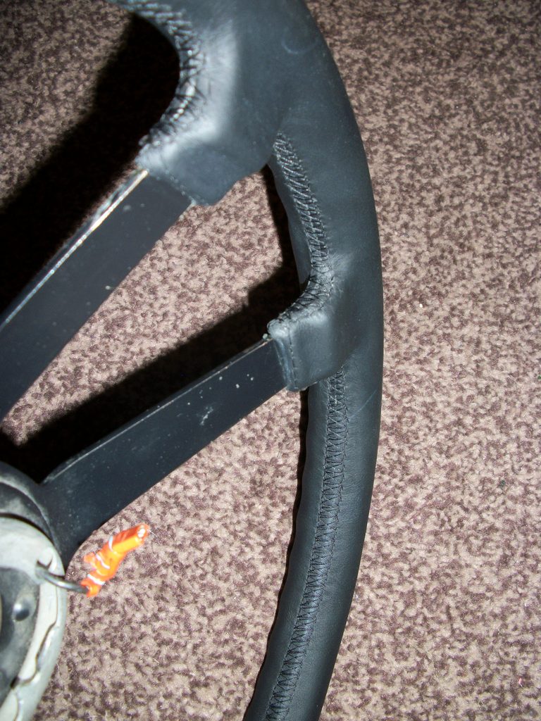

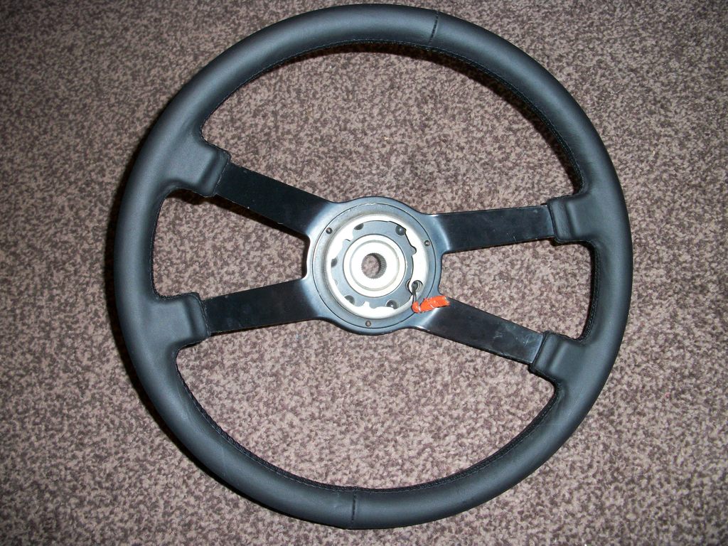

Today I picked up the leather covered Steering Wheel. I’m still not 100% happy with it, but I don’t think I’ll get any further with them now. In all fairness I have got this done in exchange for a favour so no money exchanged hands. The stitching is much better now but for some reason they put two joins (top & bottom) in the leather rather than the one I wanted?
In the scheme of things its better than having a UV sun perished crumbling steering wheel, but I know the two join thing will bug me in my OCD kinda way!
(IMG:http://www.914world.com/bbs2/uploads_offsite/i265.photobucket.com-18255-1467144816.28.jpg)
(IMG:http://www.914world.com/bbs2/uploads_offsite/i265.photobucket.com-18255-1467144816.29.jpg)

I also took a picture of a localised underseal repair in the LH rear arch, to help explain what I described a few posts ago. The chipped, flaked and missing underseal has been locally touched in and the texture replicated. By the weekend it’ll have had a whole week to dry properly so that I can black it out along with the whole of the inner arches to return it to the same appearance as the car had when it was new (but a bit tidier and not splattered everywhere like it was).
(IMG:http://www.914world.com/bbs2/uploads_offsite/i265.photobucket.com-18255-1467144817.32.jpg)
