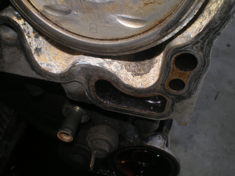

When we returned from Rt66 '16 I pulled my exhaust system down for a little trimming and noticed water in the left bank muffler! (IMG:style_emoticons/default/WTF.gif) We did drive through a ton of water on that trip. Then when returning from Costco yesterday it acted as if it were starved for fuel when it stumbled during acceleration. The fuel filter was the same one that came on the engine so I ordered another one. When I looked at the filter to check which one I had I noticed the coolant level in the expansion tank/reservoir had dropped. Well, there you are. Head gasket time. Now, I'm wondering if the stumble was due in fact to the head gasket failing? Decisions; should I fix this one which presently has ~ 185K or buy a JDM replacement. After perusing the net I found a few peep's whose JDM experience was less than stellar. Apparently it is a crap shoot as to what you get and the 40-50K avg mileage is (IMG:style_emoticons/default/bs.gif) . So, for about 1K I can pick up another engine and hope I bought a good one or open this one up and hope that is all it needs since it wasn't overheated. What does the the Wasser family think?
EDIT: It's an EZ30D 6cyl

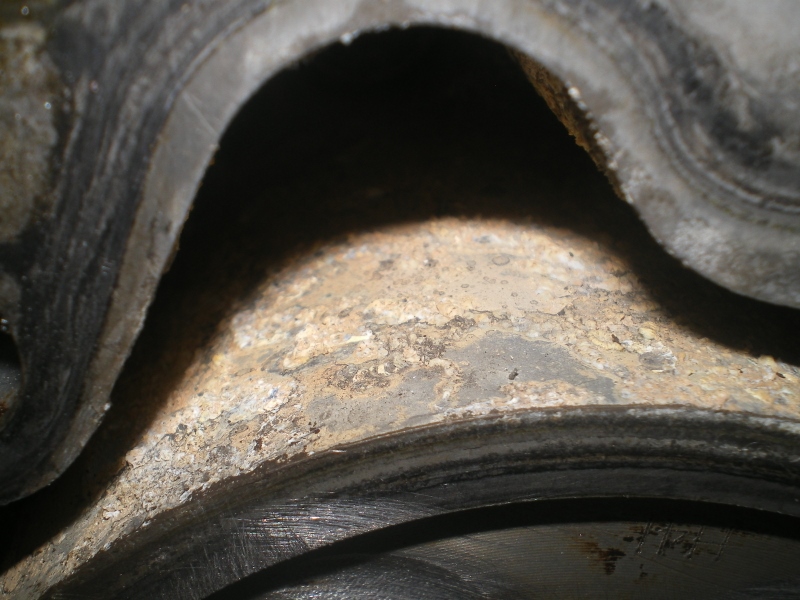

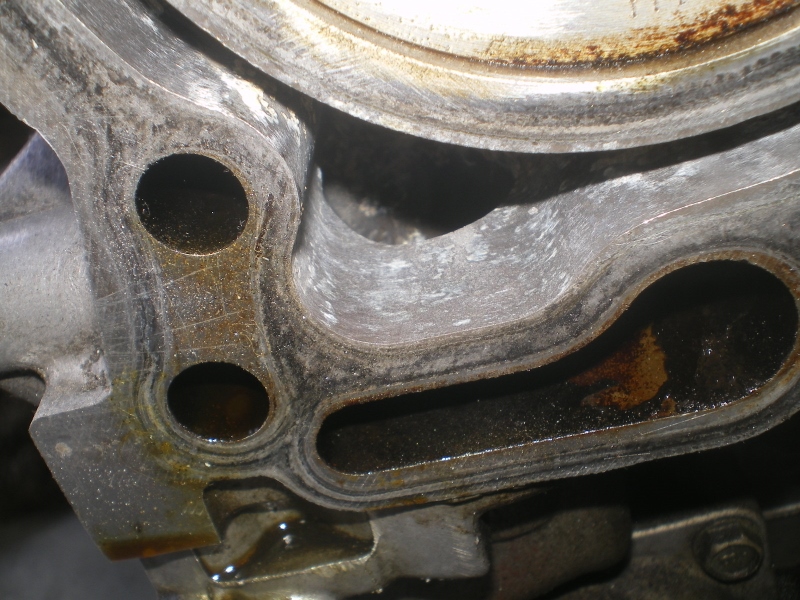

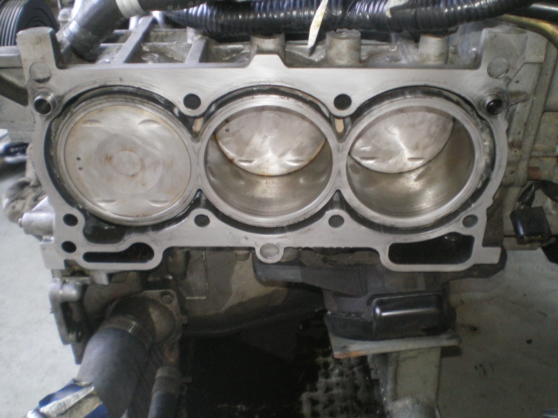

Finished cleaning except the pan and that can wait till it's back in the car. It's difficult to access so close to the ground. My OCD kicked in when I saw the deposits in the water passageway's.

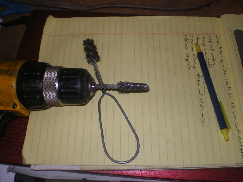

A before n after pose of the sacrificial 1/2" fitting brush. The trick is to clean the wider aeas 1st then go small because the brush won't expand once it's collapsed.
Got about 99% of it. My water temps were fine but this is better. (IMG:style_emoticons/default/biggrin.gif)

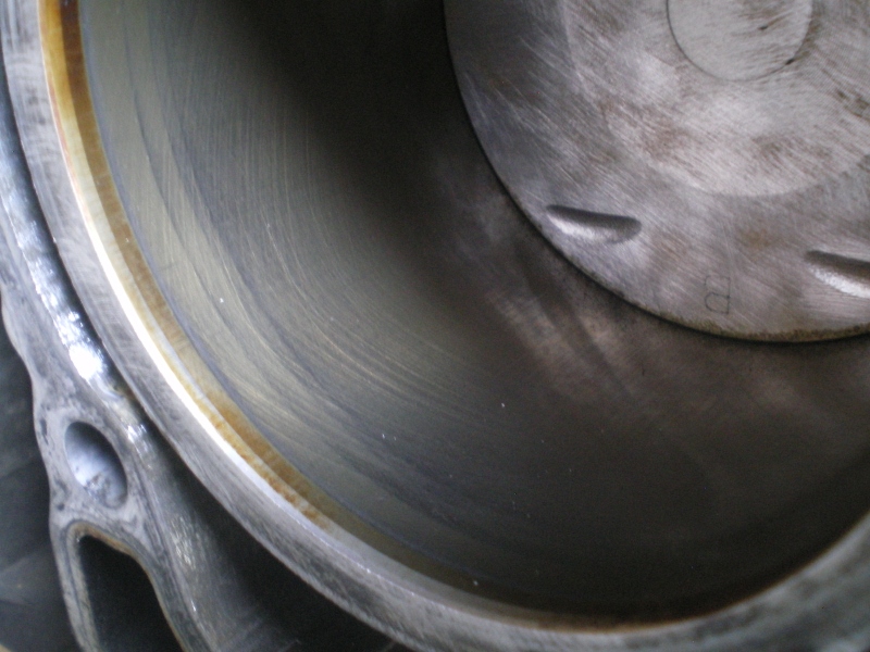

The wear isn't bad either. Never did use oil and I can still see the cross hatching from the hone. Doesn't show in the pic.

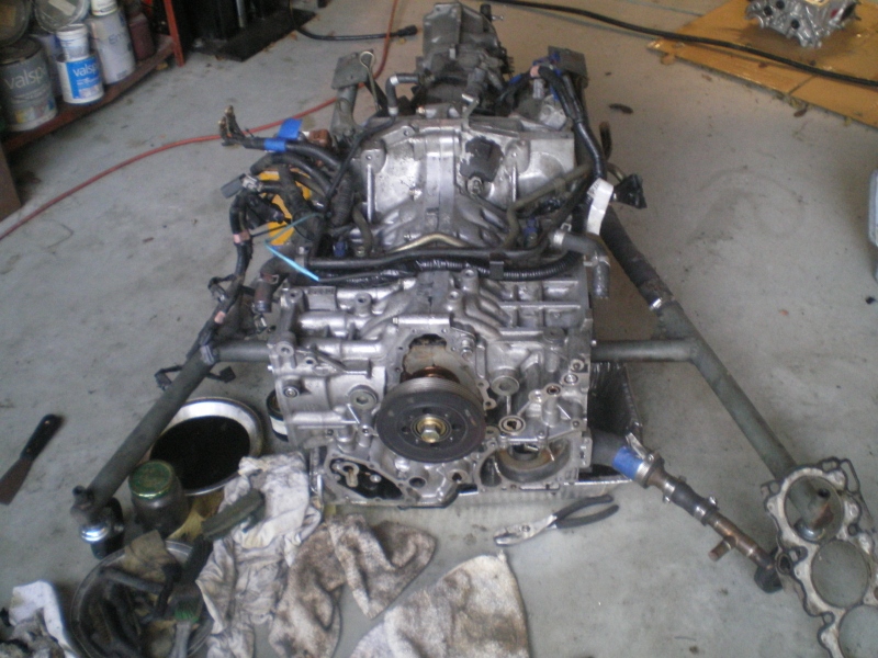

Finished cleaning the top half of the case.
Got it ready to hang the heads back on.
