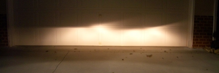

H4 against the garage door

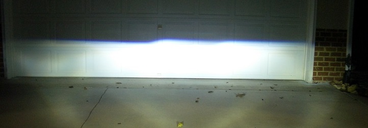

LED against the garage door

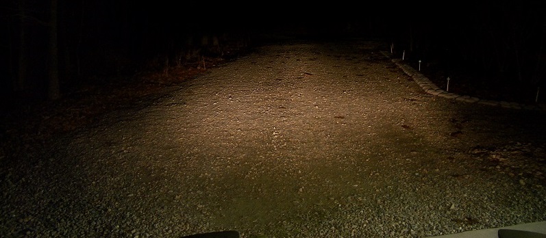

H4 in the driveway

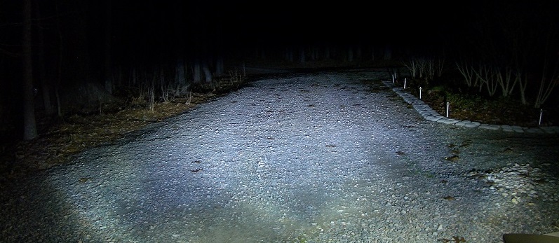

LED in the driveway
