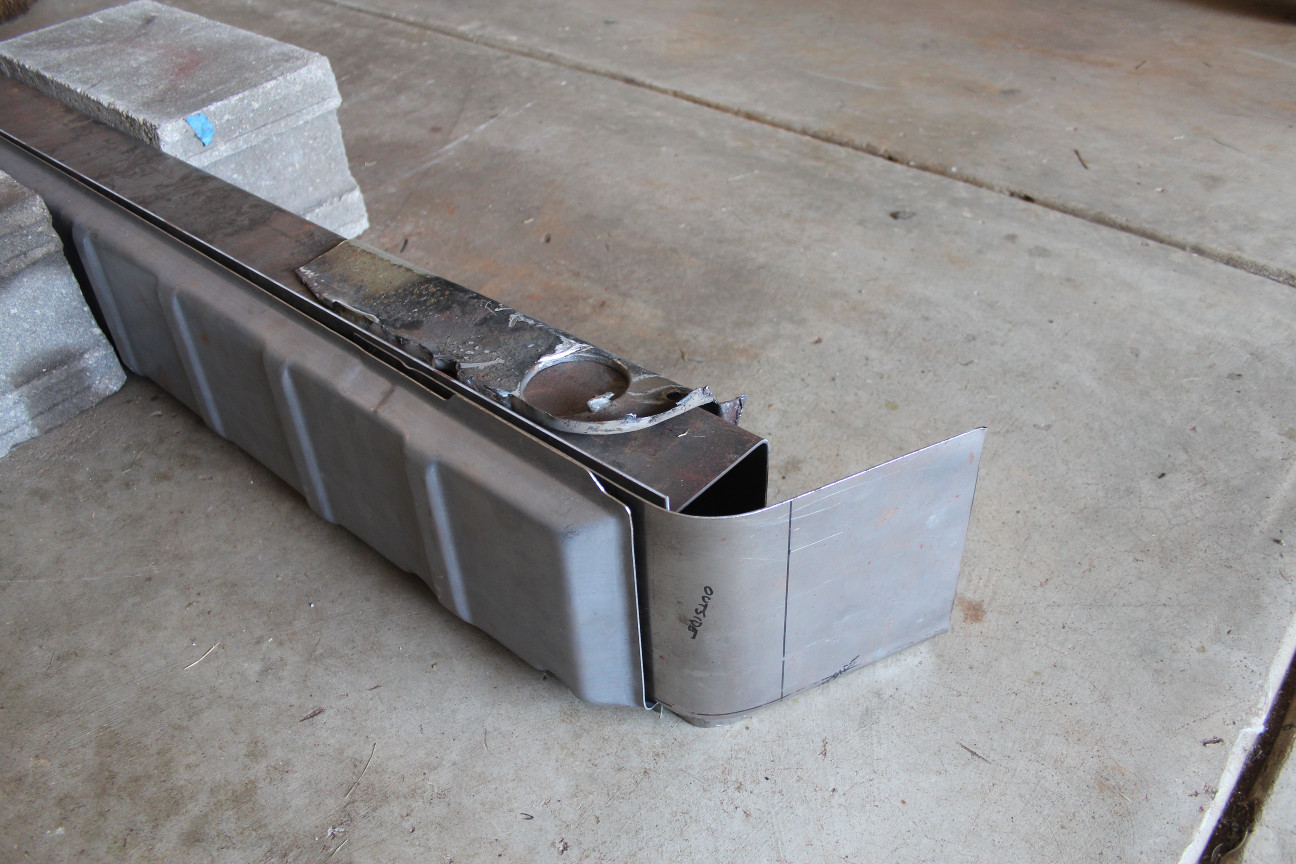

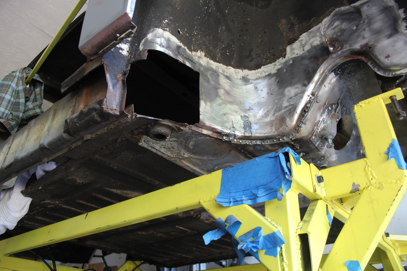

Front passenger corner is pretty much rebuilt and strong, ready to support the front end of a brand new long.
That gaping hole that's left needs to have a piece that wraps around the corner and then extends into the long. I.e., it will be sandwiched between the two halves of the long. Here's the piece with the two halves:
More on this later. The next step is to get the old long out of the way so this piece can be added in first.
