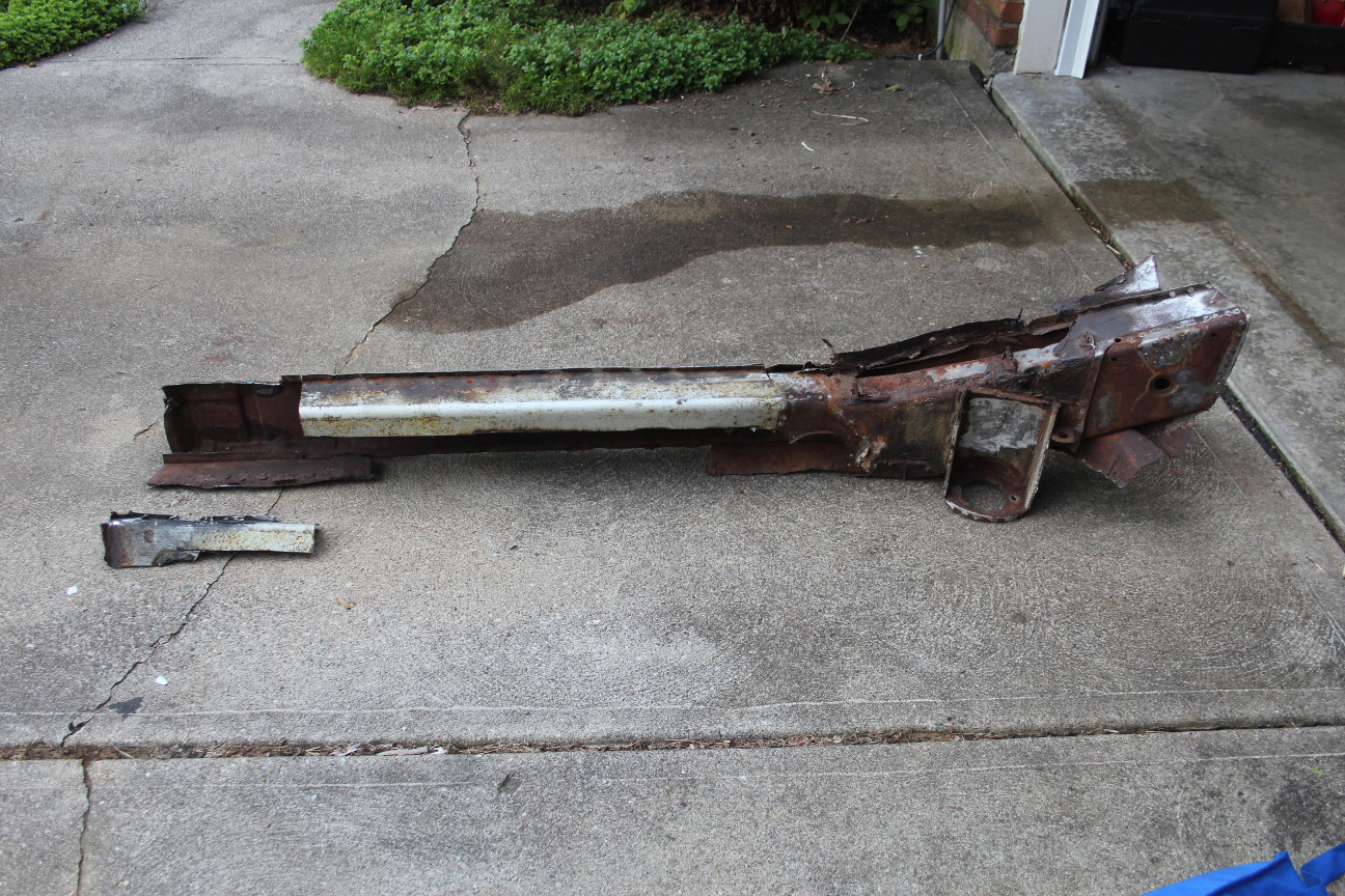

Anatomy Autopsy of a long...
Here's the whole thing as it came out. You see a lot of it missing with straight edges as if it were cut away. In reality, this was mostly rusted away and the jagged rusty edges were just trimmed off.

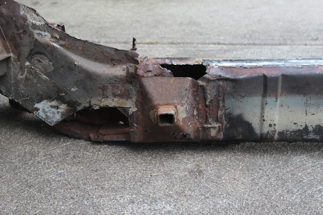

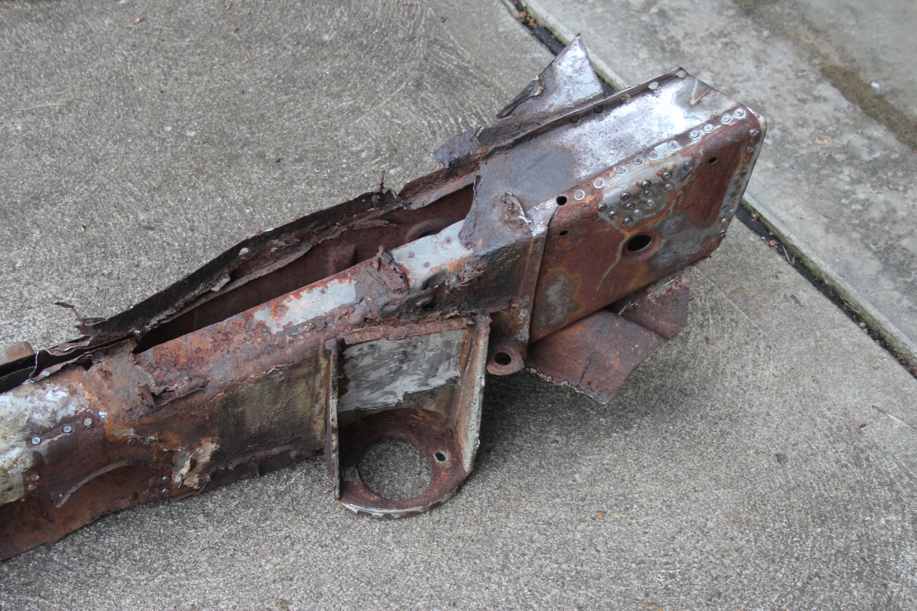

Condition of the motor mount. Going to remove this and clean it up, see if it can be saved. The hole on top was covered by a couple rectangular patches that looked like the were hammered in place and welded on- I think I posted pics earlier. Took them off when I cut out the engine shelf.
Condition of the pylon. Don't think this can be saved. There's a nest inside it, I'm afraid it is corroded from the inside beyond help. Have a little wager whether I'm going to find a little mouse skeleton inside.
Patchwork around the jack point. I was more critical of the previous work on this until I start welding my own patches in. (IMG:style_emoticons/default/sad.gif)
