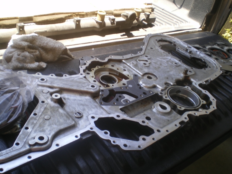

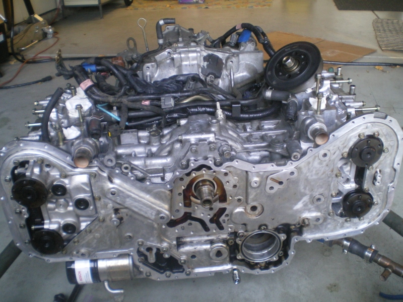

Since I have to wait a few days for 6ea 8mm allen bolts and a rubber hose kit I might as well post where it's at for now. A little cleaner than the last time you saw it.
A pic of the rear chain cover before it was re-installed.

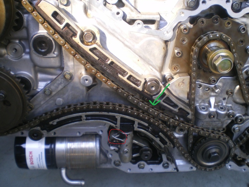

The right chain still has slack in it as shown by the green arrow. That's because I hadn't pulled the pin on the tensioner, circled in red, when these pic's were taken. Look close you can see the metal wire used as a pin.

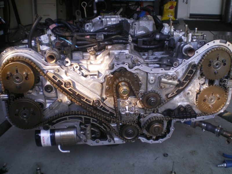

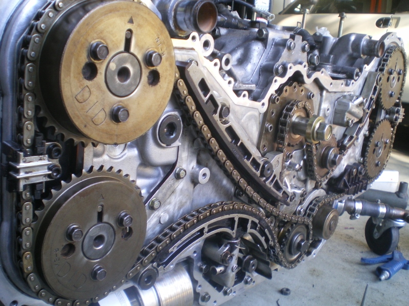

And a couple all chained out and indexed. Once I receive those 4 bolts the front cover can be re-installed then the engine can go back in. (IMG:style_emoticons/default/biggrin.gif)

QUOTE(76-914 @ Jul 7 2016, 09:18 PM) *
