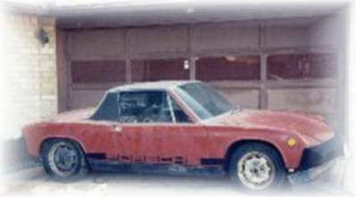

Hi 914World,
New(ish) member with new project - a 1975 2.0L. It's certainly a project, but I think it's a great starting place. The seller is extremely knowledgeable about the car and helpful with local contacts who are in the 914 scene. It's been on the local CL for a while for more than I wanted to pay, but was recently able to strike a deal. Here are some specs about the project:

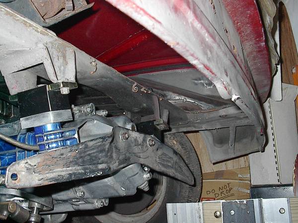

  • "Rust Free" car with the only rust being on the surface of cleaned metal
  • Hell-hole looks very clean
  • All original glass, bumpers, interior, suspension, rims, etc. are included
  • 901 "side shift" transmission has been taken apart, inspected, and rebuilt
  • Lowered hard mounts for drivetrain
  • There are some spares included as well (doors, top, misc. / etc.)

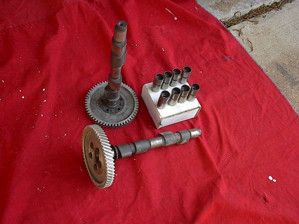

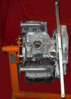

The engine is the gem of this purchase in my opinion. Here are the details:
2055cc "build" project in pieces currently (with matching numbers)
  • All balanced / clearance as necessary by H&H in Dallas
  • 96mm Pistons / Cylinders
  • 9.0:1 compression ratio
  • 3-angle valve job on 2.0 Heads
  • Iskenderian Cams #485128 Grind #VP-228
  • Claude's Buggies' Lightened Lifters
  • Lightened Flywheel

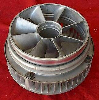

  • Custom High RPM Cooling Fan
  • Rotating assembly has been coated with polymer or ceramic coatings by Polymer Dynamics in Houston

Oops - found some additional pics from original ad:

curious about that fan with the axial flow impeller, never seen one before, who's design?
[/quote]
looks like a vw type 3 fan thrown on top
