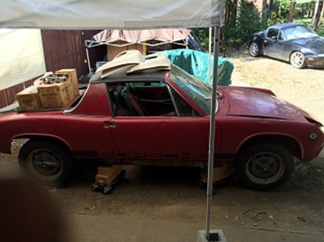

Will see what I can find out on the fan. No big update, but another pic from the seller. Going to pick her up tomorrow after work!
(IMG:http://www.914world.com/bbs2/uploads_offsite/i120.photobucket.com-19557-1468818369.1.jpg)
