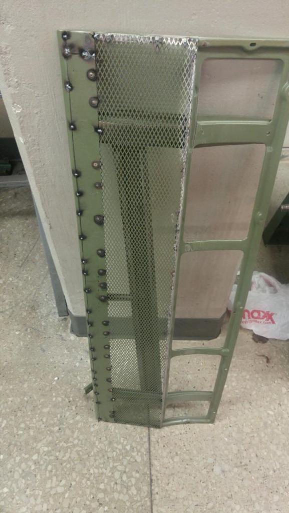

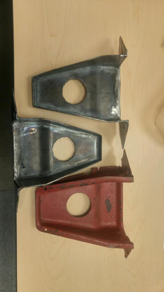

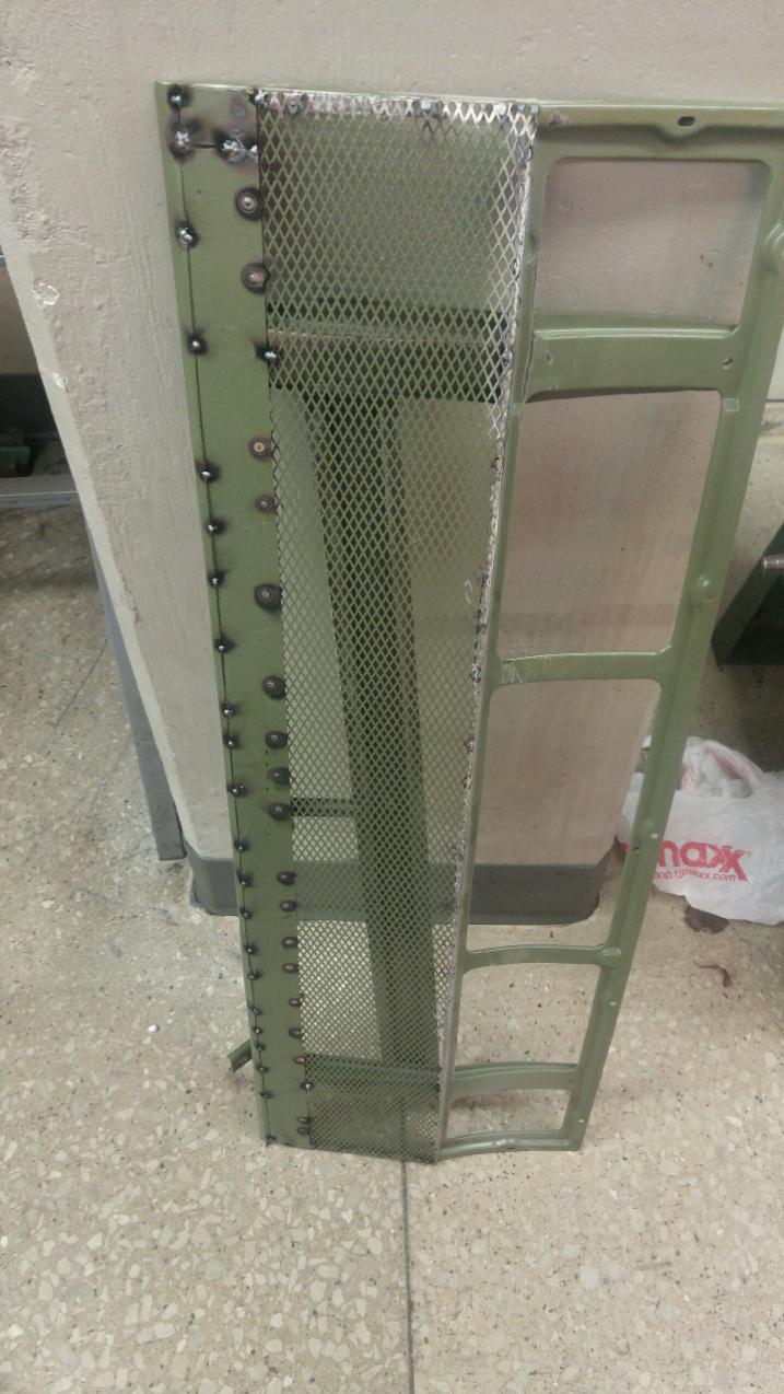

I have the rear suspension done and powdercoated, Gt lid is done. I did that a bit different then others have done but I like the way it will finish off, front struts are done, I purchased front calipers from PMB (911 sc) , chassis reinforcement is almost all welded in.. I only work on it about 45 minutes a day to keep it exciting and fun.. Made 3 engine mounts copied from an original. Going to powder coat them to keep them from rusting. Then weld areas will be ground.. Making good progress.

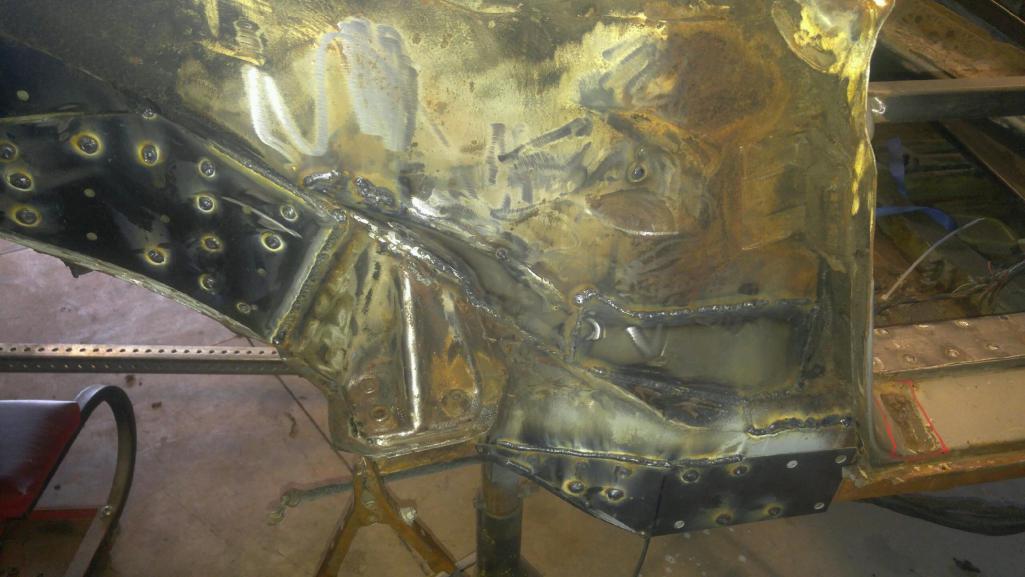

mb911   I am making progress. I have the outer driver side...   Dec 17 2015, 02:33 PM
mb911   Driver side rocker is in.. The floor pan short sec...   Dec 27 2015, 02:32 PM

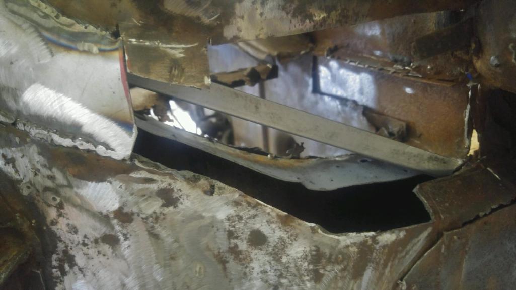

mb911   Well made some progress.. I have welded in some of...   Apr 13 2016, 09:50 AM
mb911   Gotta fab or find the cap that fits over the door ...   Apr 13 2016, 09:53 AM

396   Your reproduction of the factory bulkhead mount is...   Jul 19 2016, 04:53 PM
mb911   Your reproduction of the factory bulkhead mount i...   Jul 19 2016, 05:25 PM
mb911   Here is the engine side before I finished and powd...   Jul 19 2016, 05:30 PM
