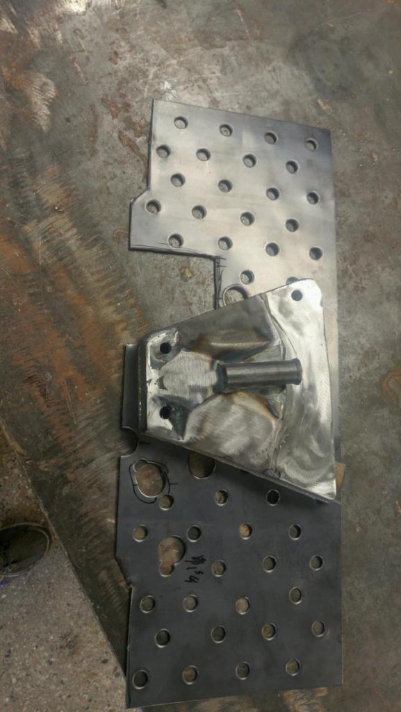

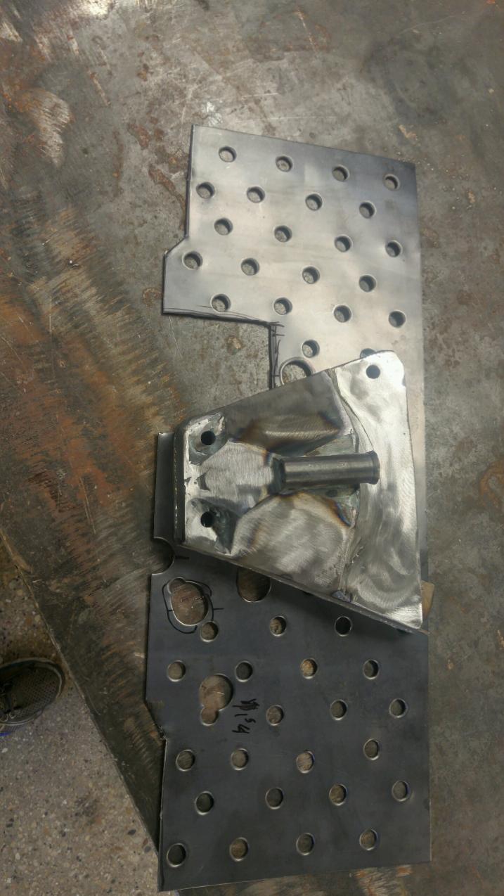

mb911   Been up to some more work. I have the rear ...   Jul 19 2016, 04:37 PM
raynekat   Been up to some more work. I have the rear su...   Jul 19 2016, 05:23 PM
mb911   Been up to some more work. I have the rear s...   Jul 19 2016, 05:31 PM
396   Your reproduction of the factory bulkhead mount is...   Jul 19 2016, 04:53 PM
mb911   Your reproduction of the factory bulkhead mount i...   Jul 19 2016, 05:25 PM
