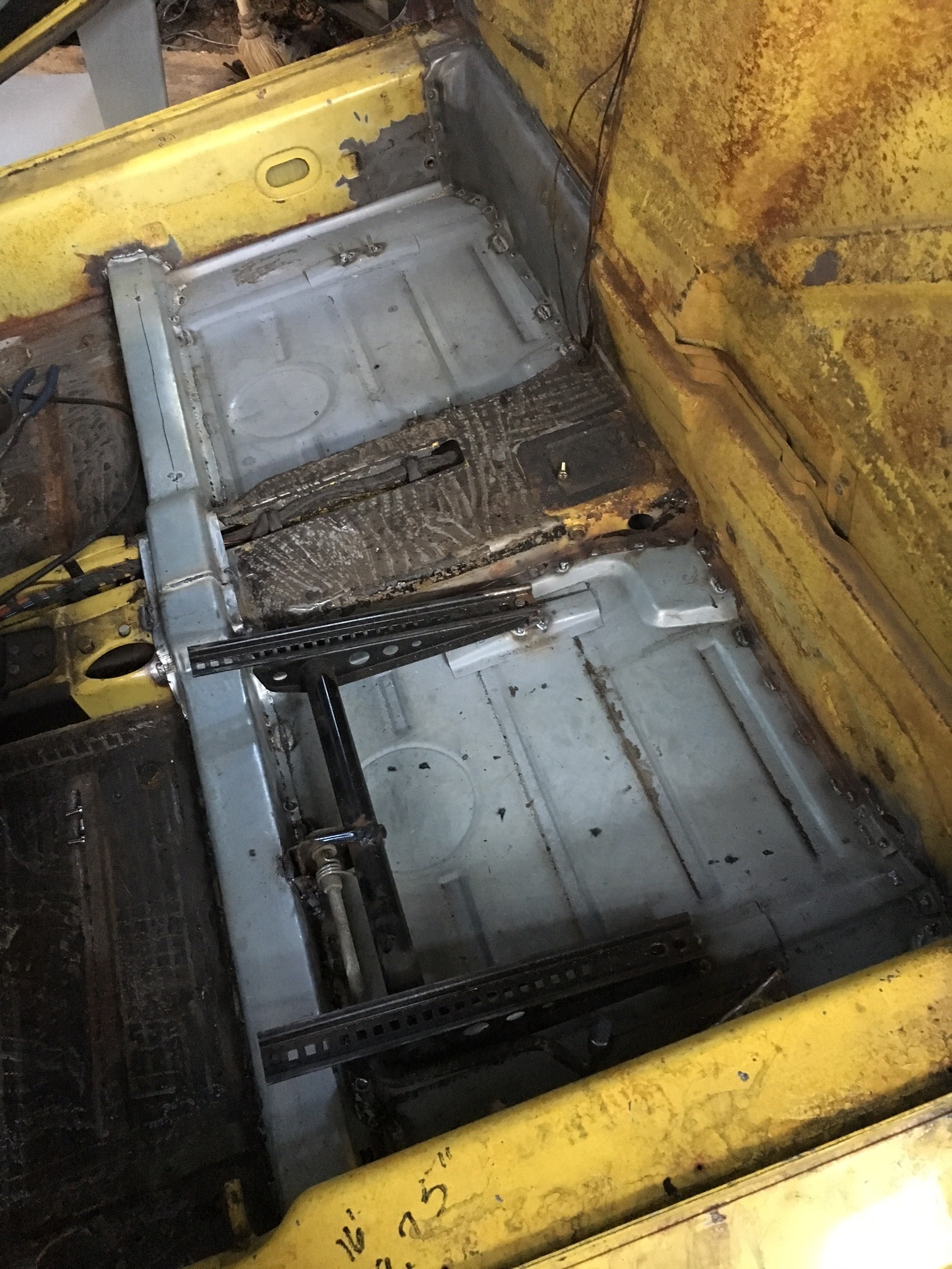

dlee6204
post Jul 19 2016, 05:53 PM
Howdy
Posts: 2,162
Joined: 30-April 06
From: Burnsville, NC
Member No.: 5,956
Got the interior floorpan complete with crossmember and seat mounts. (IMG:style_emoticons/default/smile.gif)

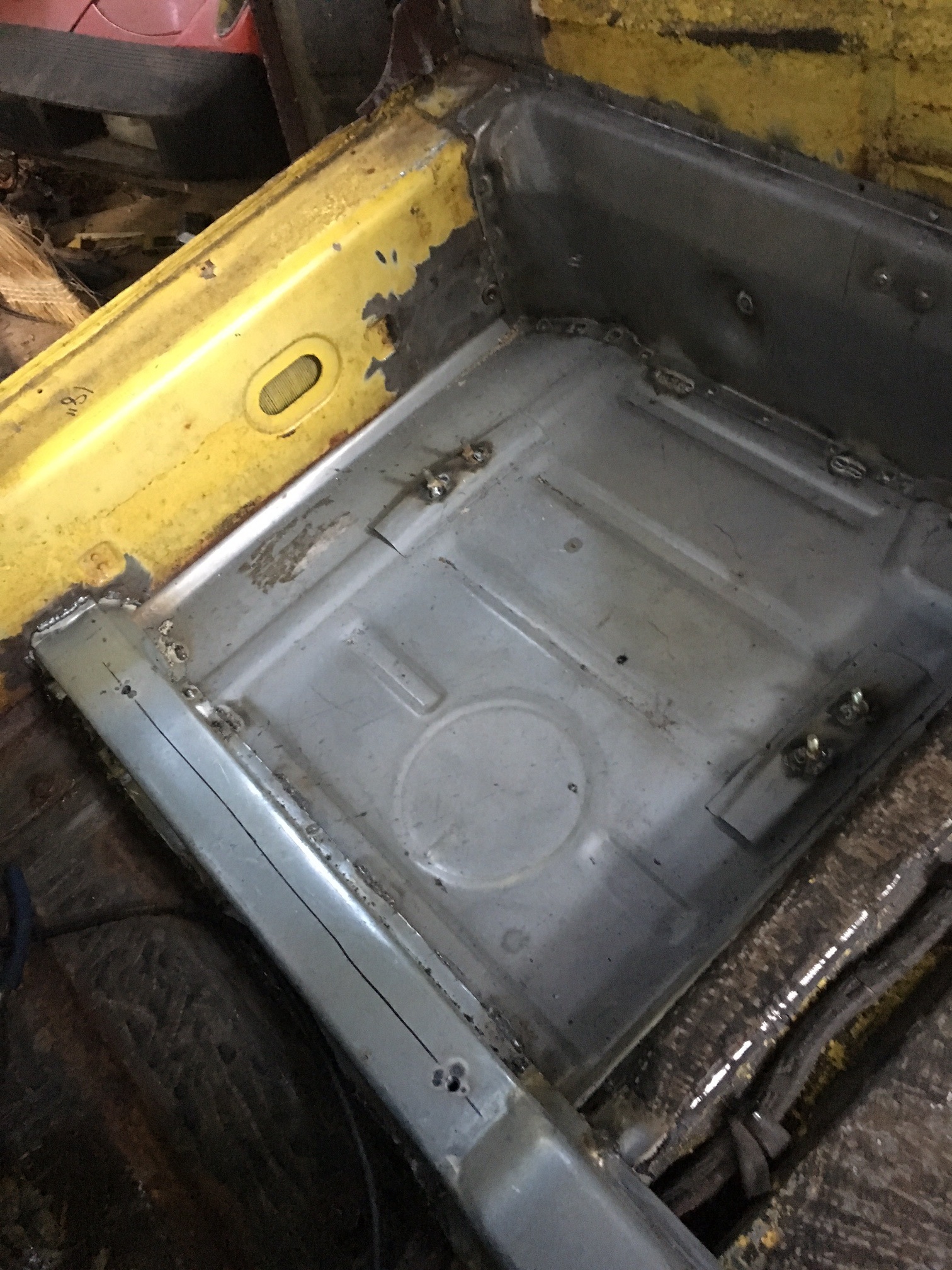

dlee6204   Started on the floorpan. I first had to trim my f...   Jun 26 2016, 02:38 PM
dlee6204   And floor pan is welded in. I still have to do al...   Jun 26 2016, 02:41 PM
