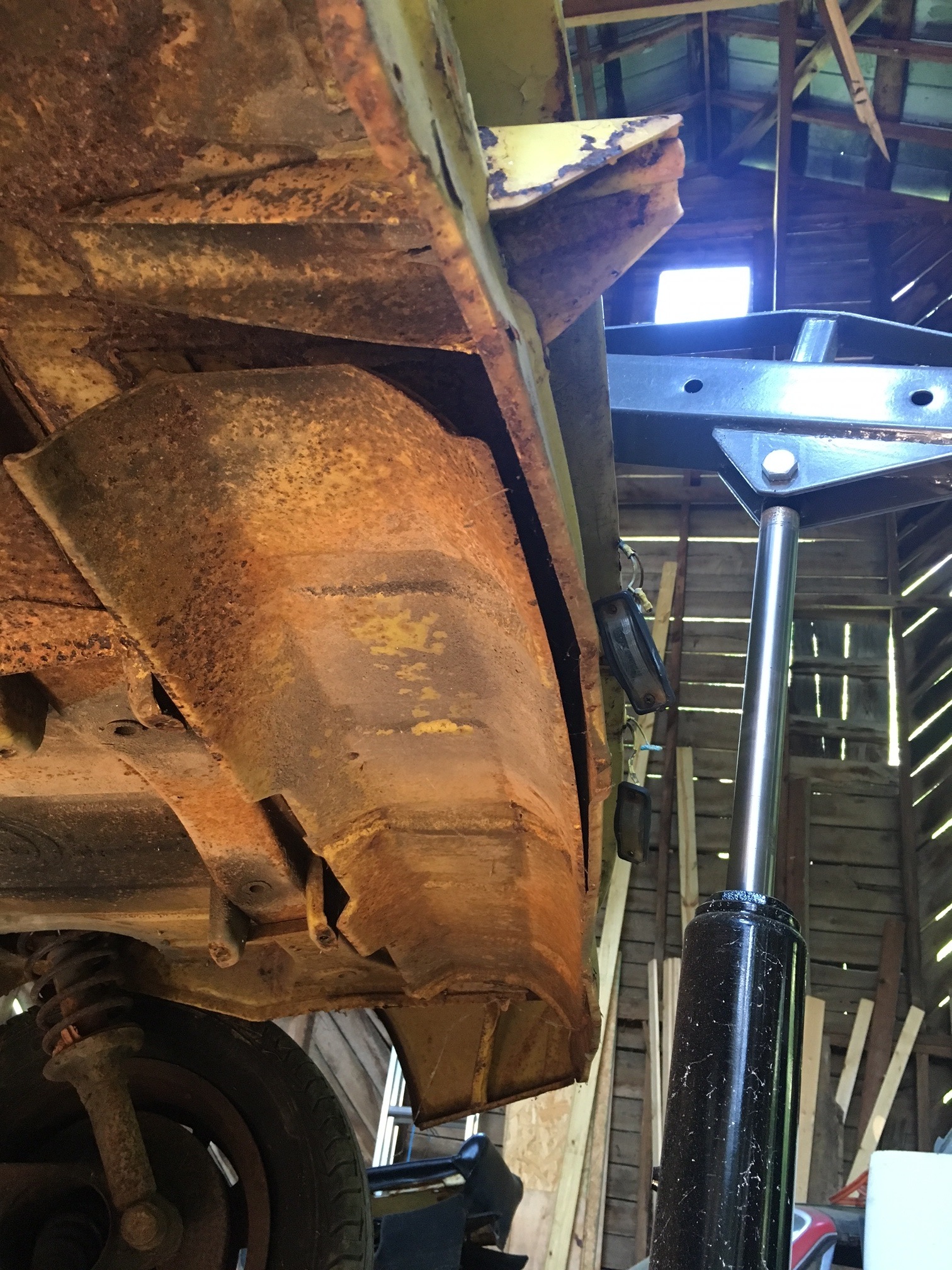

Here's the underside of the passenger long. I was able to jack the car up and door gaps didn't change (IMG:style_emoticons/default/piratenanner.gif) .... Heck, most 914s I bring home don't even have a place to jack it up anymore.

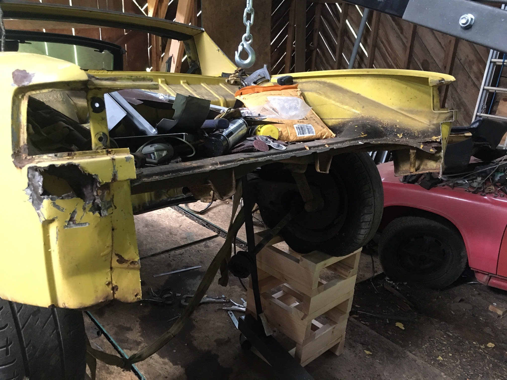

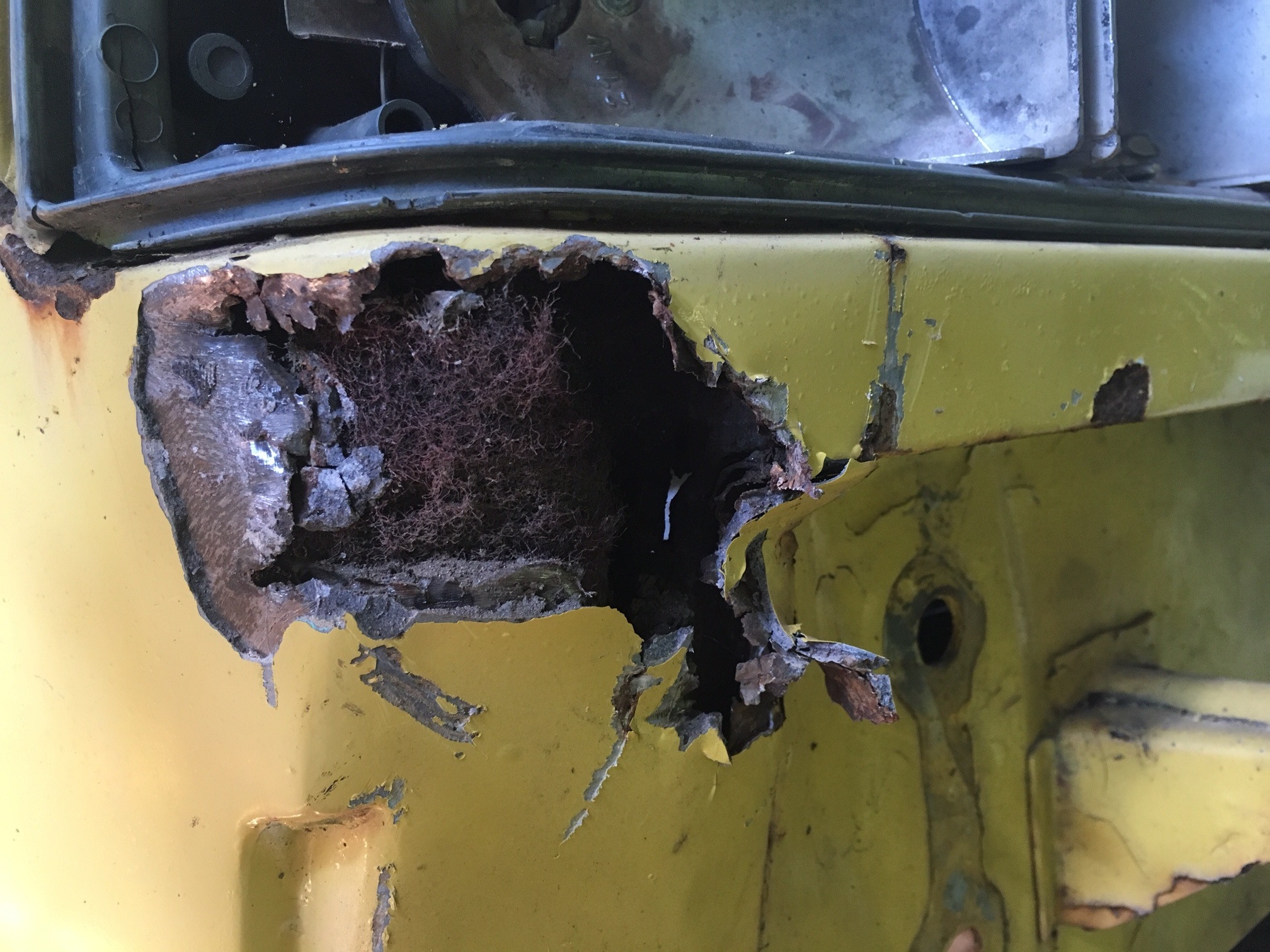

I started digging into the rear trunk area. I discovered the rear has been hit at some point. There was also some previous sketchy rust repair done to one corner. In the end I decided it was best to make some big changes.
Notice there is a scotch brite pad under the bondo. (IMG:style_emoticons/default/icon8.gif)
Notice the bump
