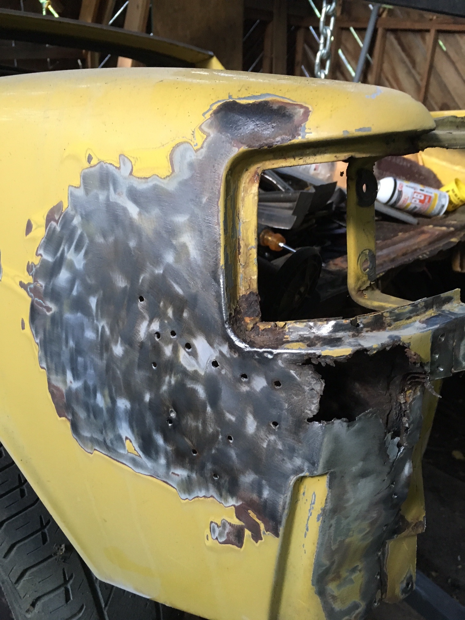

dlee6204   Well I started digging into some of the rust over ...   Mar 30 2015, 06:22 PM
dlee6204   I also found some previous bodywork damage on the ...   Mar 30 2015, 06:23 PM

dlee6204   I had to remove the bad material which meant more ...   Oct 18 2015, 06:24 PM
dlee6204   So I used this technique to remove all the bad mat...   Oct 18 2015, 06:28 PM

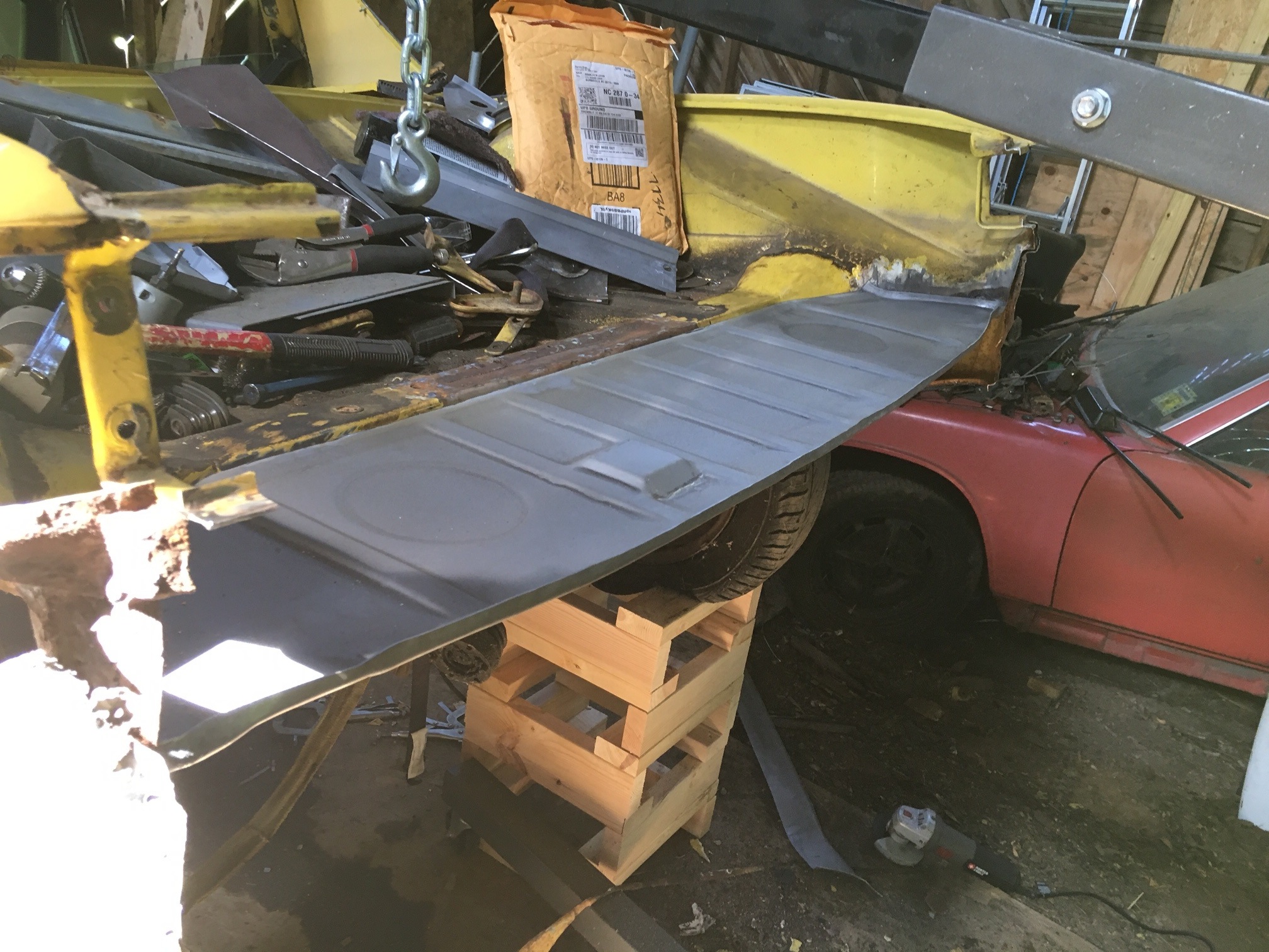

dlee6204   I started digging into the rear trunk area. I dis...   Jul 19 2016, 06:10 PM
dlee6204   Full damage exposed. Luckily the old chassis nu...   Jul 19 2016, 06:16 PM

dlee6204   I cut a replacement panel off a parts car and befo...   Jul 19 2016, 06:40 PM
