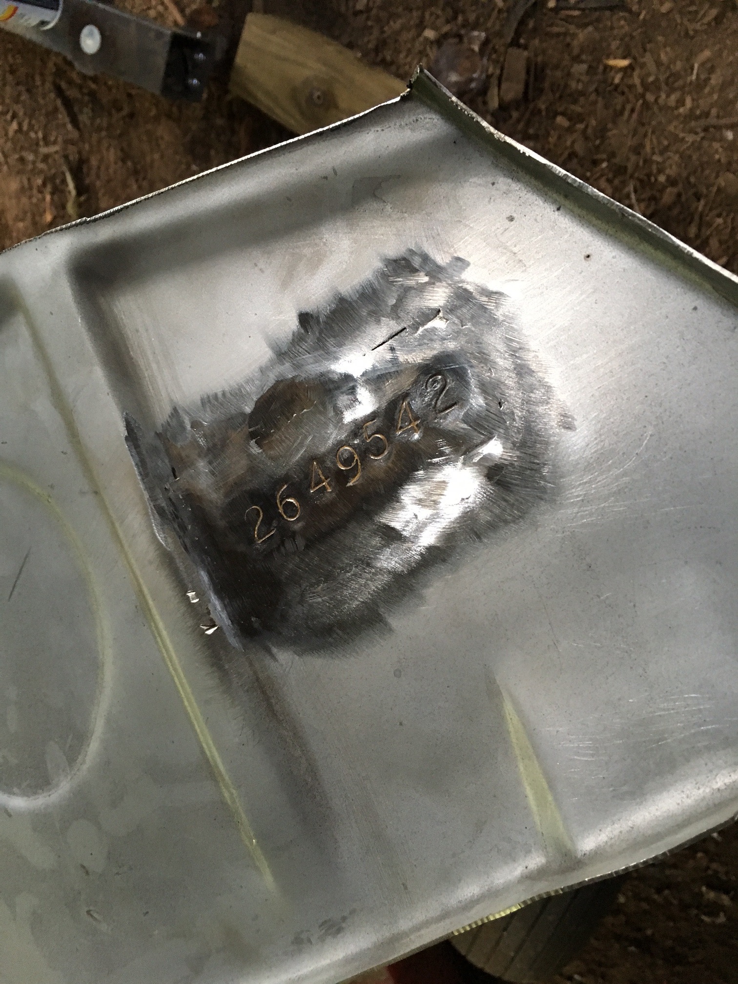

dlee6204   I cut a replacement panel off a parts car and befo...   Jul 19 2016, 06:40 PM

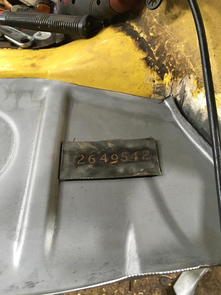

dlee6204   Got the rear panel welded in.   Jul 31 2016, 12:58 PM
dlee6204   Also got the driver's side sail panel, door ja...   Jul 31 2016, 01:01 PM
