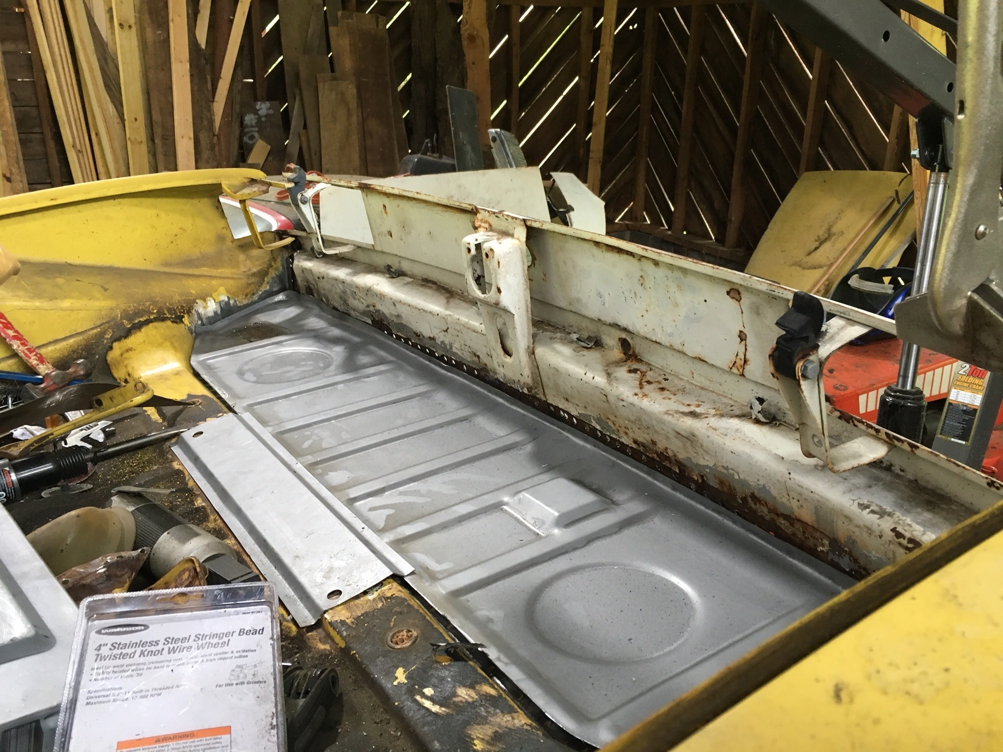

dlee6204   Started on the floorpan. I first had to trim my f...   Jun 26 2016, 02:38 PM
dlee6204   And floor pan is welded in. I still have to do al...   Jun 26 2016, 02:41 PM

dlee6204   Got the interior floorpan complete with crossmembe...   Jul 19 2016, 05:53 PM

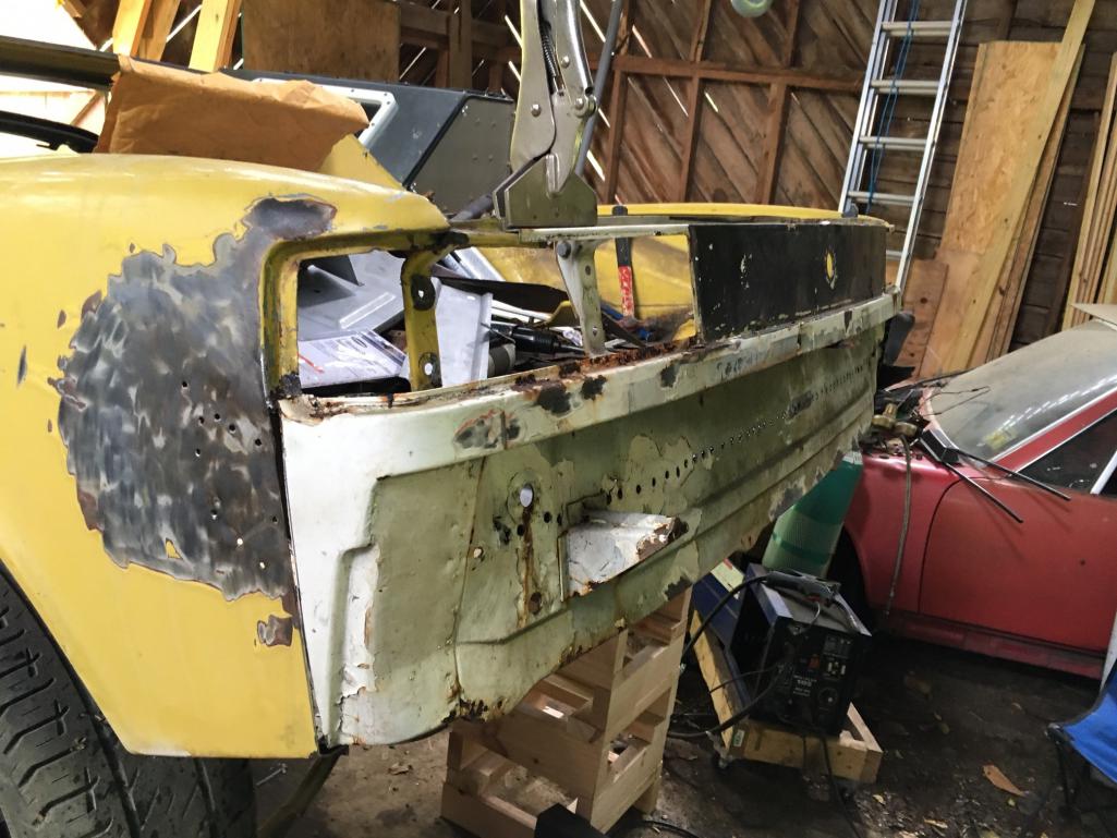

dlee6204   I started digging into the rear trunk area. I dis...   Jul 19 2016, 06:10 PM
dlee6204   Full damage exposed. Luckily the old chassis nu...   Jul 19 2016, 06:16 PM

dlee6204   Got the rear trunk, reinforcement, and heat shield...   Jul 30 2016, 07:38 PM

dlee6204   Got the rear panel welded in.   Jul 31 2016, 12:58 PM
